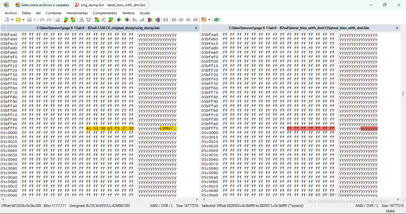

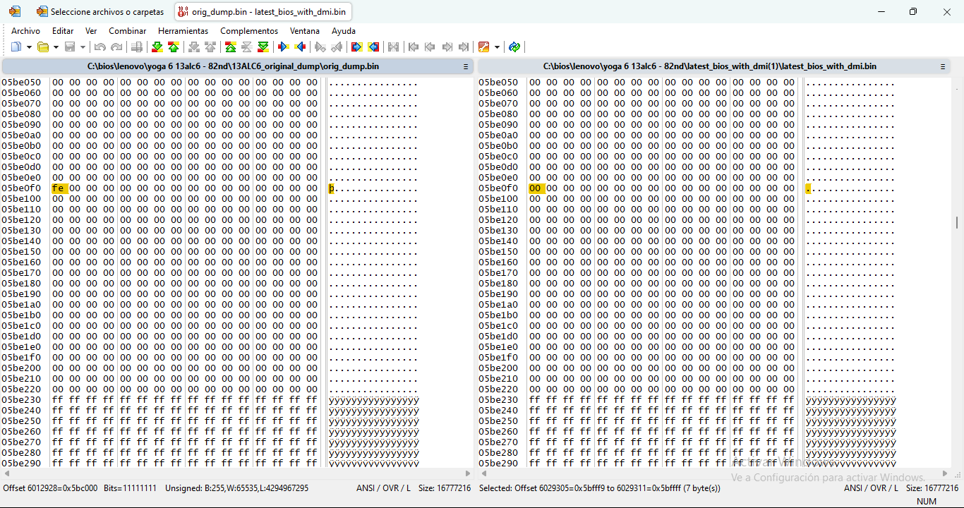

    Try copying the offset ranges as peste suggested
    Found some minor differences comparing your original dump with the latest file you attached, may be important also
    • FZG
      • Sep 2022
      • 118
      Good call, don´t know how I missed that. However, this doesn´t change much.
      I took off the main bios chip again and dumped its content before attempting another flash with the complete DMI block. When I checked the freshly made dump I noticed the file contents had changed compared to what I had put on there:
      All DMI data that had been added prior was erased from the file and new content has been written (050FE0-057650). I can only imagine some contents of the bios are automatically rewritten at first startup. Maybe some security feature?
      So I took the dumped file which now contained this additional data starting at 050FE0 and added the whole DMI block again (5BC000 - 5BFFFF). But I still get INVALID when in bios setup, so I assume the DMI block has been automatically erased again. But one thing has changed: There is now an item in bios setup called "AMD platform security processor" which can be enabled or disabled. In my earlier attempts this item was always greyed out and only said "MFG mode".
      Attached is the dumped bios. You can see DMI block is almost completely blanked, new data appeared at 050FE0 onwards.

          Win key: EAA000h-EAA03Fh
          Make a dump of your current BIOS and add it back
          There must be a checksum somewhere for the serial/MTM/model
          Also compare the contents of 5BC000-5BFFFF
