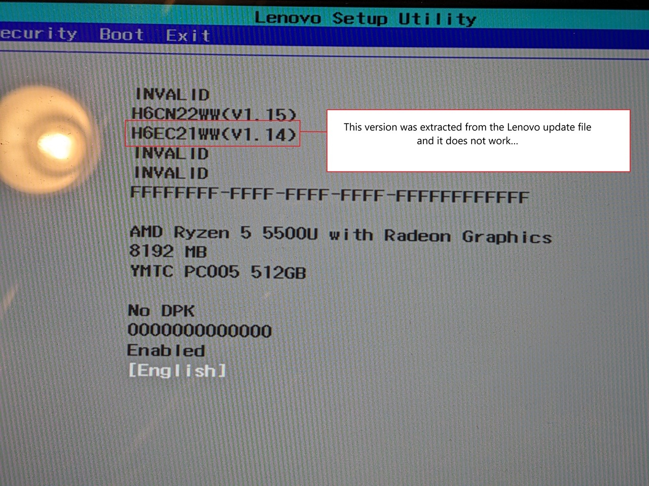

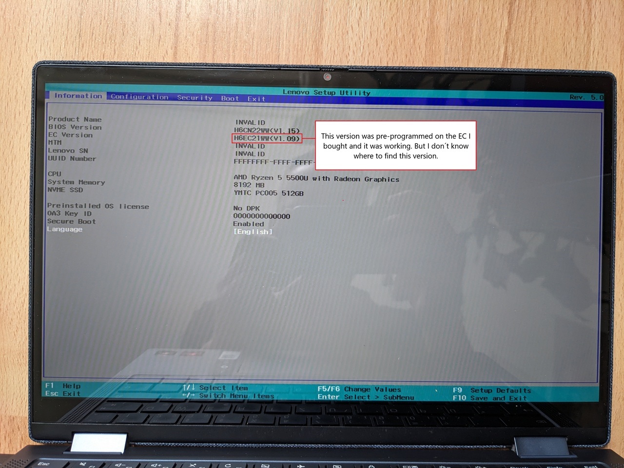

              Let me first say, you were absolutely right, it is indeed a problem with the EC firmware.
              I bought a pre-programmed new EC chip and installed it and the keyboard started working again. Great, but then I managed to screw it up again: I saw that the EC firmware on the new chip was not on the latest version and also mismatched the bios version, so I updated bios and EC via the Lenovo installer. And guess what happened, I am back to where I was before. Keyboard does not work anymore except in bios setup.
              Then I did some research and found out that it is possible to flash ENE chips (KB90xx series) with a CH341A programmer. Not the best way, but possible. So I wired everything up and re-programmed the EC with the firmware you provided (GLC3B115_EC.rar). Unfortunately, this gives the same result. No keyboard functionality when in OS.
              Now here is where it gets really strange: the working firmware that was pre-programmed on the EC I bought was reported in bios as "H6EC21WW(V1.09)". But it seems like this belongs to a different machine, even though it worked fine. When I extract and flash the EC firmware from the corresponding bios update for my machine (H6CN21WW) it gets reported as "H6EC21WW(V1.14)". I don´t understand where this V1.09 (working) is coming from and the seller of the EC chip does not want to tell me.
              Something is wrong here and I am even more confused than before... Maybe you have an idea?

                      Well yes, I flashed this several times and it is the main bios version I am running now. But the problem is with the EC firmware.

                          @m1ch43lzm Thanks for your effort! I tried all previous versions down to H6CN18WW already, the effect is the same with all of them.
                          But I was able to get it fixed in the meantime by trying something else. I found out there is a similar laptop using the LA-K211P board and that is the Yoga 6-13ARE05. Looking up bios updates for this model I saw that the latest version is FFCN21WW and the update notes mention renaming the EC firmware to V109A. This seemed close enough to what was pre-programmed on the EC-chip I had bought, so I extracted the EC firmware belonging to the 13ARE05 and flashed it. And it is working! Bios setup is again reporting EC-version as "H6EC21WW(V1.09)".
                          Now what remains is the question why this is working and the actual update for the 13ALC6 is not. I can only imagine two possibilities: Either the previous owner had the board swapped at some point and the board is actually from a 13ARE05. The other possibility is Lenovo is hosting the wrong update files on their website. If you use the Lenovo update file for the 13ALC6 it actually says this is built for C640-13ALC. I don´t know if this is just another naming convention for the same laptop or if it is actually for a slightly different model.

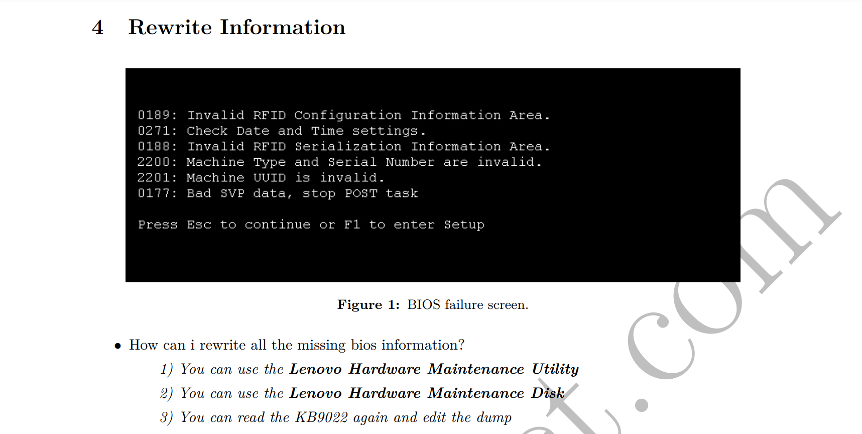

                            I still need to get the S/N, MTM and UUID programmed back into the machine (currently just says INVALID in bios setup). I guess I need to use the Lenovo maintenance utility for this, correct?

                              The 13ARE05 has a Renoir CPU (Ryzen 4000 series), 13ALC6 has Lucienne CPU (Ryzen 5000 series), the main BIOS is incompatible even if the board number is exactly the same
                              May be a screw up by Lenovo with the wrong EC firmware for the 13ALC6

                                Regarding serial numbers and stuff, I re-flashed the main bios containing all the correct DMI data but in bios setup I still get "INVALID" for product name, MTM and S/N. I read that this might be resolved by using a tool called "Lenovo maintenance utility". I already found a version of this tool and created a bootable USB stick but I never used the tool before and I need to find out how it is supposed to work.

                                  the bios from post # 10,12...is virgin, use the HxD program (it's free on the internet), enter both bios into the program (your laptop and the virgin one),
                                  select that interval mentioned in both bios, copy the interval in your bios and pass it to the virgin bios (copy - paste)....and that's it...
                                  • FZG
                                    • Sep 2022
                                    • 118
                                    That´s how I did it and how it usually works. But I still get INVALID in bios setup screen. Is some of the DMI supposed to go into the EC firmware as well? I read a document from SVOD project regarding programming of the KB9022, where they mention the "maintenance utility" or editing the EC dump as a solution...

                                      try this..
                                      5BC000 - 5BFFFF
                                      • FZG
                                        • Sep 2022
                                        • 118
                                        This is what I flashed onto the main bios chip. DMI will not show up in bios setup screen.
