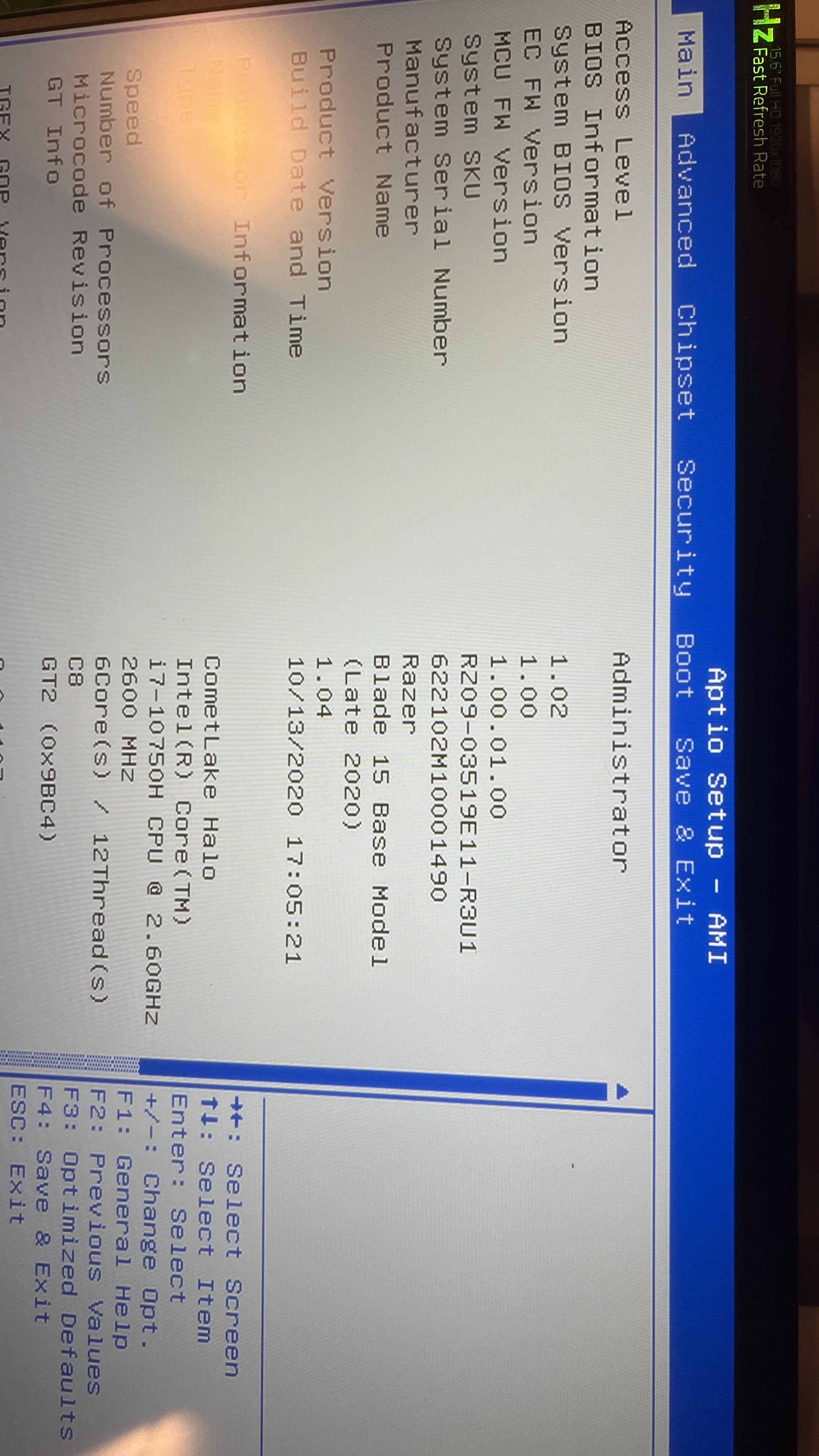

              Works, but I think the EC Firmware is bad.
              I get version 1.02 for bios and EC is 1.0
              Do you have a EC Firmware?

                Here's system info

                  Originally posted by Awdev
                  Here's system info
                  I don't have it and there is no bios for this model on the Raze website.
