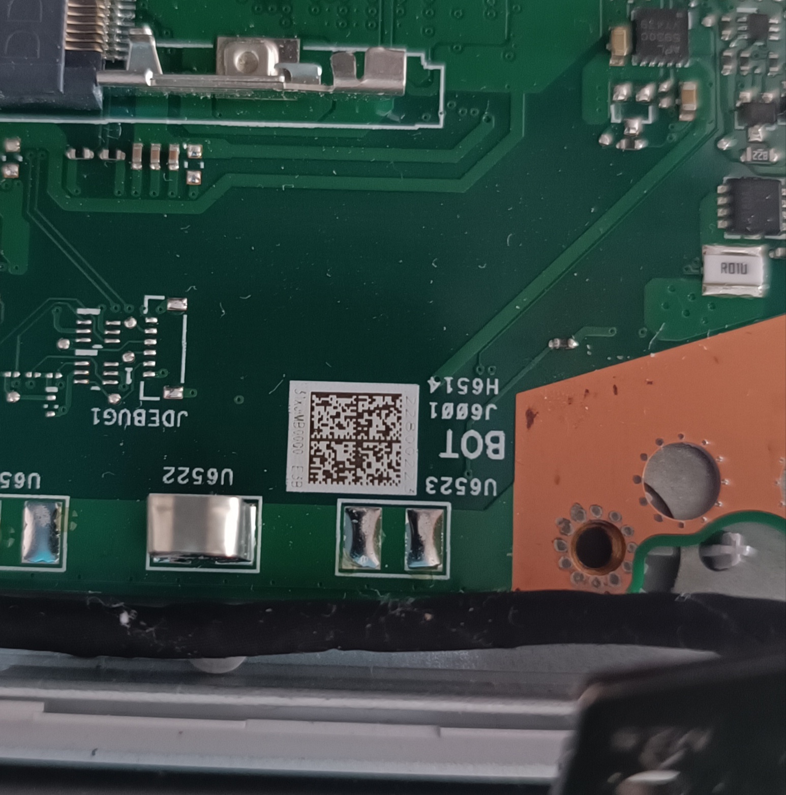

    Hi guys, I need the bios fix for the model as in title. The laptop shows blinking battery led, the battery doesn't charge at all and the voltages are all present. I post here the dump of the bios ic, read using a TL866.

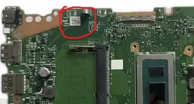

    Post a picture of the QR code on the motherboard

      There it is.

          The serial number from the QR code is different to the one you posted. N728NBCX007P63MB .Do you want a bios with the current SN or the one from the QR
          QR
          N728NBCX007P63MB
          QCCXJI0QB22800223
          X1603ZA
          60NB0WB0-MB2030 212​

            The serial number i've written in the first post is on a QR code on a sticker in the back cover. The QR code I last posted is on the motherboard, so I guess this one is the correct one, am I right? I don't really know why they do not match, maybe this is not the original motherboard for this chassis, I don't know. But imho I need to go with the motherboard SN.
