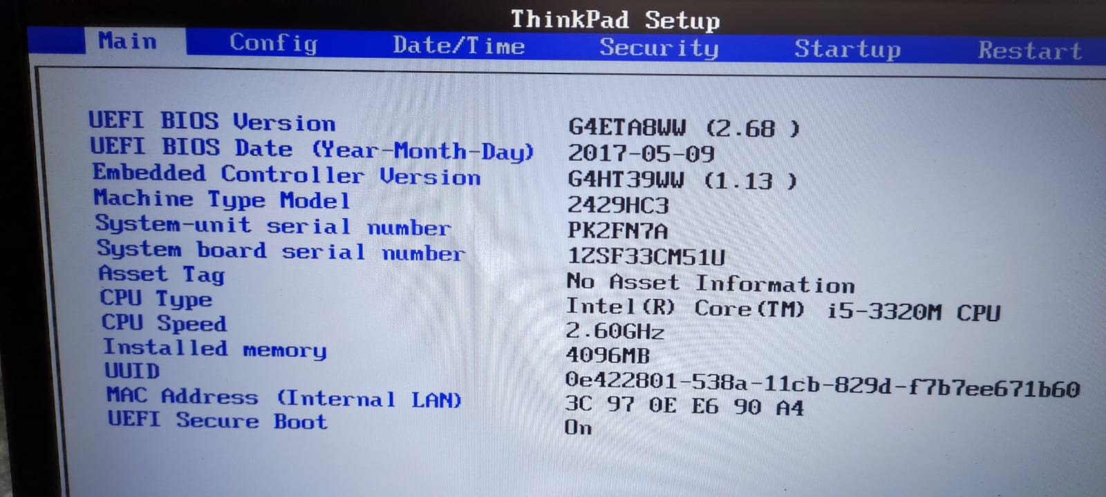

                                BIOS PASSWORD Lenovo ThinkPad T530
                                Any solution to remove bios password
                                LENOVO MACHINE TYPE MODEL 2429HC3
                                • OKRPKCOMP
                                  • Dec 2020
                                  • 439
                                  • PAKISTAN
                                  Re: BIOS PASSWORD Lenovo ThinkPad T530
                                  SOLVED, Just short u22 ic 5+6 pins together after turning on and before display, press f1 and when setup opnen un-short pins,. In setup change or remove password
