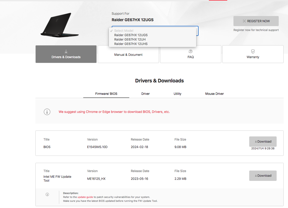

        bios file is on their website, you just have to chose your model, download and unpack. Change extension from .10D to .bin and voila!

          Thats awesome. I will give it a try. Im sure I can install it on the chip. Installing the chip on the motherboard. Ehhhhhhhh? Checking for schematics now given that the pads were destroyed by a hastey engineer...ME
