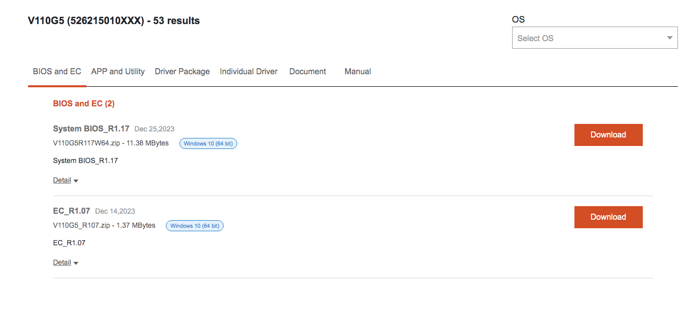

Getac V110 G5 Bios dump needed
  • volinakis
    replied
    Originally posted by GrafZahl
    I don´t have proper Backup. If you want I can post disfunct backup as well, but I don´t see the point.
    "the point" is that having even broken backup I can see what ME firmware I have to use in order to build bios image, version of bios and DMI, also if ME_Region is faulty and so on.
    Leave a comment:
  • GrafZahl
    replied
    post your backups, as in RULES. You can find bios and EC on web page of Getac.
    I don´t have proper Backup. If you want I can post disfunct backup as well, but I don´t see the point.
    Leave a comment:
  • volinakis
    replied
    Originally posted by GrafZahl
    Thank you very much. Do you have by any chance a dump of the EC as well?
    The file does not work for me as is yet, but EC is shown as corrupted, so maybe it is that.
    post your backups, as in RULES. You can find bios and EC on web page of Getac.
    Leave a comment:
  • GrafZahl
    replied
    try. you have to transfer DMI since you didn't provide your bios backup
    Thank you very much. Do you have by any chance a dump of the EC as well?
    The file does not work for me as is yet, but EC is shown as corrupted, so maybe it is that.
    Leave a comment:
  • volinakis
    replied
    Originally posted by GrafZahl
    I guess rules are rules.
    RL503V2716
    try. you have to transfer DMI since you didn't provide your bios backup
    Leave a comment:
    replied
    Originally posted by GrafZahl
    I guess rules are rules.
    RL503V2716
    If you have a backup post it, even if its the Bosch version.
    Leave a comment:
  • GrafZahl
    replied
    Originally posted by SMDFlea
    I guess rules are rules.
    RL503V2716
    Leave a comment:
    replied
    Post the S/N https://www.badcaps.net/forum/troubl...before-posting
    Leave a comment:
  • GrafZahl
    started a topic Getac V110 G5 Bios dump needed
    Getac V110 G5 Bios dump needed
    Hi!
    I am in desperate need for a Bios dump from an Getac V110 G5.
    It needs to be from a stock V110 G5, not a Bosch DCU220 (that also is labeld V110 on the bottom).
    If it is password locked, that is no problem.
    Thank you in advance!
  • DynaxSC
    MSI PRO B660M-G DDR4 - real bios dump from board needed (no stock bios)
    by DynaxSC
    Hi, I have an MSI PRO B660M-G DDR4 board with damaged BIOS and i need a bios dump from a real board, along with MAC, UUID and Serial Number info (eg. a BIOS screenshot and pictures from the board stickers).
    I need to reconstruct the bios on my board, based on another bios image form a real board - meaning a bios image containing MAC address, UUID and Serial number. A stock BIOS is not suffiecient, as it is impossible to discover where the MAC, UUID and SerialNumber are stored. Tried with a similar board, but there are too much differences, and the stock BIOS is missing a lot of...
    11-17-2023, 10:56 AM
  • TacticalFahrrad
    [REQUEST] Fujitsu Lifebook E5513 – Full BIOS Dump Needed (.bin)
    by TacticalFahrrad
    Hi everyone,
    I'm trying to recover a Fujitsu Lifebook E5513 (most likely 2023 model) that was bricked during a BIOS update. The update was interrupted (probably due to power loss), and now the laptop is stuck in a boot loop showing "PBB rollback" / "SBB rollback" messages.
    BIOS access (F2) and Boot Menu (F12) are no longer possible – the system instantly reboots after the rollback messages.
    I extracted the official BIOS update package from Fujitsu (contains FJNB2FD.CAP, ~18.7 MB) and tried tools like UEFIExtract, but it seems to only contain...
    06-30-2025, 04:09 AM
  • vinaypundith
    Razer RZ09-01682 Blade Stealth 13 2016 BIOS dump needed
    by vinaypundith
    I have this laptop that does boot but it's on an older BIOS that has issues with Secure Boot, and I cannot use the normal Razer BIOS updater because for some reason the serial number is missing / got deleted somehow (Common issue on this model, from what I've read). I got a dump of the BIOS chip (or at least what I think is the BIOS chip), and its 16MB in size - the files from the Razer BIOS update are 8MB. (There's two 8MB files, am I supposed to combine these somehow? Or combine with an Intel ME firmware? I have no idea).
    So, I'm looking for a BIOS dump for this machine - a 16MB one....
    08-03-2024, 12:32 PM
  • James Maxwell
    HP DM1-4000er Bios Dump needed
    by James Maxwell
    I badly need bios dump for HP DM1-4000er,
    Model: HP DM1-4000er
    Motherboard: DA0NM9MB6D0 REV.D
    Product: QJ490EA#ACB
    Please help. My bios chip burned so I don't have the old bios anymore. I need bios dump before I can install the replacement.
    10-28-2024, 05:38 PM
  • Habble7
    by Habble7
    Suspected Cause:
    Troubleshooting Attempts:
    05-22-2025, 07:28 AM
