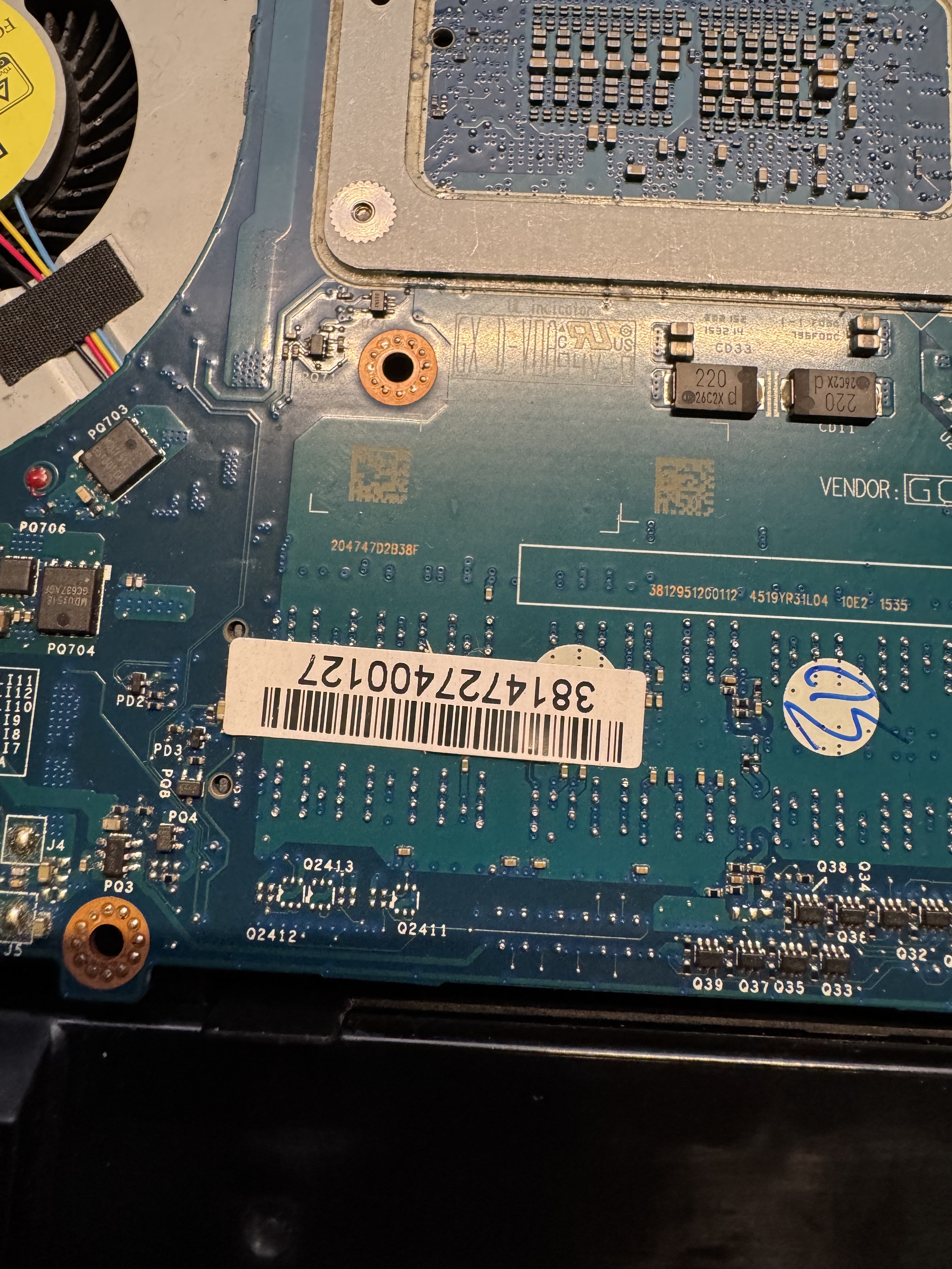

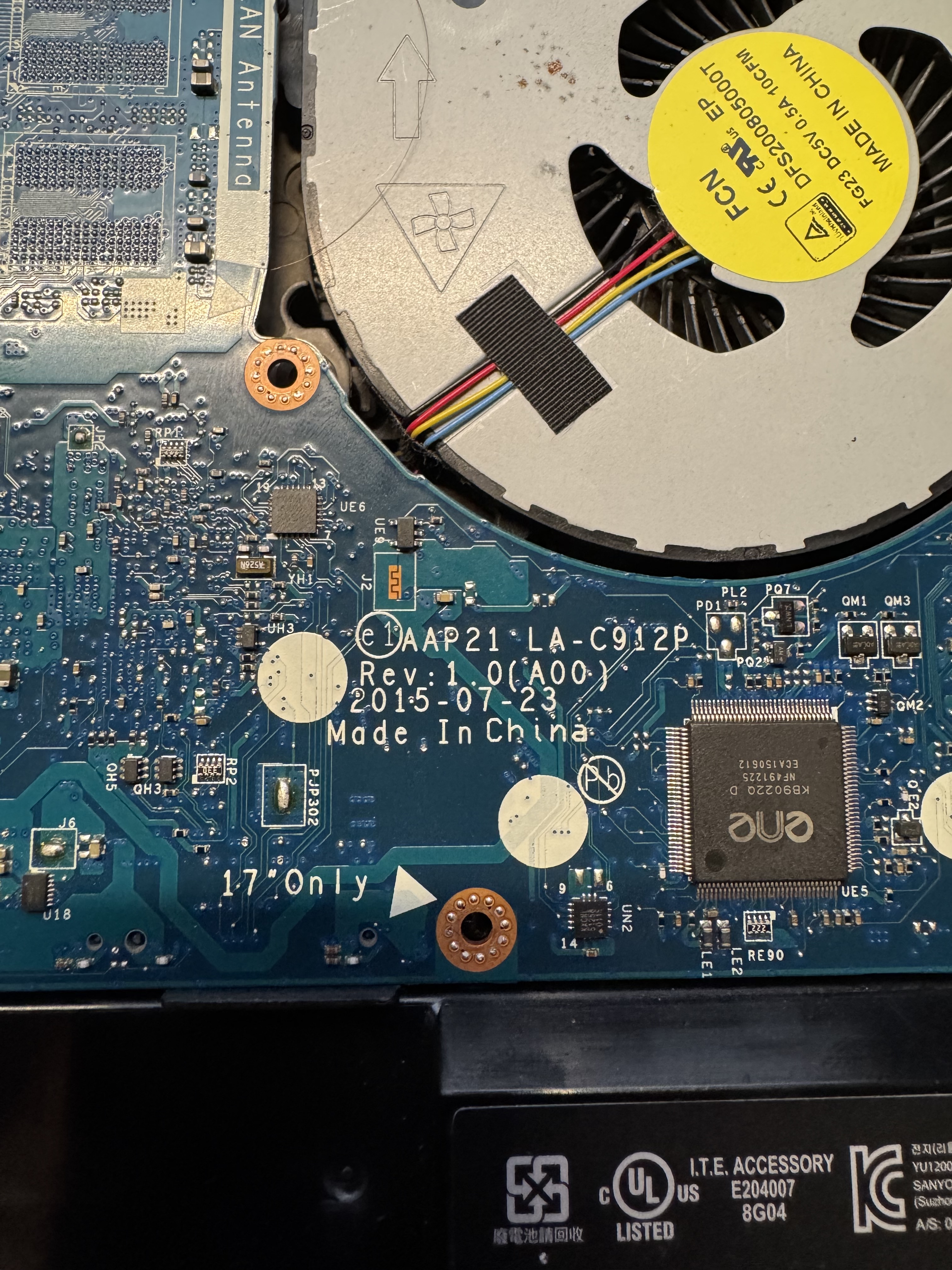

    Hello all! I'm new here but looking to get help with my Dell Alienware 15 R2. I have dumped the bios and have already tried another bios online and it worked but i would like to have all my info in the new bios but i also don't know my service tag as it was worn off the bottom so I'm hoping someone could help get it from the old bios image and get me a working image for my machine that has all the correct info!
    I have provided my original corrupted bios and the bios i used to get the machine working.
    Thank you!

    provide serial number and motherboard model

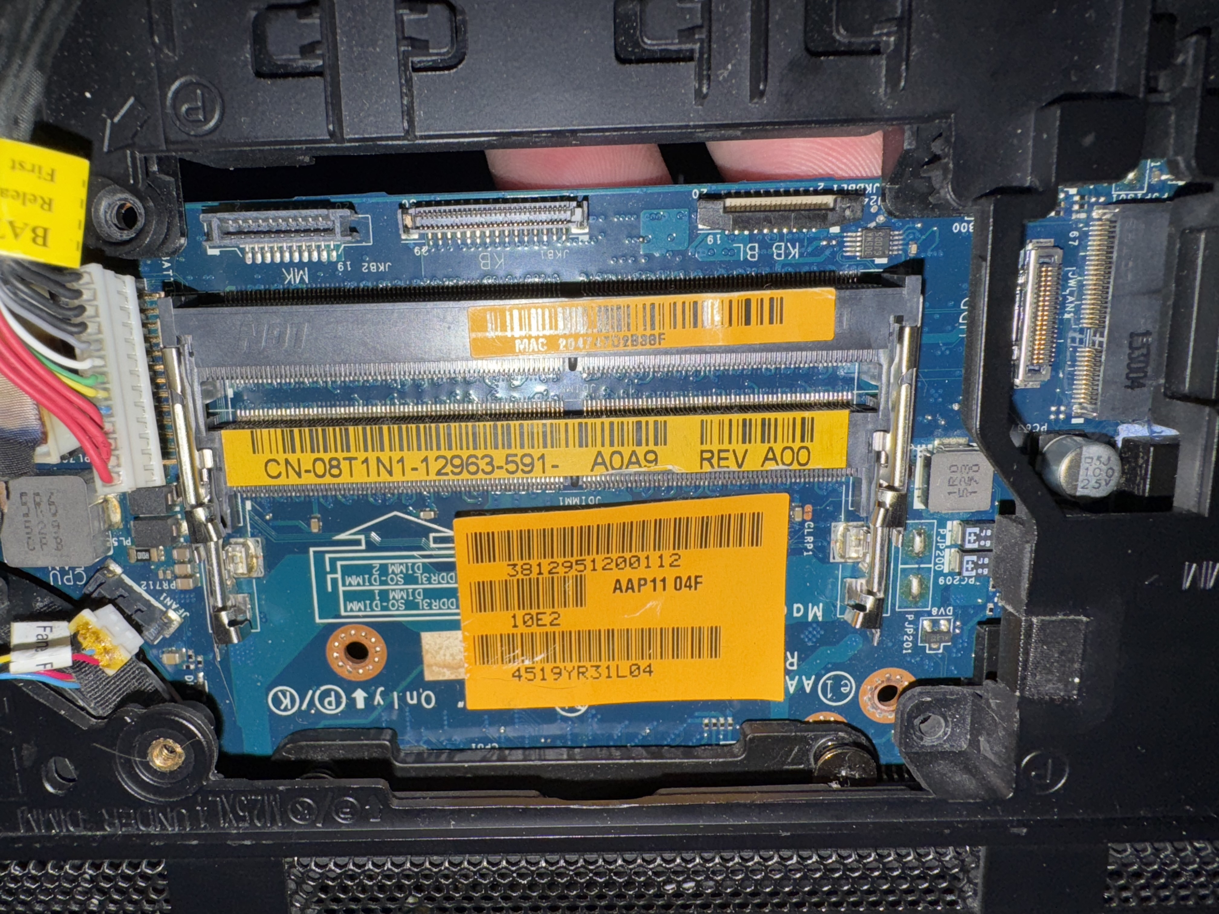

      Not sure exactly what ones it’s is but here’s all the markings on it.

        Service tag is on the back cover , also its a AAP 21 LA-C912P Rev: 1.0(A00) 2015-07-23 it should be type not photo, nextime

          sorry about that. And the service tag label is not readable on the back cover unfortunately.

            Alienware 15 R2
            Service Tag: 65HTG72
            Express Service Code: 13392952382

              try this tow type of bin one is fresh but not clean the one is fresh and clean image

                I flashed the new.bin and it looks like it’s booting up correctly with the service tag you found. Thank you so much! Is there anything else that needs to be done to it? Also a way to tip you if that’s allowed.
