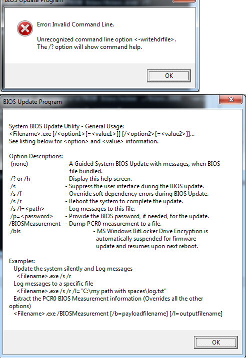

    I have a Dell T7820 stuck in Bios recovery mode. I never get Dell Boot screen or anything visible on screen. The system just gives me 3 white lights and 3 orange lights indicating Bios recovery mode.
    What I have tried to get to recover the Bios, there seems to be some conflicting advice about recovering the system.
    All of them say to download the latest bios from the dell website which is a .exe file. I have done that
    https://www.dell.com/support/product...BUT090/drivers
    Some say to go to command prompt, find the location of the file and run filename.exe /writehdrfile
    Whenever I do this I get an error, picture attached pressing /? show the commands available.
    Other have said rename the .exe file BIOS_IMG.rcv and copy onto USB drive that has been formatted in FAT32 mode.
    I am holding down CTRL+ESC, then inserting power, letting go when the keyboard turns on, however I get nothing, just the same. 3 white, 3 orange. Never a screen.
    I am doing something wrong, to I need to get this elusive hdr file? do I need a wired PS/2 keybard?

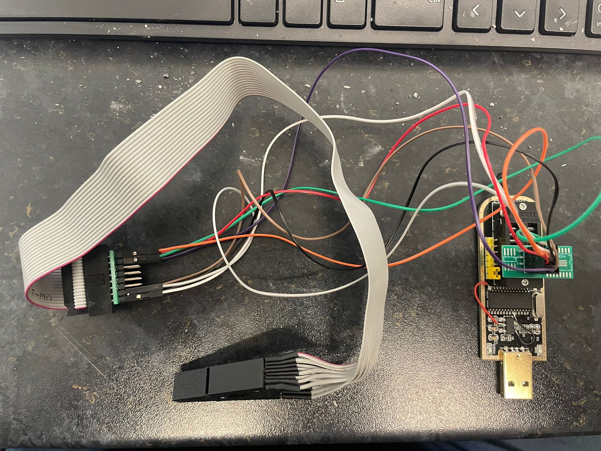

    ✅ Dell T7820 BIOS Recovery Summary
    (W25Q256JVFQ, CH341A Programmer, No .HDR Available)
    If your Dell Precision T7820 is bricked due to a BIOS update failure (no POST, black screen, fan spin only), here’s what actually works — since no forums gave a full working answer when I searched.
    ❌ .HDR File Not Present — USB Recovery Won’t Work
    Dell BIOS .exe files sometimes contain a hidden .hdr file used for recovery via USB, but:
    🔍 The T7820 BIOS file does not include an .hdr or .cap, even after extraction with tools like 7-Zip, BIOSUtilities, or UEFITool.
    This means:
    • USB BIOS recovery won’t work
    • BIOS Recovery Mode (blinking amber/white power LED) is not enough to restore it
    • You must flash the BIOS chip manually
    ✅ The Only Working Fix: Manual Flash via CH341A Programmer
    🧠 What You’ll Need:
    1. CH341A programmer
      • ⚠️ Default "black/gold" models output 5V data lines, which can damage 3.3V flash chips.
      • ✅ Recommended: Use a CH341A v1.7, which supports 1.8V / 2.5V / 3.3V / 5V logic levels natively — no modding required.
    2. 16-pin SOIC clip
      • The BIOS chip is in a 16-pin WSON/SOP package — not an 8-pin SOIC.
    3. Proper wiring (see below)
    4. Software: NeoProgrammer (or ASProgrammer)
    5. A known-good .bin BIOS file (32MB, dumped or sourced)
    📌 BIOS Chip Information
    • Model: Winbond W25Q256JVFQ
    • Capacity: 256 Mbit (32MB)
    • Voltage: 2.7V – 3.6V → requires 3.3V
    • Package: SOP-16 (Wide SOIC / WSON-16 format)
    • Protocol: SPI NOR Flash
    📸 Correct Pinout (Pin 1 Top-Right, Standard Orientation)
    TOP VIEW (Clip on chip, notch/dot is on top-right → ●)
    _________________________
    | * ● ← Pin 1 (marked on chip)
    | 8 7 6 5 4 3 2 1 | ← Top row of clip
    | 9 10 11 12 13 14 15 16 | ← Bottom row of clip
    |_________________________|
    ✅ Active Pins to Use:
    Pin # Name Use
    1 HOLD# Pull high (to VCC)
    2 VCC 3.3V power
    7 CS# Chip Select
    8 DO MISO (data out)
    9 WP# Pull high (to VCC)
    10 GND Ground
    15 DI MOSI (data in)
    16 CLK Clock
    Only these 8 pins are required. The others are not connected (NC).
    ✅ These are the only 8 active pins. The others are NC (Not Connected).
    ✅ Use a multimeter in continuity mode to test and label each SOIC clip wire before wiring to your CH341A.
    🛠️ Step-by-Step Process
    1. Connect your 16-pin SOIC clip, using only the 8 pins above
    2. Supply 3.3V via CH341A or external adapter (1.8V will not work)
    3. Set the software to chip: W25Q256FV (fallback for JV)
    4. Read the chip and save a full dump (32MB) as a backup
    5. Flash your known-good .bin BIOS file
    6. Disconnect, reassemble, and power on — you should see POST
    🧪 Important Lessons Learned
    • Do not use 1.8V — this chip is 3.3V only
    • ❌ An unmodded CH341A can damage the chip due to 5V data lines
    • ✅ CH341A v1.7 is safer — fully supports 1.8V, 2.5V, 3.3V, and 5V
    • ❌ .HDR extraction tools will not help — it’s not present in the Dell BIOS file
    • ✅ A 16-pin SOIC clip is required — not 8-pin
    • ✅ Only 8 of the 16 pins on the BIOS chip are used — wire them correctly!
    🧰 Tools I Used:
    • CH341A programmer (v1.7 — highly recommended)
    • 16-pin SOIC clip (wired manually to 8 pins)
    • NeoProgrammer v2.1
    • 32MB .bin BIOS file (from known-good system or Dell extraction)
    • Multimeter (for voltage and continuity testing)
    If you're stuck with a bricked Dell T7820 and getting no help from forums or Dell, this is the method that actually works. Happy to answer questions or share wiring diagrams — I made every mistake along the way so you don't have to.
    Good luck, and I hope this post saves someone a few days of trial and error. 💻🛠️
