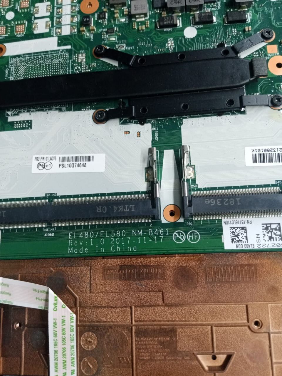

    Hi to all members!
    I need help for removing or extracting BIOS Admin password from this dump.
    ThinkPad L480 Type 20Q6-S88N00
    S/N: PF-26NYRX
    M/B - EL480/580 NM-B461
    Rev: 1.0

      Thank you.
      I'd really appreciate it if maybe someone could help me with this because due to the nature of the job, I can't afford to take the time to study all those password removal procedures. But thank you for the links and I will definitely study all these procedures in the future so that I know how to solve such problems myself.​

        I manage to find time today and solve this problem with" Lenovo Bios Auto Patcher tool"
        Everything went well without any problem and there is no more Supervisor Password.
        Thank you!!!
