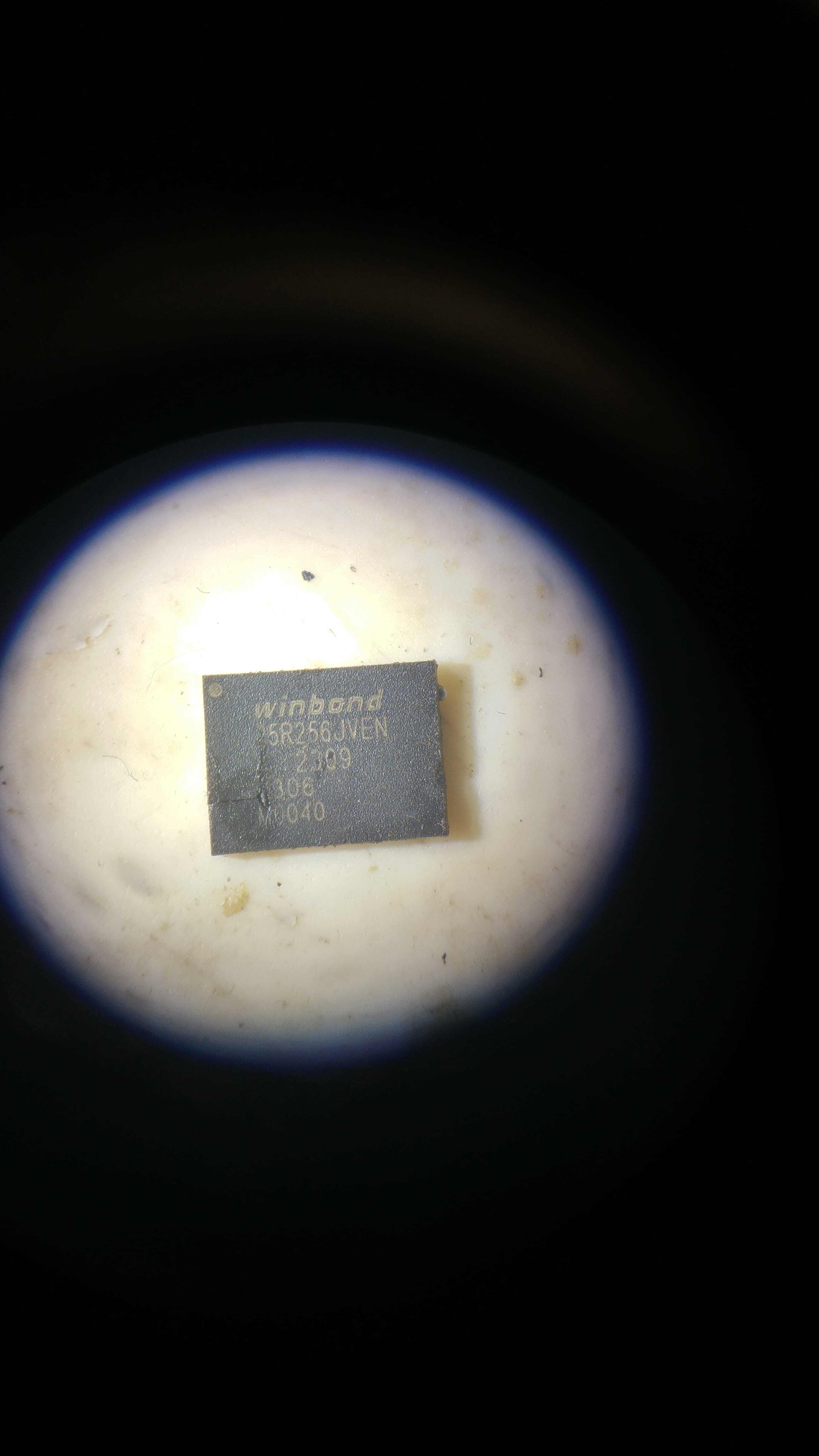

    I'm looking for a BIOS for an Asus B5402CV laptop. Unfortunately, the original BIOS chip (25R256JVEN) has been damaged.
    • 22097
    Originally posted by Roti
    Procesor: SRMJ8
    Hello
    You must post the laptop serial number,its in the rules. The bios chip looks ok physically, are you saying its damaged because your programmer can`t read it

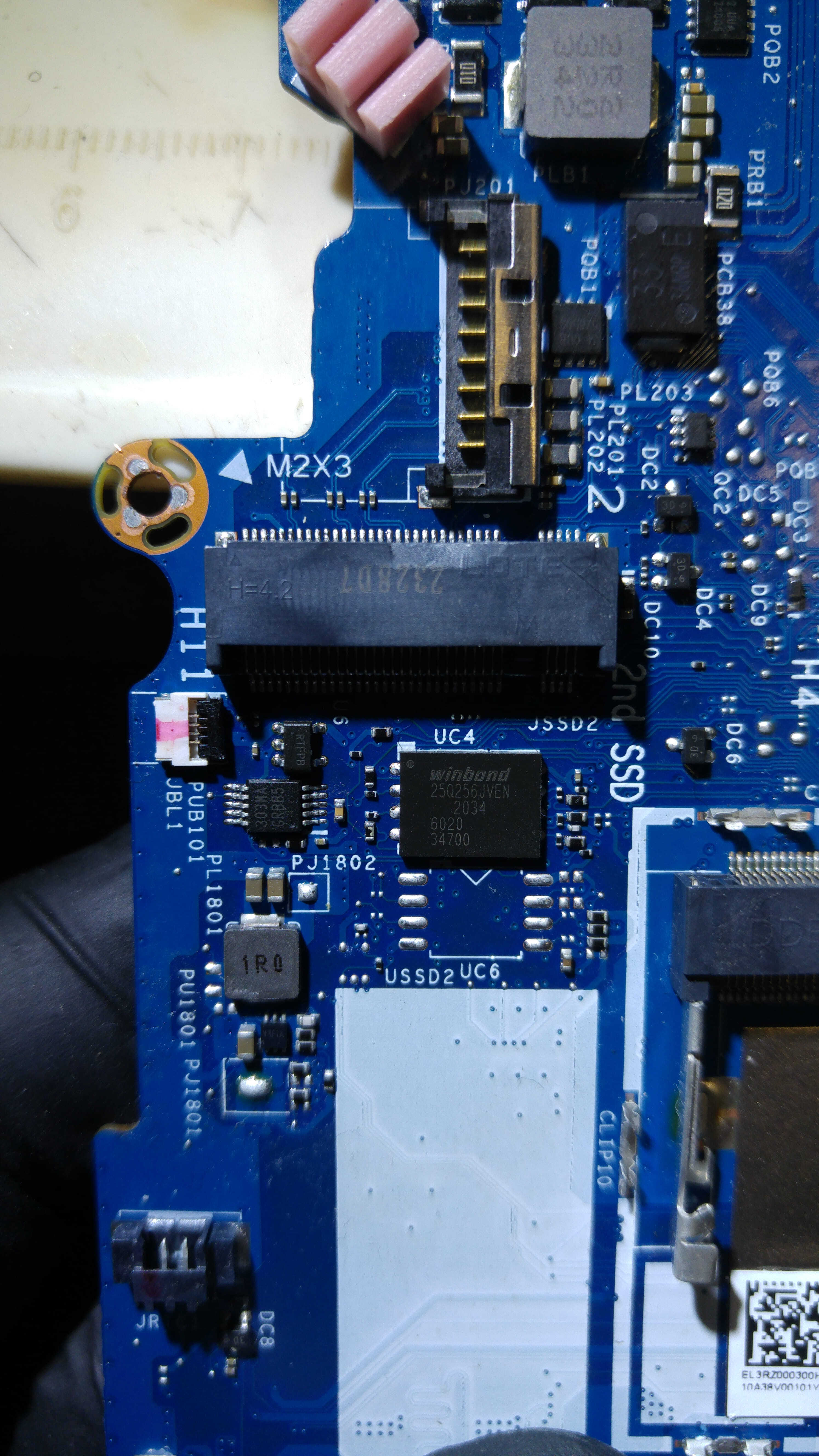

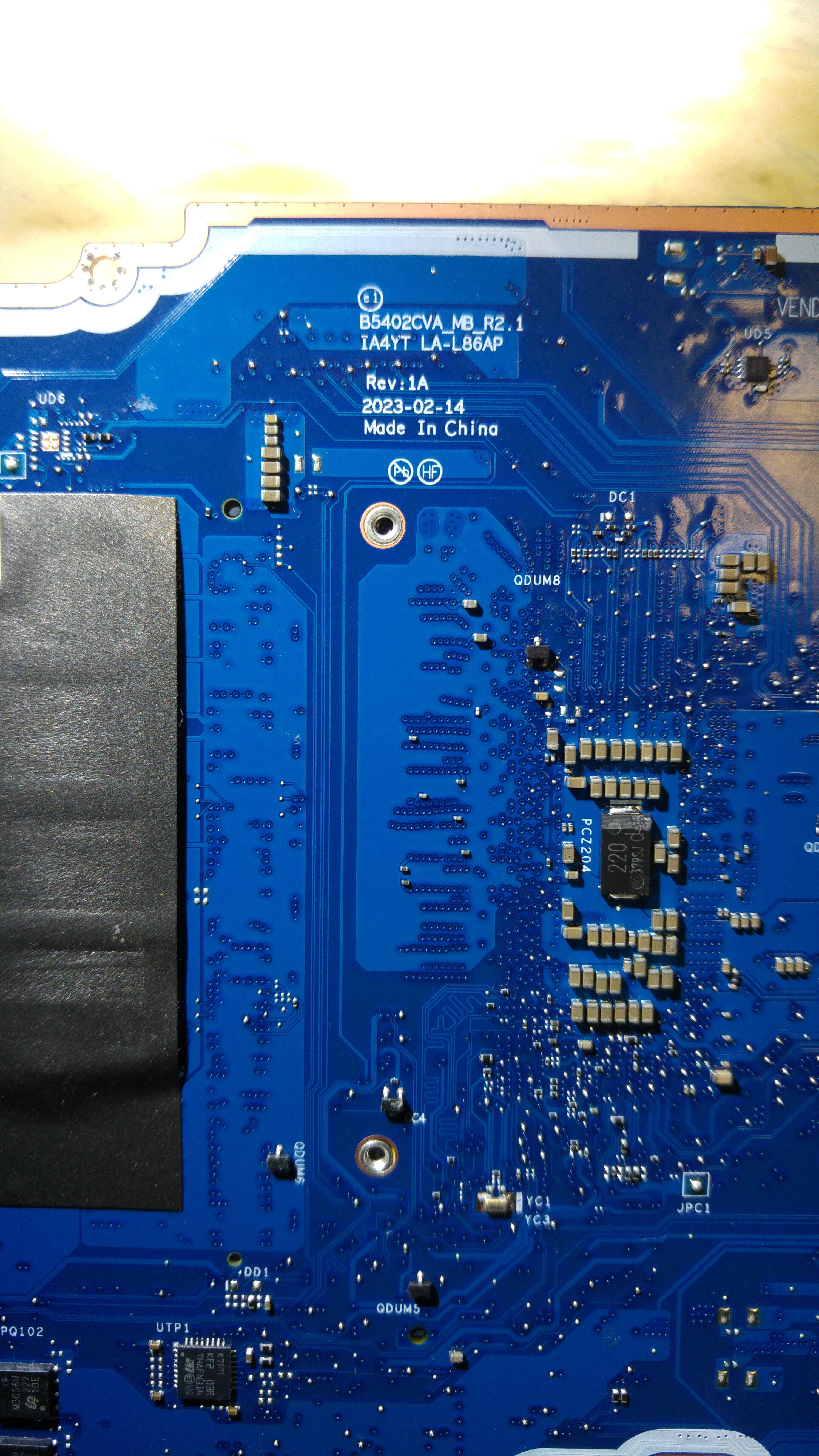

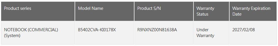

      S/N R9NXNZ00N81638A
      The old one looks like this
      I soldered a new one
      • kalilinux25
        • Mar 2018
        • 2093
        • ZAMBOANGA SIBUGAY
        S/N R9NXNZ00N81638A
        B5402CVA_MB_R2.1
        IA4YT LA-L86AP
        Rev: 1A
        2023-02-14​ I'm having a hard time to help you due you don't have any backup as you said

          The laptop is still under warranty. Can`t find a bios anywhere and only bios updates are available from Asus,not a full bios image.

                  I found out that 25Q256JV is not interchangeable with 25R256JVEN and will not work.
                  This is information from Elvikom
                  I ordered the correct chip on Aliexpress.
                  After pressing the power button, the white diode lights up for about 10 seconds - the current consumption does not increase.
                  KB9052QD (V)
                  +3VLP_EC - 3.3V
                  EC_RST# - 3.3
                  PCH_PWROK - 0
                  PBTN_OUT# - 3.3 (after pressing the power button)
                  EC_RSMRST# - 0
                  SYSON - for a few seconds after pressing the power button 1.5V and immediately drops to 0
                  UC4(25Q256JV) - after pressing the power button n. 1,3,5,7,8 - 3.3V, on the oscilloscope a straight line on all legs​
