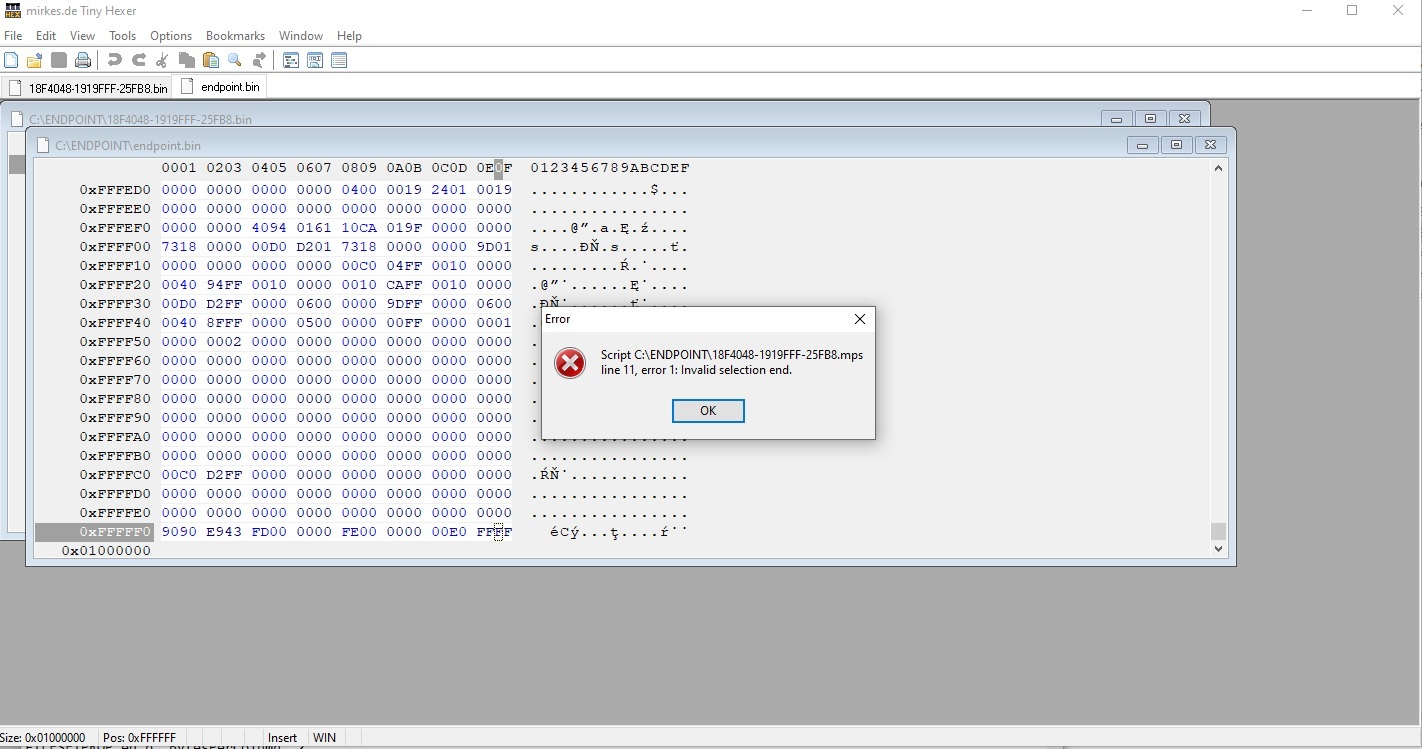

                    Hi!
                    Unfortunately, the script execution ends as shown in the image!
                    TĂ­pus: X360 1030 G4
                    SN: 5CD0189GDS
                    PN: 7Yl45EA#ABH
                      • 22408
                      #30
                      Originally posted by Echoo
                      Hi!
                      It should only be used with the main bios, not the EC_Bios
                      • Echoo
                        • Apr 2018
                        • 93
                        • Budapest
                        #31
                        I see, so with the 256 chip?
                          SMDFlea commented
                          Editing a comment
                          If that is the main bios yes. Some boards have a 32MB and 16MB bios, the 16MB being the EC_Bios and the 32MB the main. Some boards have two 32MB chips, by looking at the code with a hex editor you can tell which is which, sometimes you can find a schematic and you can find which is which from that, and sometimes there will be a silkscreen on the board saying MAIN , EC_BIOS.
