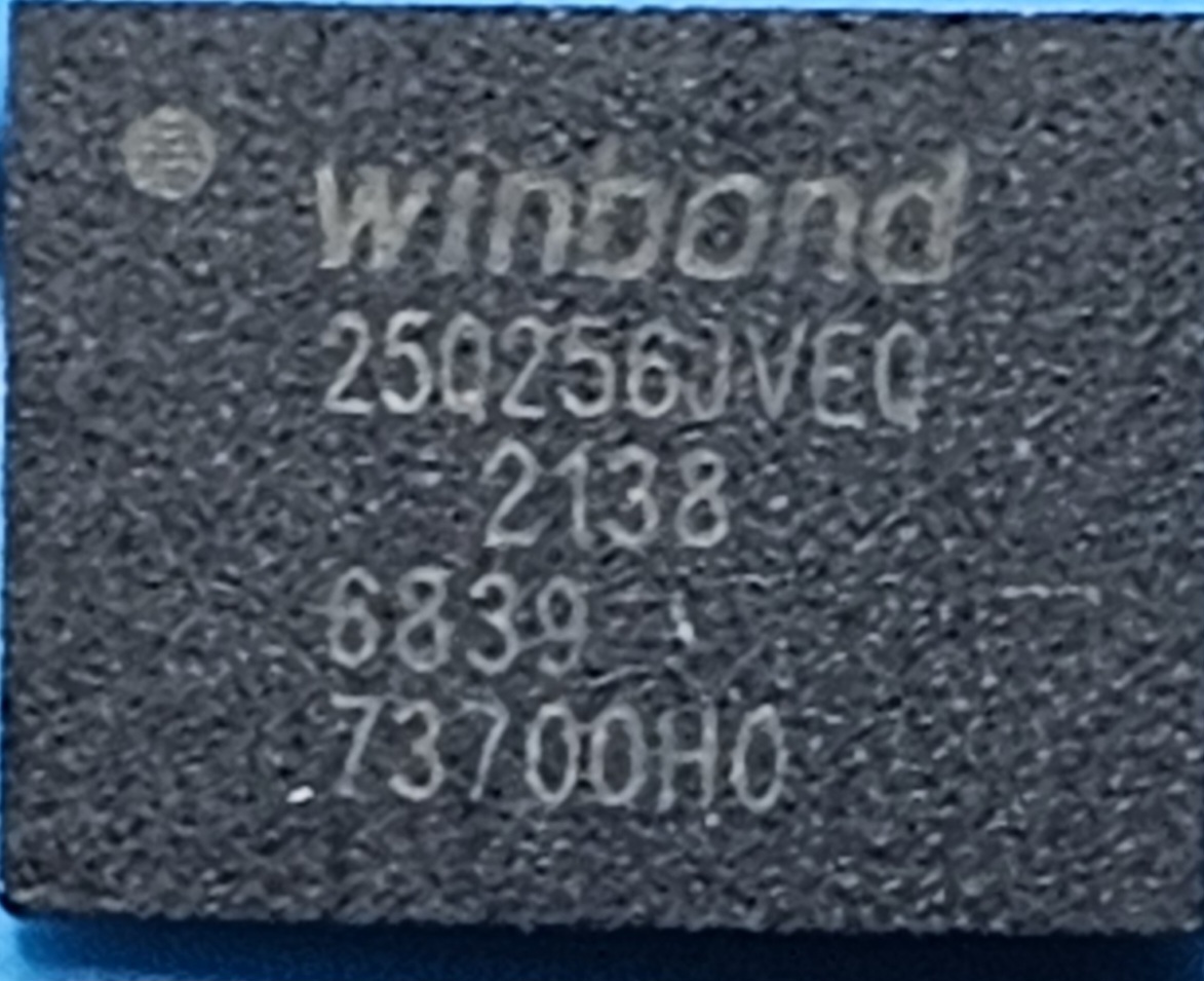

                        • abdmax
                          • Dec 2024
                          • Münster
                          The device had a BIOS password, a previous technician changed the IC and it didn't work, and the device is currently in hibernation. I need a valid flash drive that meets the specifications so I can write to it and revive the device.
                          I have an RT809H programmer.
                          I need the DAMP :
                          Description:
                          HP EliteBook 850 G6
                          Serial Number: 2CG03726HJ
                          Product Number: 4YD61AV
                          Board CT Number: PHWHA00WBD31FC
                          BuildId(BID): 19WWCFCT60#SABD#DABD
                          Feature Byte: 3X476J6S6b7B7H7M7Q7W7m7s8uaBaEapaqauawbUhcAdUdpdqfAPfXhKhKjhk8.De
