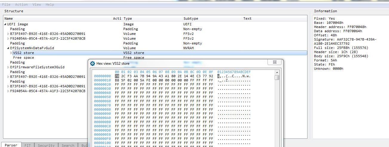

    Hello!
    Which script should I use for 845 G7?

        Originally posted by Echoo
        Hello!
        Elitebook 845 G7
        SN: 5CG1312R7F
        ProdID: 8VZ06AV
        1070048-1095FFF-25FB8.mps at post 1

                    #49
                    635 aero g8, which one to use?
                      • 22408
                      #50
                      Post #1 1070048-1095FFF-25FB8.mps

                        #51
                        just tried, the result is no change, both the .bak and .bin files are exactly the same
                          • 22408
                          #52
                          They are the same, it`s already been cleared .
                          • enigmatech.id
                            • Aug 2021
                            • 5
                            • Indonesia
                            #53
                            Does that mean the method doesn't work for the 635 aero g8?
                              SMDFlea commented
                              Editing a comment
                              No, it just means that the problem is somewhere else.
