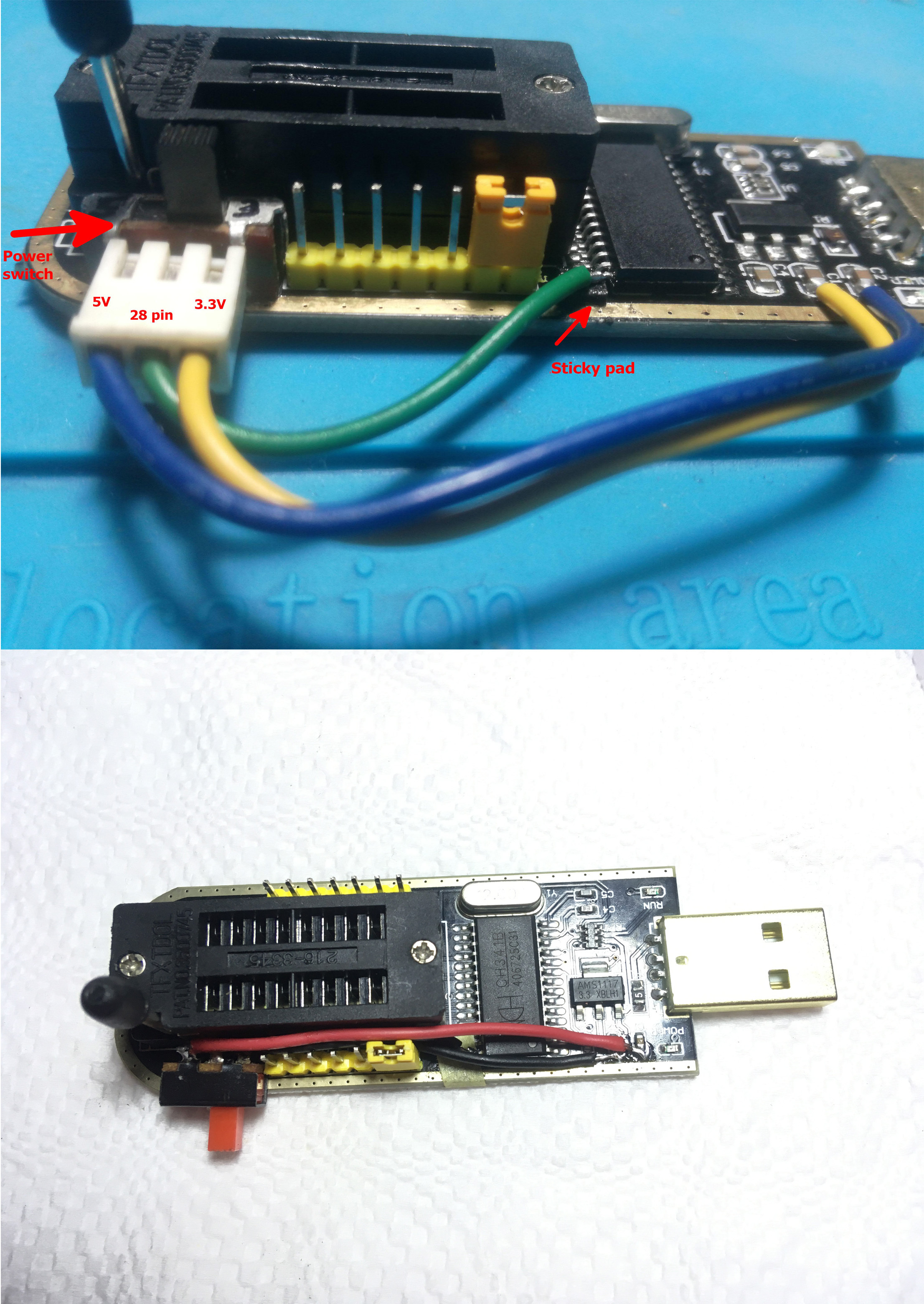

                hi bro's
                im now here with you , i have the same pc can i read the chip with "ch341a programmer" or its not supported
                thanx men for advance

                  Need help to unlock Lenovo 100w Gen 4 bios
                  Hi Badcaps ppl i am new in this business this is my first chip reading use
                  programmer : ch341a programmer modified (pic in atachment )
                  read by : NeoProgrammer V2.2.0.10
                  chip name : Winbond 25Q256JVEN
                  Please i need help to unlock lenovo 100w Gen 4
                  Mfg date : 2023/06/16
                  S/N : PW06G3J1
                  MTM : 82VLS01G00
                  MO : PW90B3617002
                  this is my bios backup

                    try
                    hi bro
                    thank you the password gone but tochpad not working

                      Originally posted by mobile x
                      hi bro
                      and what's the link between system password and touchpad? None to zero? If it doesn't work in windows install Serial IO drivers. Also check settings in bios, maybe you disable it by accident.
                      LE: now i see you had to pull off the motherboard to reach bios chipset, check the flex cable of tpad connector.
                      • mobile x
                        • Jan 2025
                        • 6
                        • The earth
                        it's my fault bro it was the fpc connector thank you legend
