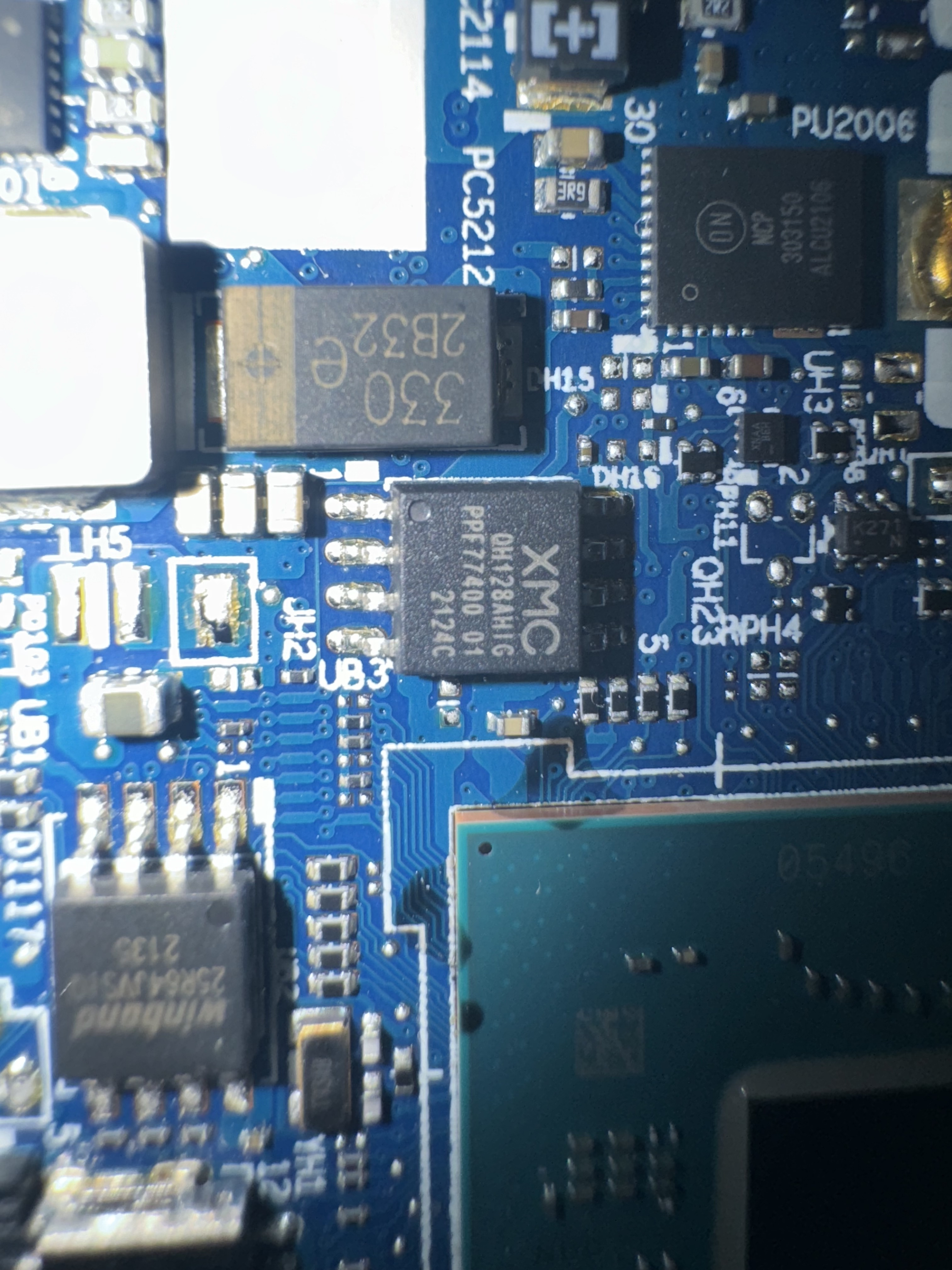

        Backup 16MB chip
        • echothegamer
          • Oct 2023

          Hello Hoaca388,
          Just so I understand, I uploaded a rar back up of the 8mb winbond bios chip in my initial post. Is there another 16 mb chip potentially under the heatsink that I need to make a back up of?
          I was trying not to dissemble since it is still under warranty. I planned to reflash original bios if these methods failed when warranty restarts. I’m very new to this and was only aware of one chip to flash. Clearly this could be more complicated than I was aware.

            This model's bios is divided into 2 parts: 8MB and 16MB. The 16MB file contains your DMI.
            • echothegamer
              • Oct 2023
              • 15
              On second thought and a google search, I have no idea what that person is taking about. That seems like a ship they are referencing not a software lol. So I'm not sure if I need another reader or another software. I believe my drivers are up to date on my CH341A.
              It seems they were suggesting I use the CH341A and manually select the EON EN25Q128 to read the XMC QH128AHIG. I can give this a shot and see if it reads.
              I understand now. I removed the heat sink and found a chip nearby the windbond bios chip. My CH341A programmer could not read it but another thread said to install EON EN25Q12 to read the XMC chip. So I shall try that tomorrow.
              • echothegamer
                • Oct 2023
                • 15
                hoaca388
                I was able to extract the backup for 16mb XMC chip using my CH341A and manually selecting EON EN25Q128.
                I am attaching the 8mb and 16mb backups. Both were acquired w/o desoldering using the clip provided with the CH341A.
                I have heard in some cases these BIOS chips need to be desoldered to read and write properly but I am unsure if this this is the case for my particular laptop.
                Thank you for your help.

                  your 16Mb dump is blank! Use AsProgrammer to read 16Mb chipset.

                    Oh, I’m so sorry! I didn’t even think to verify the dump contents. I will download AsProgrammer and redump.
                    • echothegamer
                      • Oct 2023
                      • 15
                      I have successfully dumped the 16mb XMC chip backup and it is NOT blank this time lol. This one is labeled 2.0
                      Sorry for the delay. Turns out selecting the EON EN25Q128 did allow me to read my XMC with AsProgrammer.

                                    After the reprogram, it posted!!! Thank you all so much for the help. It is greatly appreciated
