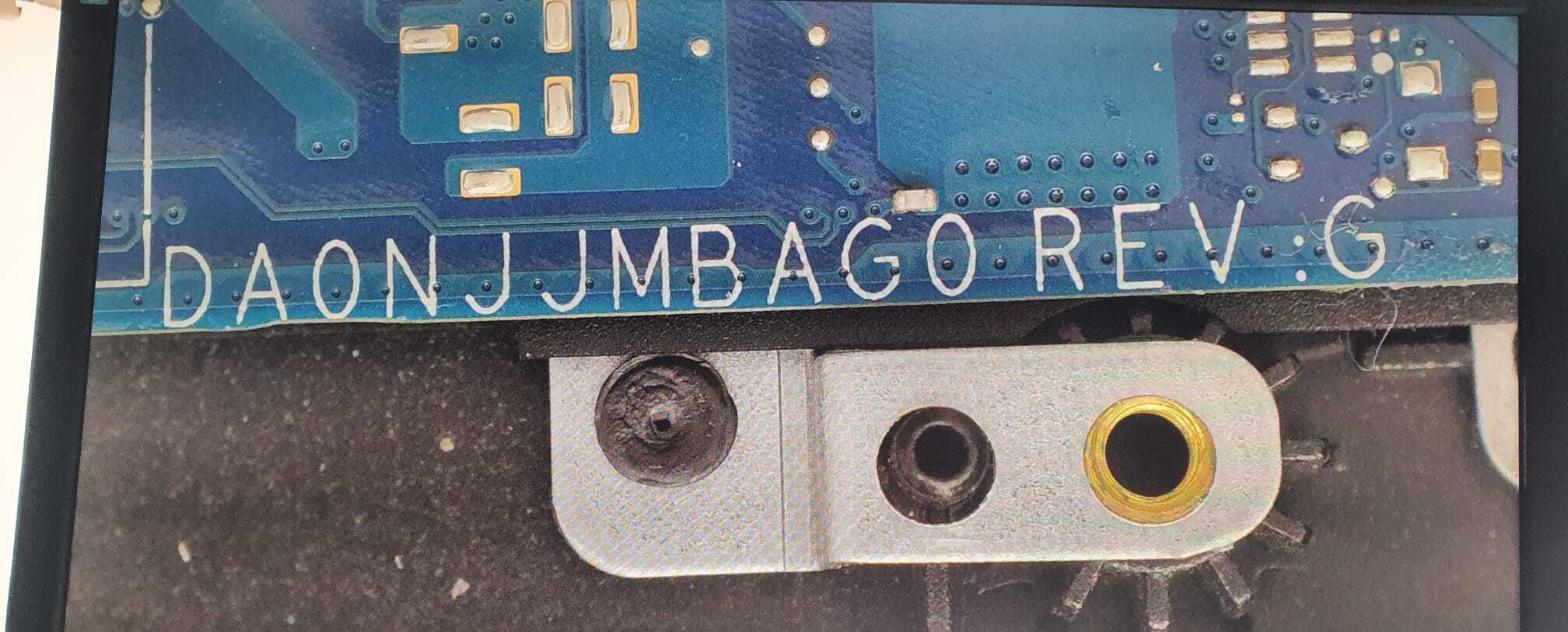

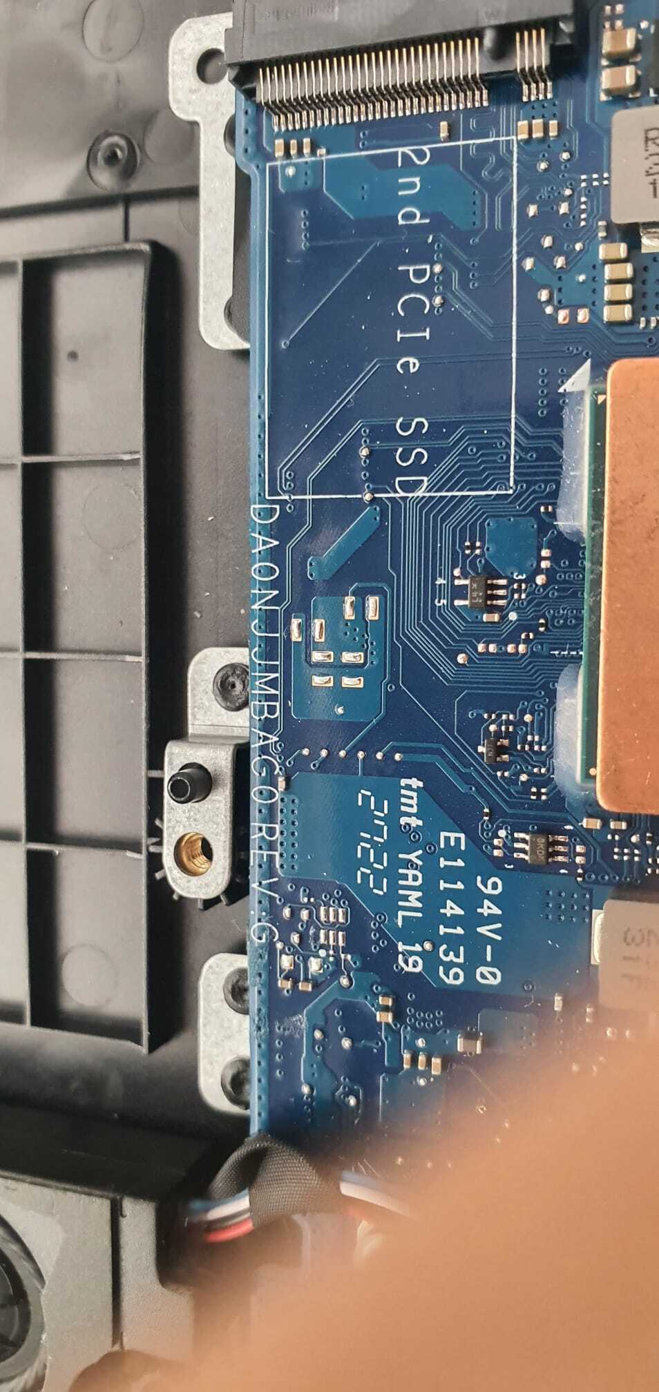

                • stikerun12
                  electronics
                  • Nov 2022
                  • 38
                  • Bucharest
                  HI! Please remove password from this bios. My laptop is turning on but have password on bios.
                  Model: FX506HC-HN004
                  SN: NANRCX00322540B
                  Mobo: DANJJMB1AA0 REV G
                  Intel 11400H and RTX3050 4gb

                    • stikerun12
                      electronics
                      • Nov 2022
                      • 38
                      • Bucharest
                      #30

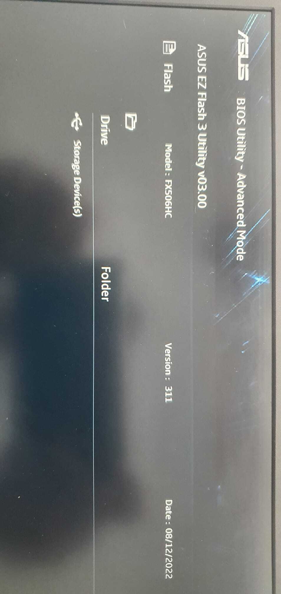

                      The password is working, but i think this is not the original bios from the laptop. The RTX3050 is not seen (it have all voltages, good bios) and no any ssd nvme bootable device, the usb is working. I attached that bios that i think it is from this mobo, but have no display. The EC is sure from this motherboard. Can you repair this bios please?
                      also i tried to update bios with EZflash, and it say fail to update..

                        • stikerun12
                          electronics
                          • Nov 2022
                          • 38
                          • Bucharest

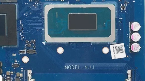

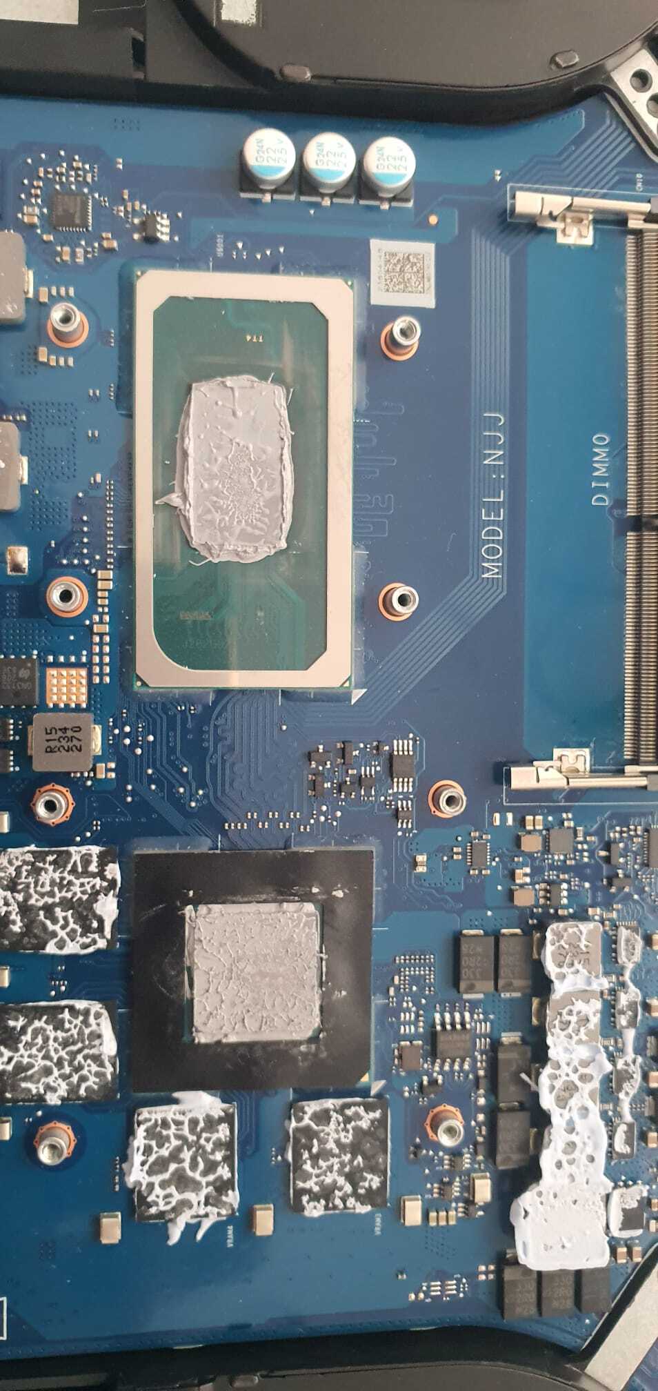

                          #32
                          this is the mobo, the ec seems to be original, was not wire connected before as i see., but the bios was changed or modified, i don”t know
                          The password bios was from here(post #9), the last attached is from laptop, but seems to be changed or modified, i don”t know. But i have no screen with original.

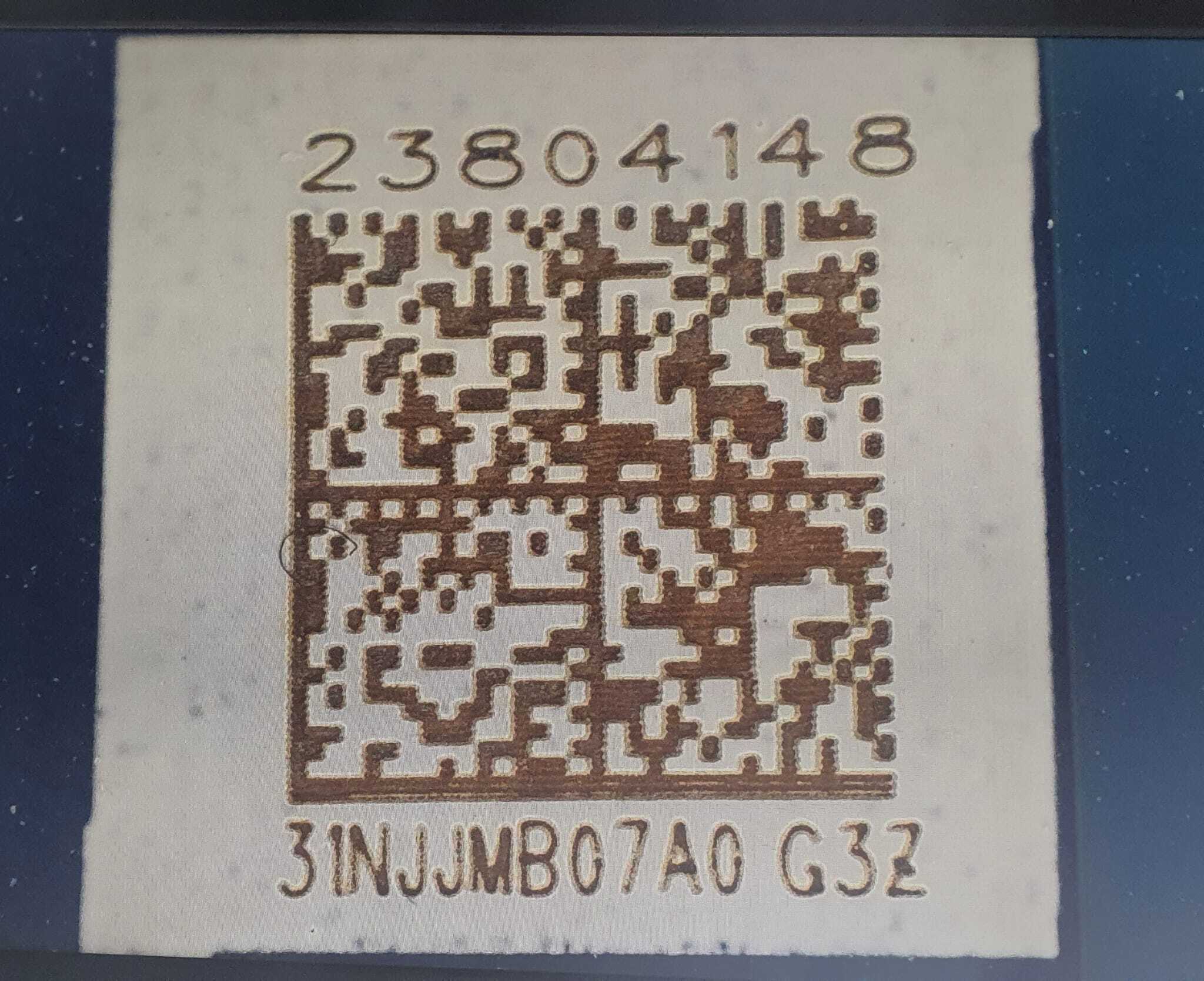

                            Scan the QR code and post what it says. If you can`t scan it post a good clear picture of it instead ,not some blurry crap, then we might be able to scan it or see if it has a model number written around the edge.
                            • stikerun12
                              electronics
                              • Nov 2022
                              • 38
                              • Bucharest
                              #34
                              This is what is say: QCCNJJ7AZ23804148,N938NRCX00BZ7TMB,FX506HC,60NR0720-MB2005,140,A036BC303613

                                    • stikerun12
                                      electronics
                                      • Nov 2022
                                      • 38
                                      • Bucharest
                                      #38

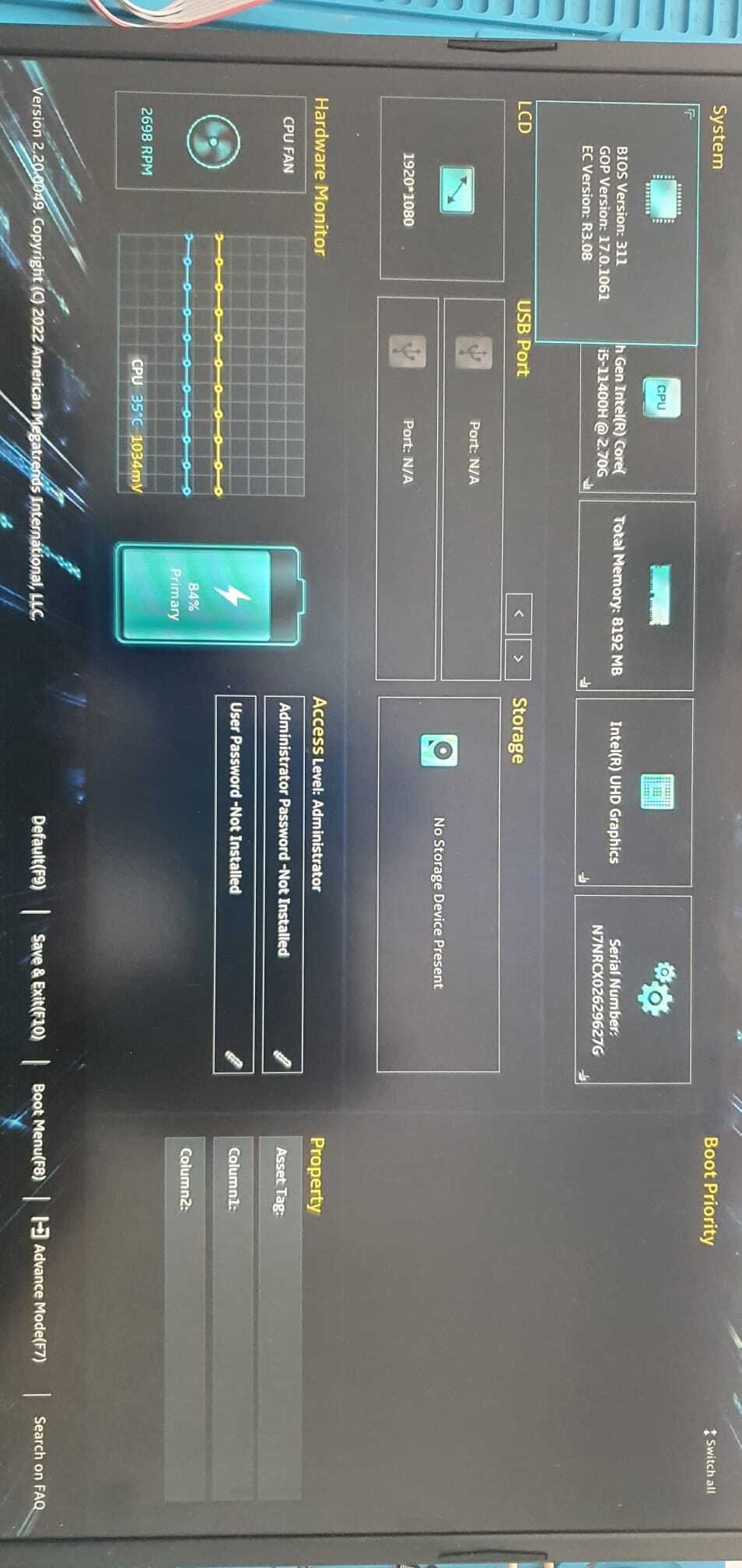

                                      both bios do not show image. The only bios that enter in bios and not showing GPU, ssd and now i see it can”t boot from usb either is locked one with password polpabs. I think it can be a problem from cpu, solder balls cracked or sth, is very strage. You have another solution/sugestion?
                                      In the photo is that bios that was lock with password, is the only bios that give me imagine.
                                        • 22293
                                        #39
                                        try this one.
                                        • stikerun12
                                          electronics
                                          • Nov 2022
                                          • 38
                                          • Bucharest
                                          #40
                                          This bios show me an image but when i first start it is restarting 10 times or more to give an image. With this bios i can boot from ssd or usb, it is working everithing normal in windows. When i reboot the laptop, it is restarting again for 3-6 times and then give an image. Somewhere in the bios is still a problem.
                                          As i can see the laptop give a picture when the pch is getting too hot (above 60-65 degree). With password bios, the pch it is not getting hot and the booting time was very fast, it takes 1 or 2 restart and show an image, but it not recognise ssd or i can”t boot from any device. (this is just an observation i don't know it is really matter in this situation).
                                          Also i tried to flash a clean EC firmware, but have no effect, the same result.
                                          When i tried to update bios with ezflash i give ~bios update fail~.
