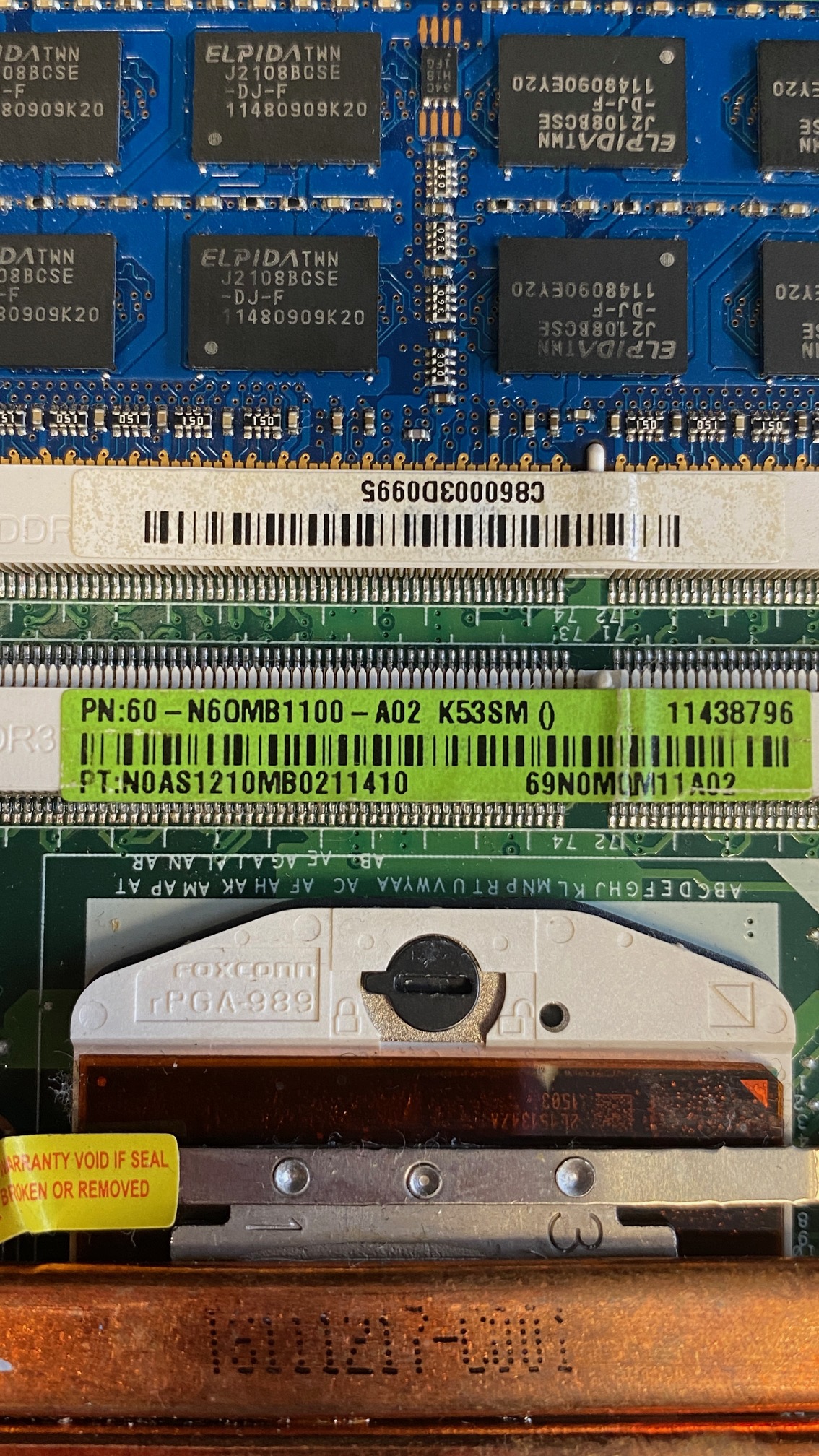

        Post a picture of the green/white sticker on the ram slot if the above bios doesn`t work

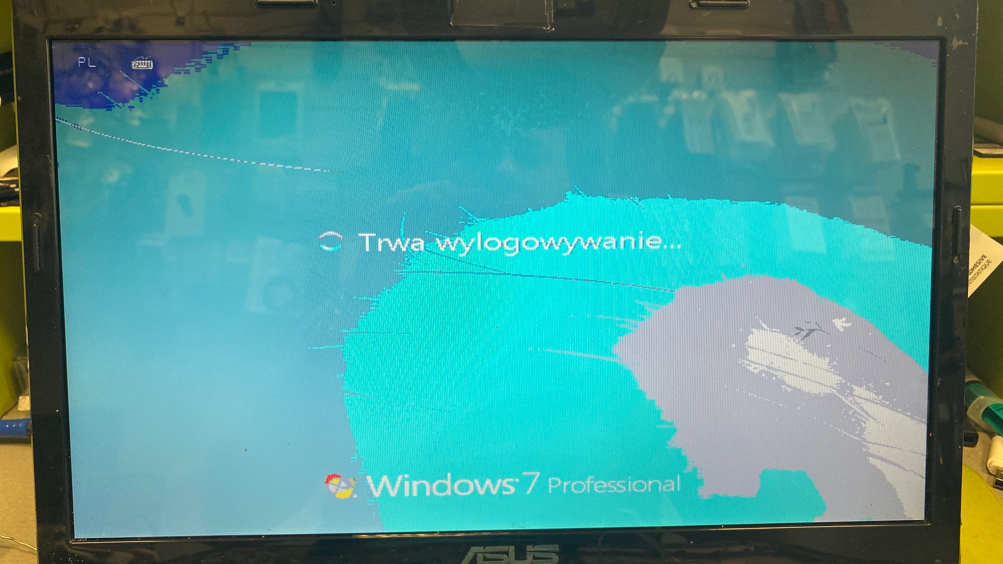

                        Hello, I got the ASUS K53SV REV 3.1
                        Laptop was shut down during bios update.
                        After switching on the lights, no image is lit, after programming the bios with the batch here from the forum, the laptop started with the image, but not in full resolution.
                        I have already tried a few dunks from the forum but no changes.
                        I am looking for the right load
                        K53SV REV 3.1 board
                        i5 processor
                        Graphics nVidia N13P-GL2-A1 GeForce GT 630M
                        Attached I am sending a photo of the sticker
                          K53SV REV 3.1 board
                          i5 processor
                          also post the corrupted bios..

                            #53
                            Re: Asus K53 bios
                            I am sending the ripped bios but I am not sure that it is correct because someone has already tried to program before
                            • peste
                              • Dec 2016
                              • 13653
                              • ROMANIA
                              #54
                              Re: Asus K53 bios
                              the bios is empty.....remove the bios chip from the motherboard before reading it...

                                I do not have the original file because I have already received my laptop in this state, only after uploading the new bios the laptop started with the image but with the wrong resolution. In the attachment I am sending the uploaded bios where there is a problem with the resolution
                                • peste
                                  • Dec 2016
                                  • 13653
                                  • ROMANIA
                                  #56
                                  Re: Asus K53 bios
                                  i do not have the original file because i have already received my laptop in this state, only after uploading the new bios the laptop started with the image but with the wrong resolution. In the attachment i am sending the uploaded bios where there is a problem with the resolution
                                  try...

                                    #57
                                    Re: Asus K53 bios
                                    Working, thanks...
                                    • xpuko
                                      • Aug 2016
                                      • 58
                                      • Poland
                                      #58
                                      Re: Asus K53 bios
                                      try...
                                      Thank you, it's ok
