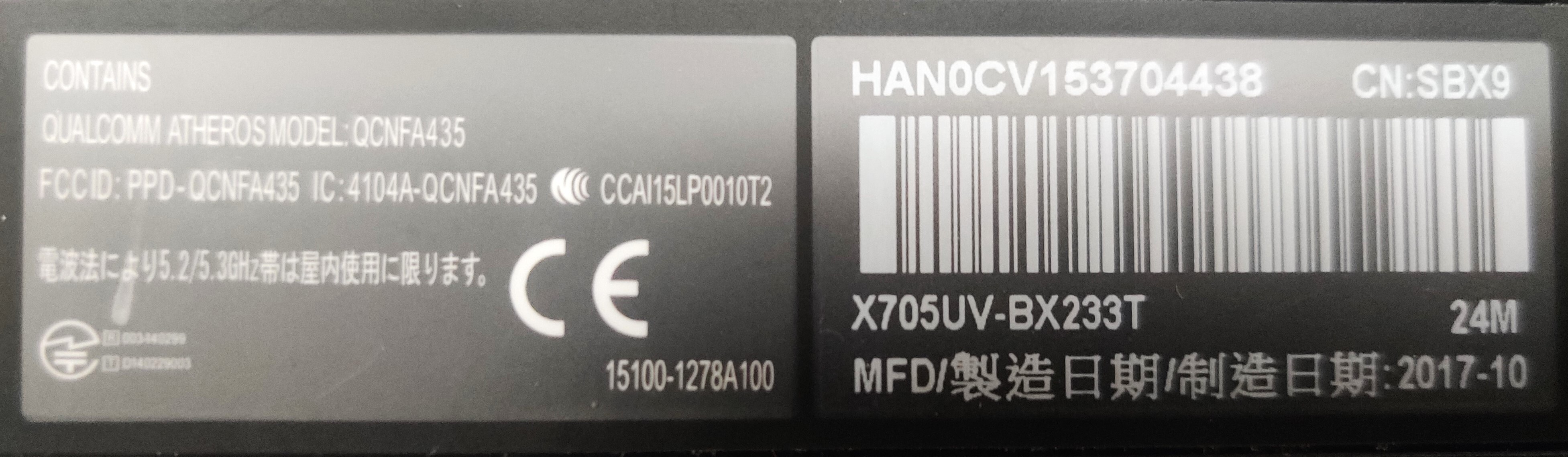

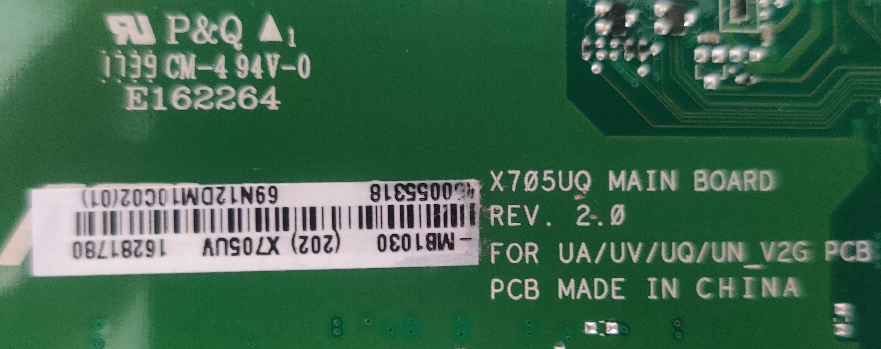

    I tried to follow the guide to flash it myself but I have two problems, the first is that the bios that Asus provides is not in .bin and no way to recover the .bin, the second problem is It says that the original version of my bios is 202 for my motherboard on the label but on the card it is written X705UQ REV2.0.
    Concretely, I can't figure it out.
    I will post the photos of the labels to you, it will certainly be more meaningful for you.
    TY
      TY

        Model bios x705uv
        • hoaca388
          Badcaps
          • Jan 2022
          • 12413
          Serial number ?
