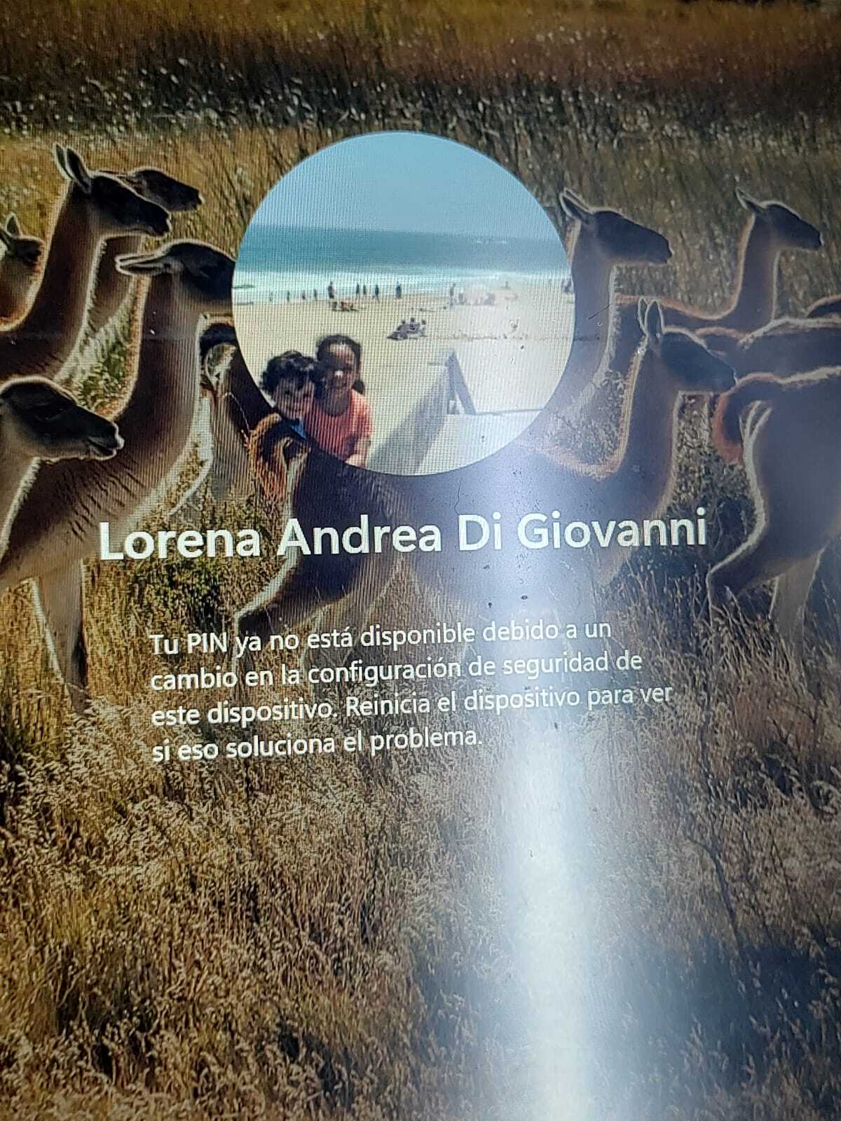

                            Sorry for the inconvenience. I copied the DMI and KEYWIN from my old bios, but I still get the sign in Windows that I have to reset the pin. I leave the bios edited in case you can review it. Thank you
                              Reset what pin ? , post an image of the screen
                                Translated :
                                ​ Your pin is no longer available due to a change in the security settings of this device. Restart the device to see if that fixes the problem.
