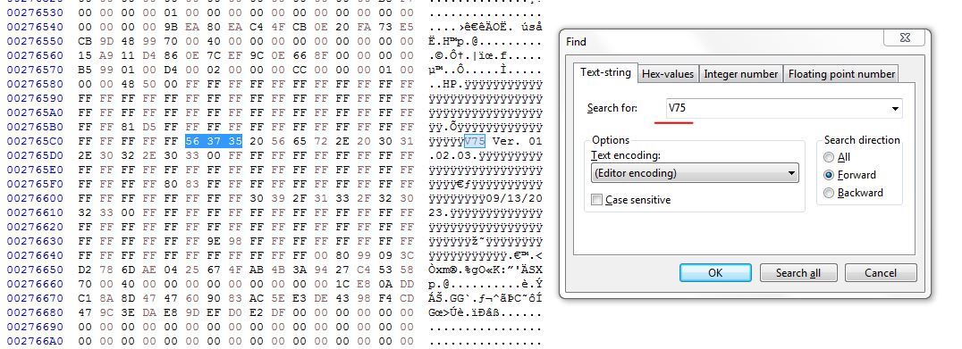

            hi all i need to patch my bios for that model hp elite book 640 g10. sn 5CD412435W
            MOTHERBOARD DA0X8TMB8E0 REV HSN-Q32C-4MB
          • bibi019
            • Jun 2014
            • 59
            • algeria
            #147
            i cant found what version of my bios BID. with hexeditor the information encrypted.
            so what tool i can read bios dump or any tool
            or some one who can patched me the main bios file
            • Stefan Steff
              • Mar 2024
              • 344
              • Romania
              #148
              Your version : V75 Ver. 01.02.03
                • 21662
                #149
                Search for text V75 .It`s not encrypted. What did you search for was it BIDV75
