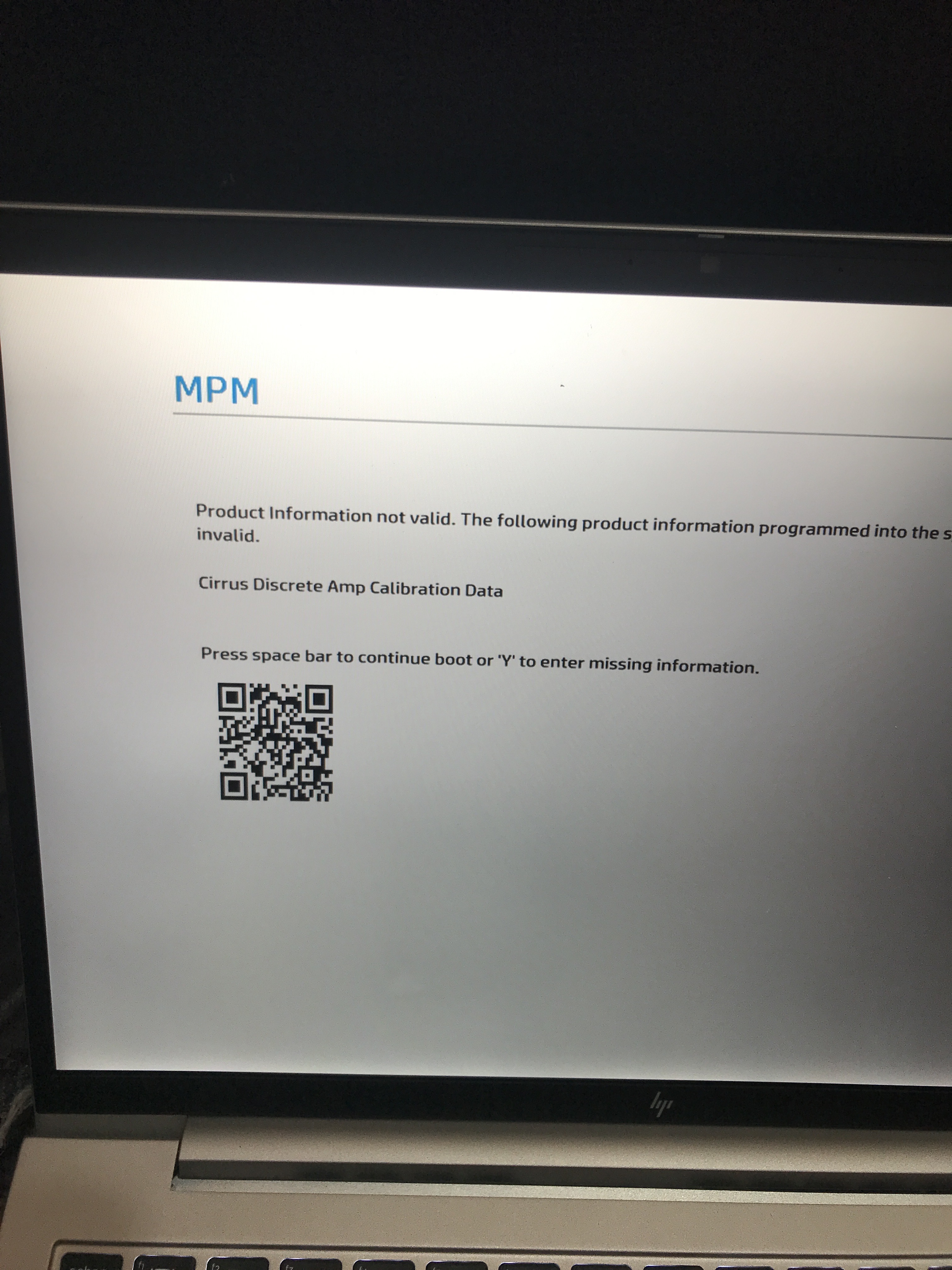

try. on first boot be patient. then press f10 reset security setting to defaults.
use BCU or MPM tool. only flash this main do not touch the EC.
Serial Number: 5CD33079FP
Product Number: 8S0D5EC#AK8
CT Number: PRVNR038JID1VO
Description: HP EliteBook 640 14 inch G10
build_id: 23WWKRBZ601#SAK8#DAK8
Feature Byte: 476J6S6b7B7H7M7Q7W7m7saBaEapaqauawbhcAfPguhKhkjhk8mEn7nVpDpVpnpqprqMqz.FQ
MAC Address: 64-4E-D7-16-D6-2AComment
OK, here is another version.
Please provide feedback,
P.S. Then read the post #8 from rex98 and do exactly as he said.Attached FilesComment

first boot press f10 reset bios to factory defaults and exit, 2nd boot reset security settings to defaults.
you can permanently disable absolute in BCU. Use BCU to fill these DMI info:
Serial Number: 5CG4073BX1
Product #/SKU: 6V4W7AV
CT Number: PRTKN00WBJ6006
Description: HP EliteBook 830 13 inch G10
BuildID: 23WWWGBZ602#SABF#DABF
Feature Byte: 476J6S6b7B7H7M7Q7W7m7saBaEapaqauawbUbhcAfPguhKhkj4jhk8mEn7nVngpDpTpWpnpqprqMqkqz.3A
MAC Address : 2C:58:B9:B4:C9:64Attached FilesComment
