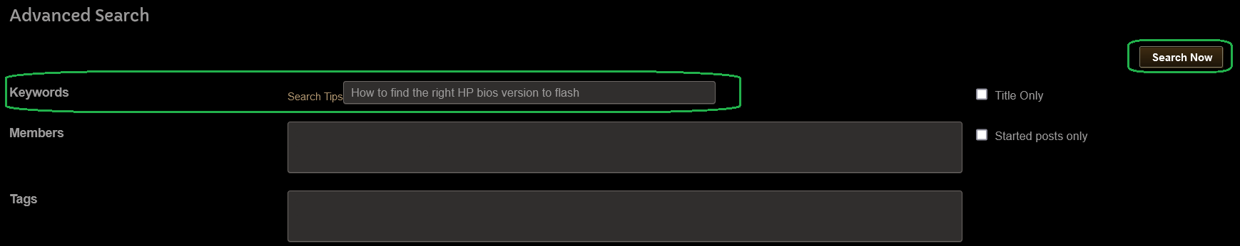

                Originally posted by Dexter898
                How do you know that is 081EF bios for my laptop?
                Originally posted by Vesko356
                Use search function in case someone already answered your request
                > Click image for larger version
Name:	Screenshot 2024-02-08 at 19-21-54 Advanced Search - Badcaps.png
