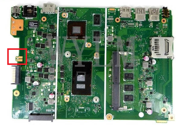

    Hello, Pls give me working bios for this model (Please see the board code)
    P/N X441UR-GA046T
    S/N H6N0CV03073623E
    Tnx in advance..

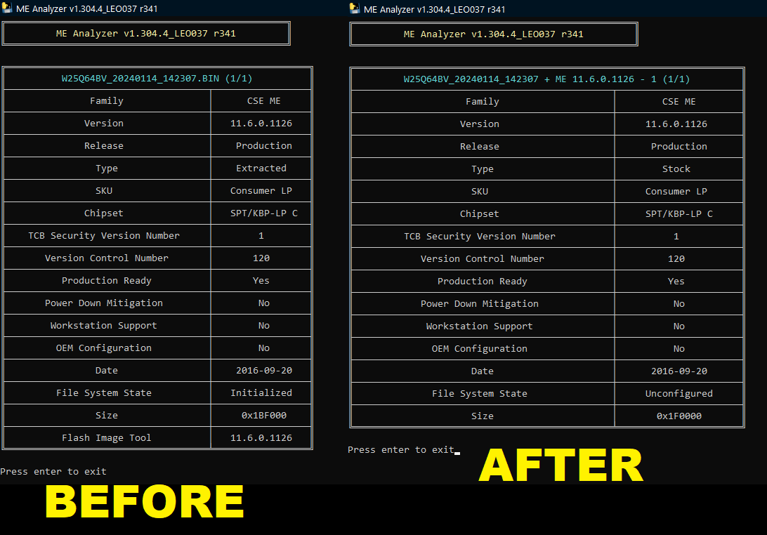

              TRY with this bios i download from the ASUS PAGE and armed and edited. try with this..... and tell me if work
              • Vesko356
                Vesko356 commented
                Editing a comment
                Stop using this crap called "Intel ME region injector" to clean the ME Firmware!
                Besides first try to replace the Bios region only with the one downloaded from Asus, in most of the cases this is enough to repair the bricked bios, if not - then clean the ME Firmware using proper version of Flash Image Tool afterwards.
            • leo037_2023
              DEMIGOD OF BIOS
              • Oct 2023
              • 63
              • Buenos Aires - Argentina
              i dont use intel me injector and just find the region me in the repository and use HxD . end...
              • Vesko356
                Vesko356 commented
                Editing a comment
                Come again?? You can't use HxD or ME injector to do that! ME Firmware can be cleaned with corresponding version of FIT ONLY!

                        • minhdigital
                          • Nov 2022
                          • 765
                          • Vietnam
                          Originally posted by Jezt
                          Boss, pls fix this bios again..🙏
                          Check Screw there
                          • Jezt
                            • Oct 2023
                            • 13
                            • Philippines
                            Thanks man.. I didnt see that
