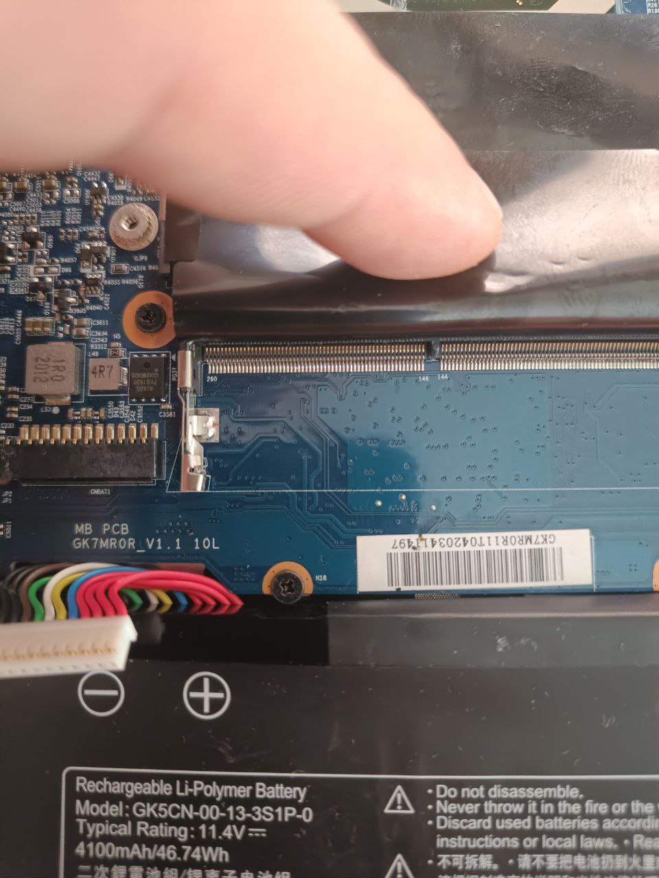

    need bios for gateway GWTN156-3BK
    There is a laptop Gateway GWTN156-3BK that does not show a picture when turned on, the fans are spinning. Suspicion of a faulty BIOS. Can anyone share the BIOS dump?
    The dump was taken from the laptop using a clothespin and CH341 programmer using NeoProgrammer 2.2.0.10
    BIOS backup attached
    S\N: GWTN156-3BK20H03505

        same status ?
        possible bios is cropped or posibale other hardwear issue
        since getaway donst provide any bios file on its support we can find another working bios
        post your mother board part number we will try to get a third party working bios for you

          same situation.
          mb: GK7MROR_v1.1 10L (GK7MROR11T04203411497)

            Try this
              • 22282
              Try this one. Built with GKxMP60xN102.ROM from winraid -> https://winraid.level1techs.com/t/ne...recovery/93122

              • stas-karabas

                I checked your and the previous BIOS dump, unfortunately there is no result. Can you explain what kind of DMI data this is and what should I do with it?
                • qayyum786
                  • Aug 2018
                  • 1959
                  • INDIA
                  possible you dont have an bios issue in your board it could be a hardware issue
                  DMI means information of your laptop like your serial number your windows license key etc etc .

                    Thanks anyway for wanting to help with my problem. I will continue to look for what the problem is. All the best to you.
