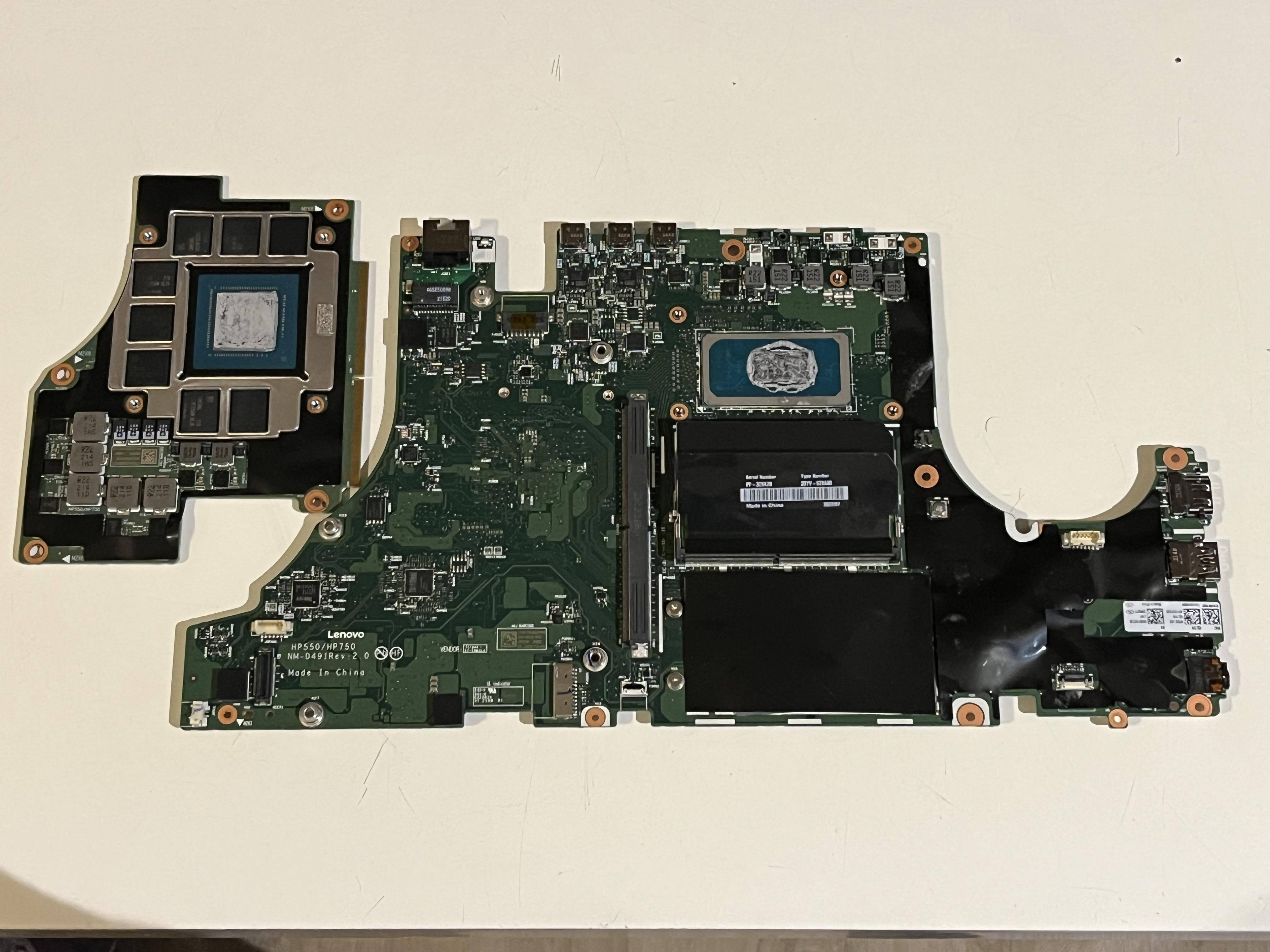

    Hello ,
    NEED BIOS Lenovo Thinkpad P17 Gen 2
    Type 20YV
    PF3Z5XZB
    just the light flashing when plugging in the charger.
    Test without cmos : no fan, no boot, nothing.
    motherboard alone.
    No results.
    charging light present
    Maybe it comes from the bios.
    Do you have any opinions to help me?
    3.18v on Power BTN, which goes to zero when pressed
    3.24v on Bios chip

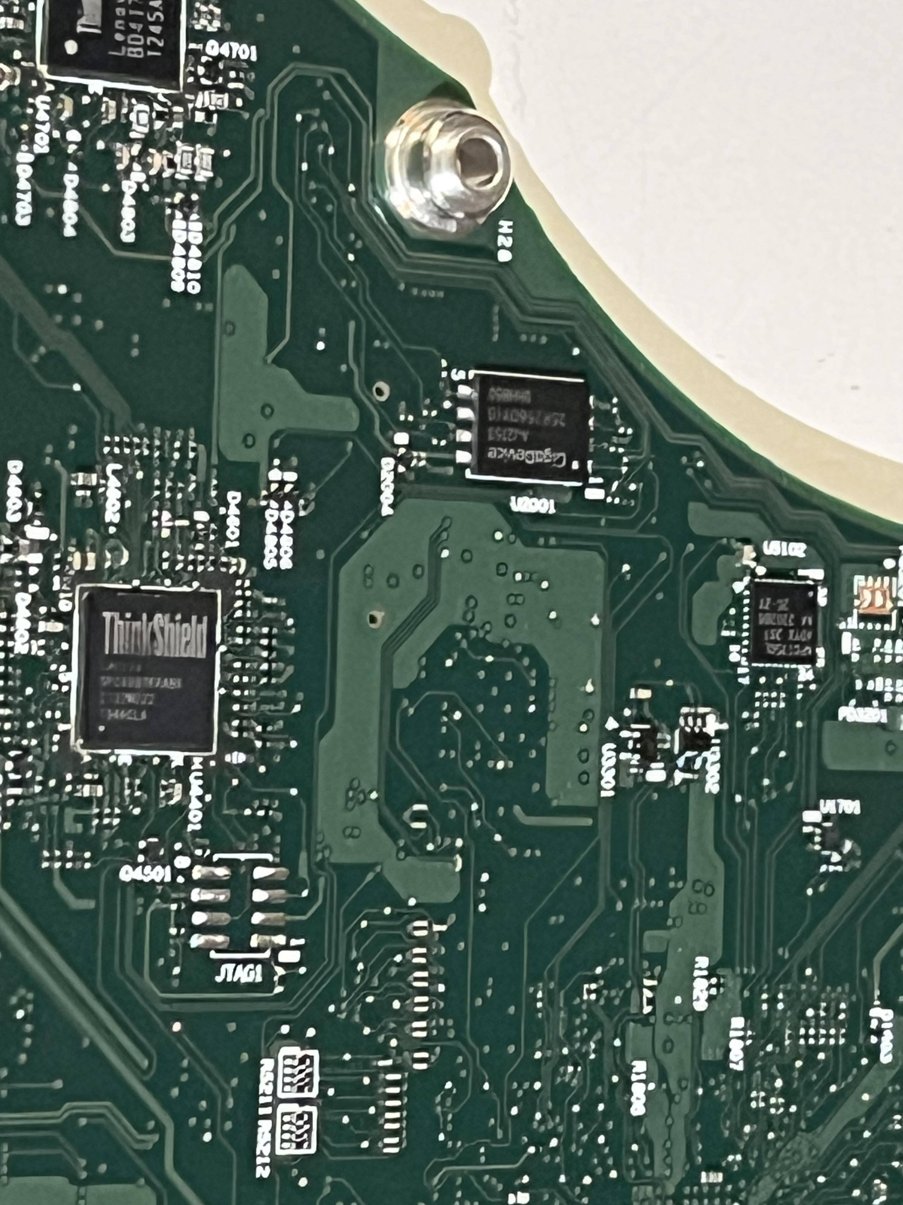

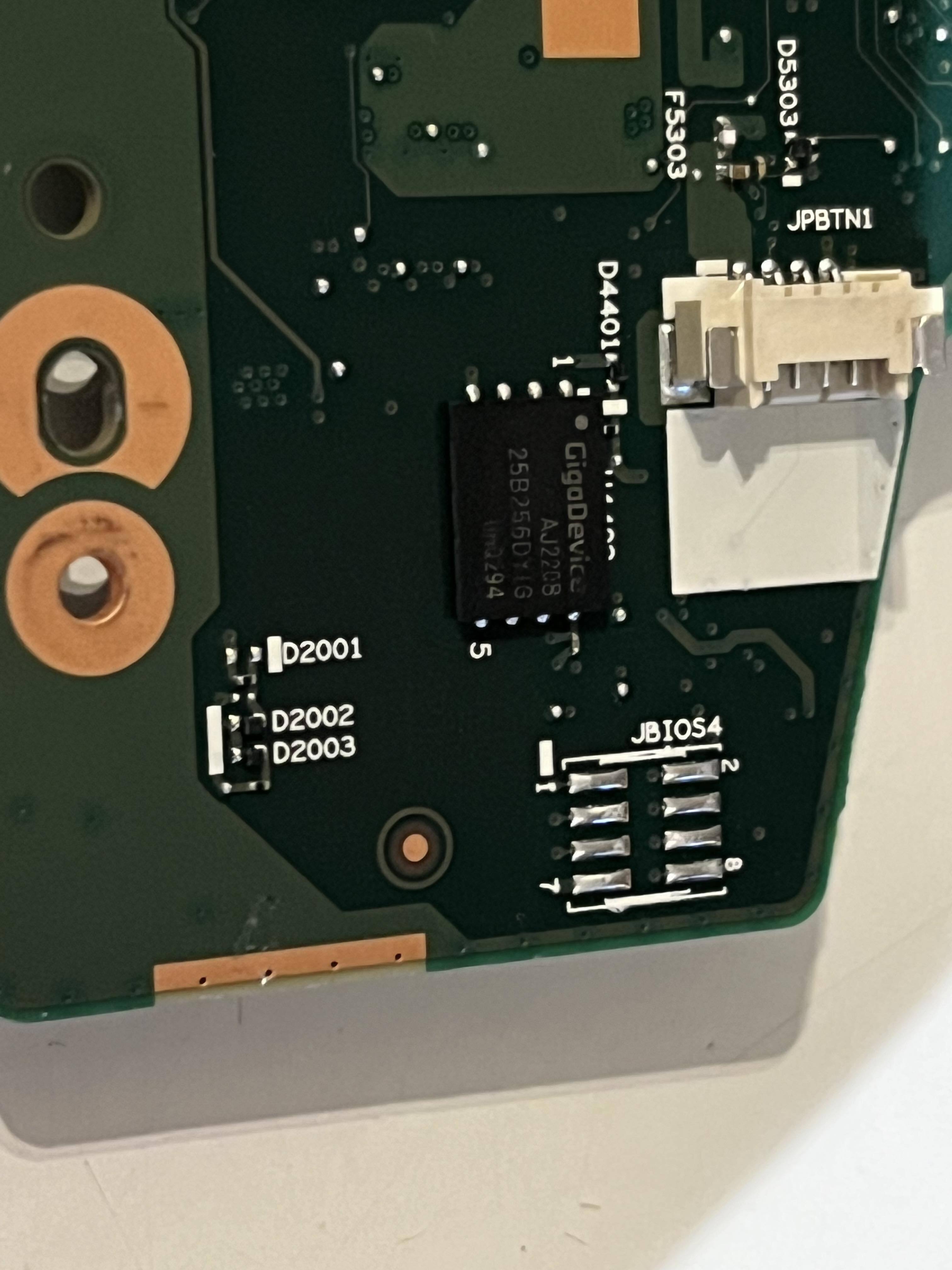

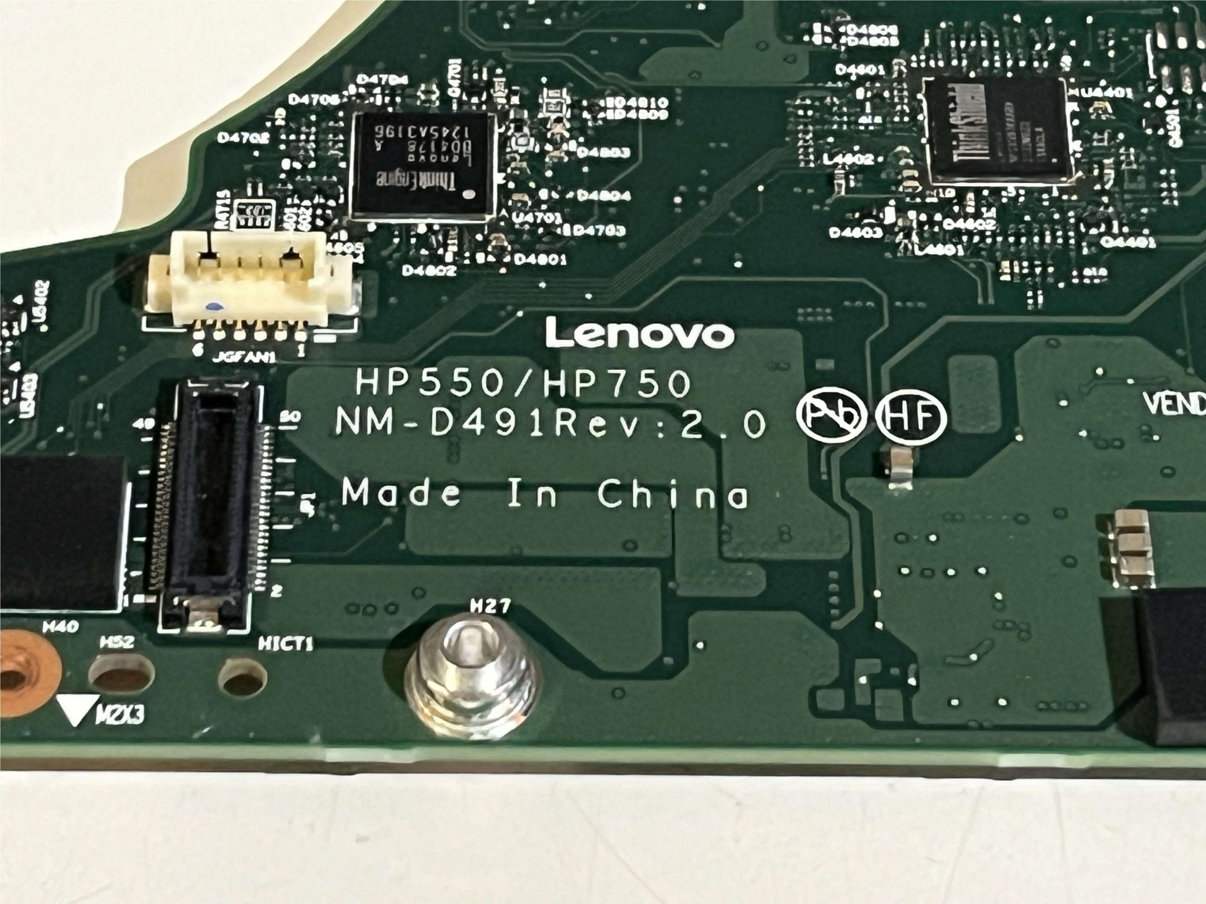

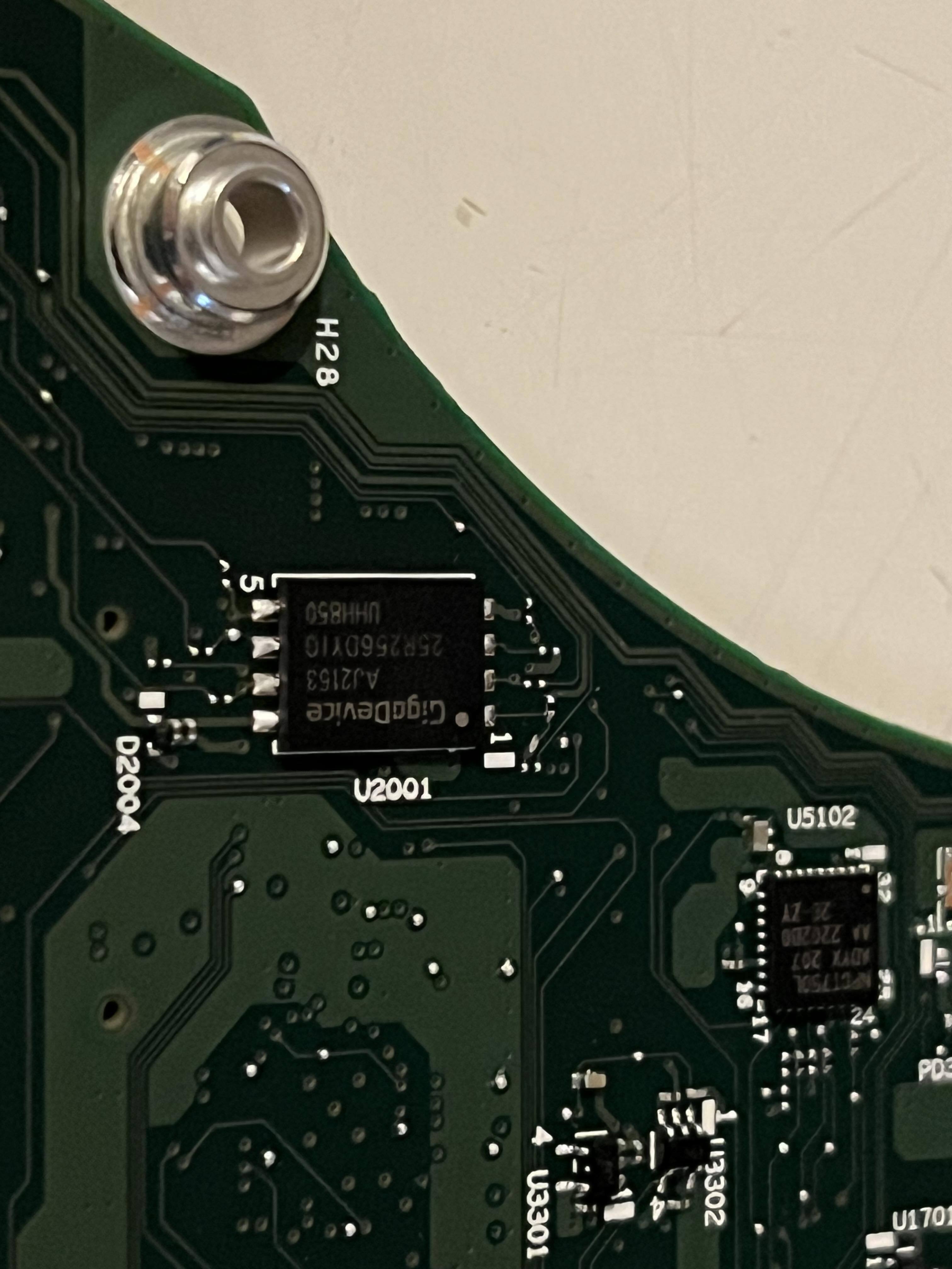

        HP550 / HP750
        NM-D491 Rev: 2.0
        Click image for larger version  Name:	403634812_889091149206811_8563377082582035027_n.jpg Views:	5 Size:	1.88 MB ID:	3163268

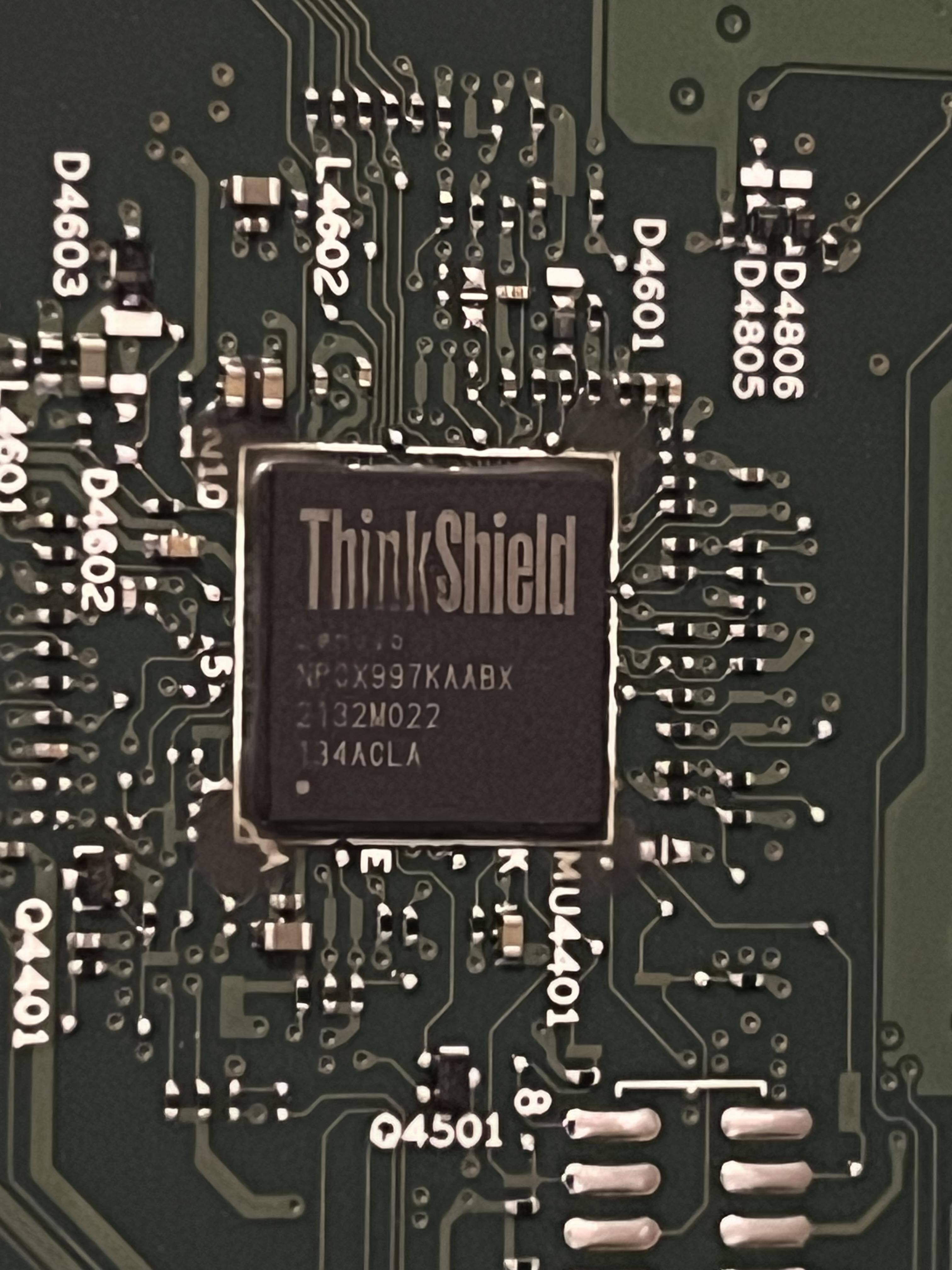

        2 chips 25R256 and 25B256
        Ec Nuvoton NPCX997
        It is complicated to take time to repair this type of machine.
        My boss prefers to put this straight in the trash.
        I found the Fl1 and 2 files but
        I don't really know where to cut them i have to compare them when I have the reading.
        U2001 near Ec supplied

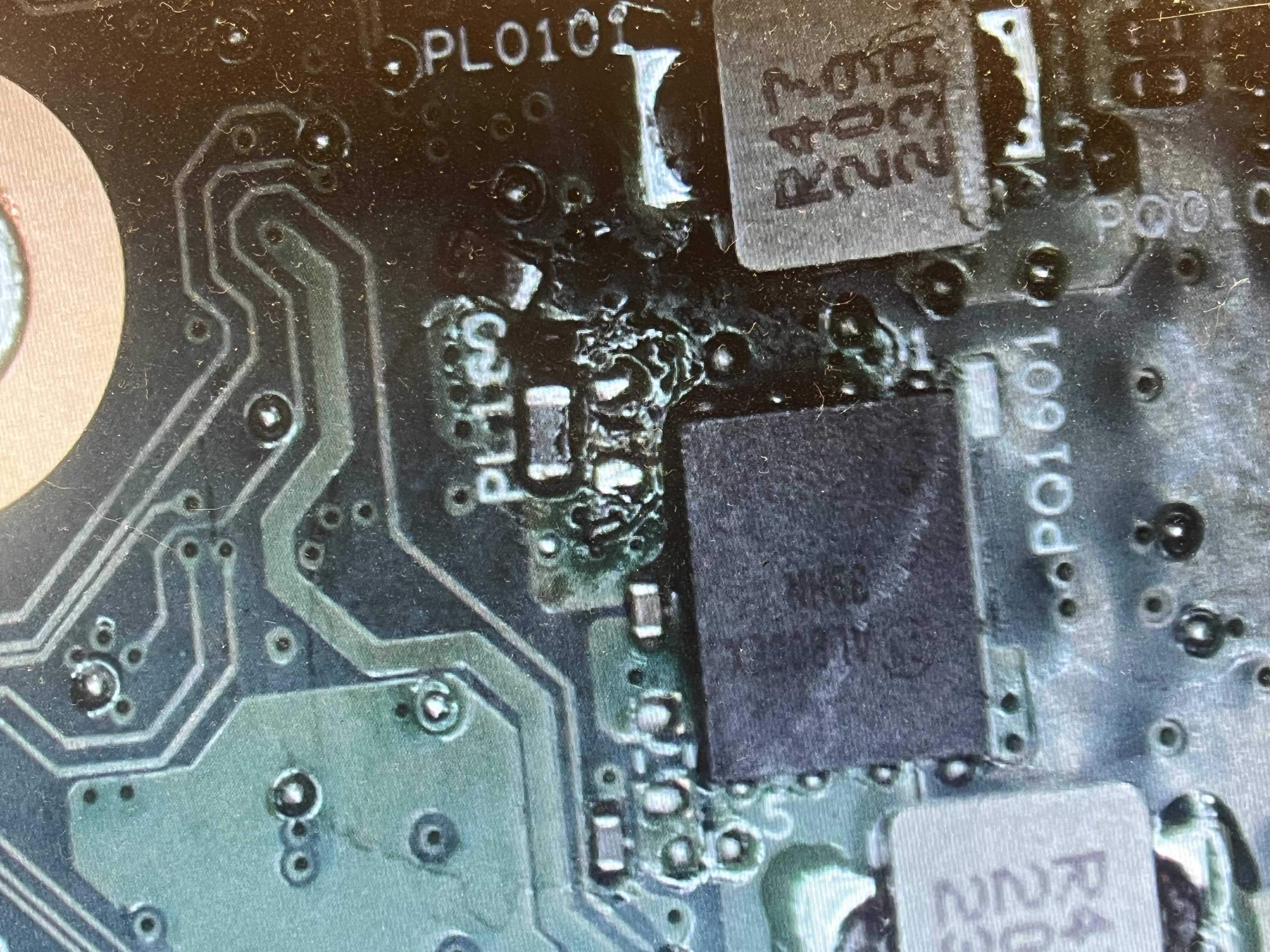

              Some news
              Solved
              1 filter burn + 1 caps dead
