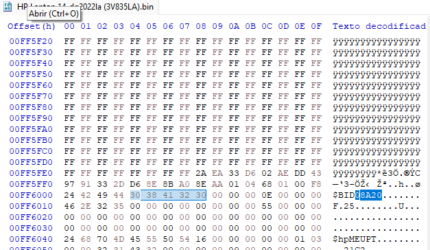

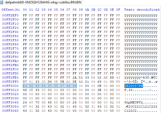

    Originally posted by hoaca388
    HP Laptop 14-dq2022la (3V835LA)
    s/n. 5CD237JMYQ
    hoaca388 wrong BID... your BIOS is 8A20, original dump from nikosystem is 87FE, HP website mixed 2 BIOS updates for different models in the same page
