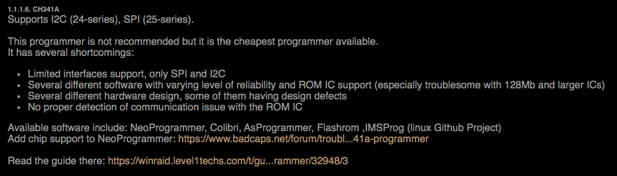

          congratulation, you have a branded lenovo door stopper. Before bricking another laptop read BIOS GUIDES of this forum
          https://www.badcaps.net/forum/troubl...t=phoenix+bios

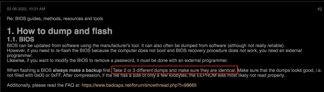

              since you write back original file and it doesn't work means your backup is fcked up. Use right tools (described in bios tools) if you want to have good results and also check components around bios chipset, clamps may damage them.

                  1st step is to acquire a good bios backup. Since your chipset is 1.8V YOU HAVE TO USE 1.8V adapter. Best way to have a good bios backup is to remove bios chipset from board. Having CH341A use AsProgrammer to backup bios and read 3-4 times until you have 2 identical backups bin files. ALL STEPS ARE DESCRIBED IN BIOS GUIDES but you fail to understand that YOU HAVE TO READ IT!

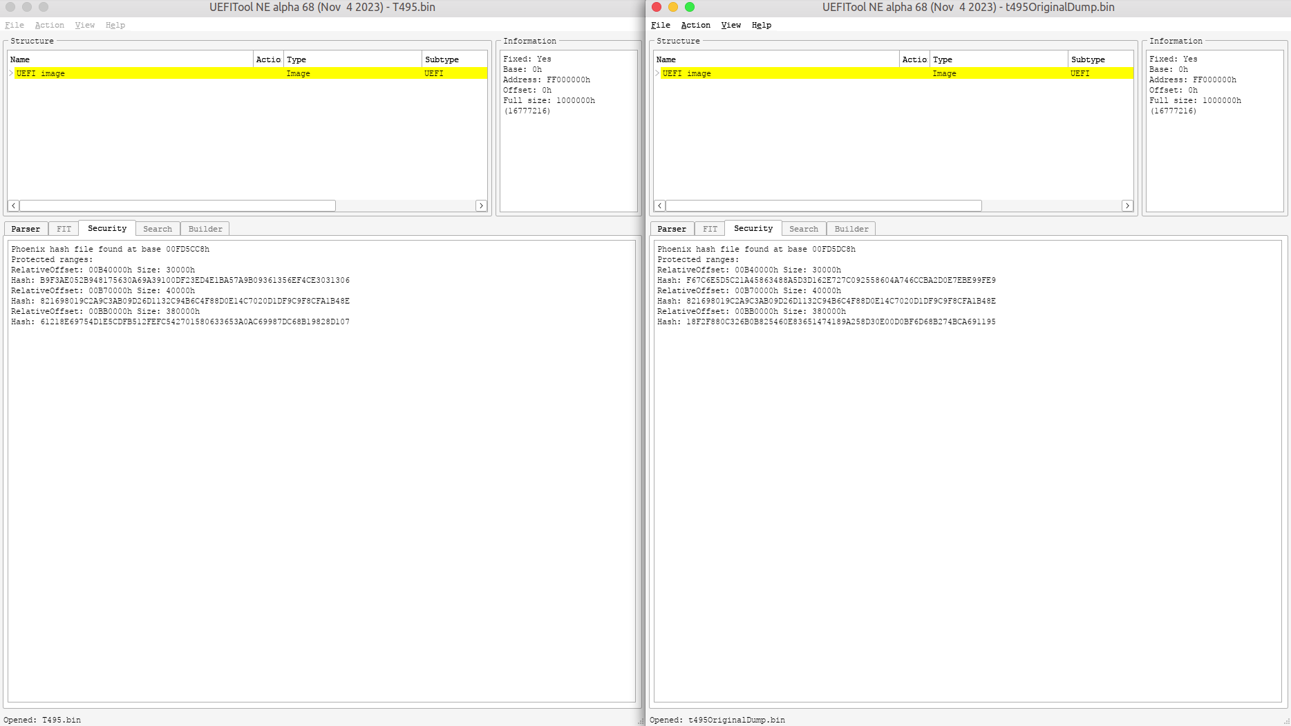

                      Hello try this new hash patched file from your original file from #18
                      https://www.badcaps.net/forum/troubl...61#post3261861

                                  it will not work because Volume_NVRAM_EfiSystemNvDataFvGuid is not patched. that's why autopatcher doesn't work on this model ... But you are close to discover warm water ...
                                  And you apply patch to a backup of 1.8V chipset made with 3.3V CH341A programmer with clamps. What's the odds that backup is ok? Think, is for free!

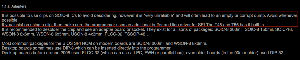

                                      there is but you have to remove bios chipset from board with hot air gun and use programmer adapter to write it, then solder back. Write serial number.
                                          This is the S/N PF-26H4AM.
                                          Why I can't use the soic clamp?
