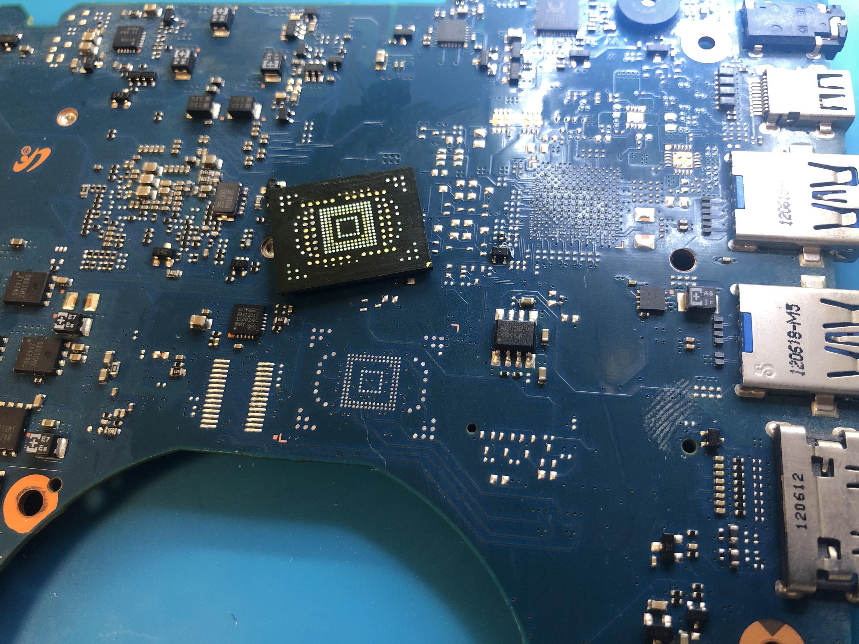

                            NP700Z7C ba92 11017b dump maybe? accidentally erased the stock firmare before backup it first in my programer. I tried with last firmware whaldsz posted for BA92-10916B and only get backlight of the display and then he is restarting again and again and again

                                Re: SAMSUNG NP700Z7C - BIOS dump needed
                                The solution to this Samsung Series machine is remove the dead iSSD flash from Sandisk. This cause a long freeze on boot.
                                I hope it helps.
                                Br
                                  #36
                                  I hope it helps.
                                  Br
                                  Thank you!!! It's Works
