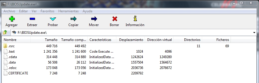

                I have download bios file from Samsung support, (BIOSUpdate.exe) and can`t extract any bin, rom, fd etc.
                How do you extract the dump file?

                  did you try with 7-zip?

                    Yes, I have tried 7zip, and let me see the files inside, but the largest one, is less than 1,3 Mbytes.
                    (I have attached a screen capture of 7zip)

                      Re: Need BIOS: Samsung RC520 (jinmao-r)
                      Never did. I got it off the actual bios chip.
