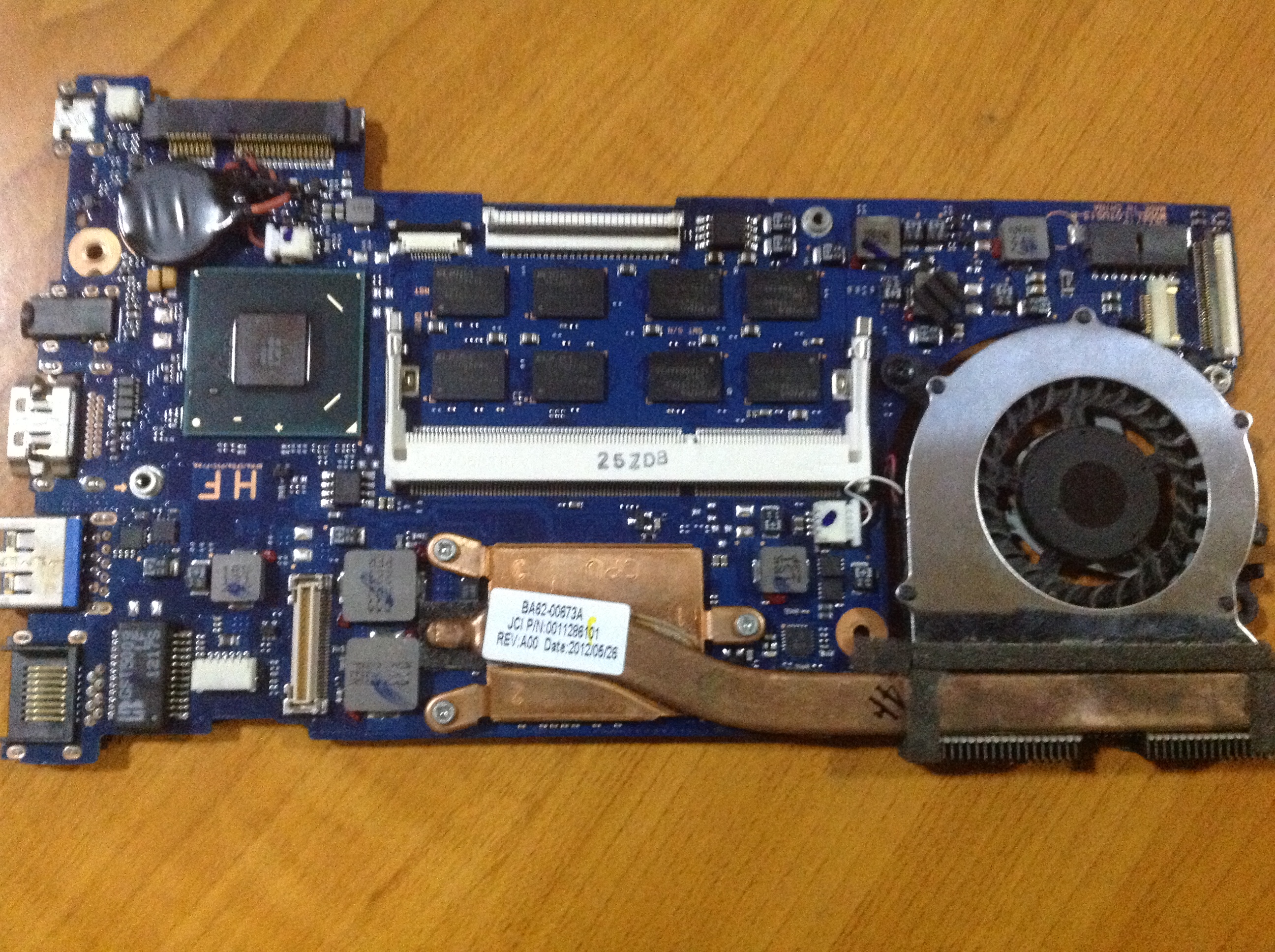

    Here's the image.... I haven't touched the board, still waiting for customer confirmation.

      Please can you upload dump for your board . Check the one post in this thread but not working. Got one working but with admin password .

          Re: Samsung NP530U3C BIOS dump file
          from working machine with win7
              thank you very much it's working now.
                          Hi
                          I have a NP530U3C but it's don't boot and the F2 or F4 don't work.
                          Speaking with samsung service they say i need to reflash bios.
                          Now i have the Crisis software and the right bios file but i not able to reflash.
                          I make many tentative but nothing work.
                          Some one know the right procedure for this Samsung NP530U3c.

                                  #36
                                  Originally posted by Learn2Day
                                  Dunno if this is any help for you. but i've also found a chinese website with BIOS posted.
                                  http://www.qdzbwx.com/forum.php?mod=viewthread&tid=4686
                                  Cheers.
                                  i have 2 bios for share , if i can find schematic, i will post here
                                  530U3C.bin:
                                  motherboard code
                                  ba41-02157A
                                  ba41-02155a
                                  ba41-02154a

                                    #37
                                    Thanks to this post I was able to relive my laptop after changing the bios chip and reprogramming it with the file published by khaahk. Does anyone know if after updating the bios to the latest available version, the problem to install linux was corrected? greetings from Argentina!

                                      #38
                                      530U3C.bin:
                                      motherboard code
                                      ba41-02157A
                                      ba41-02155a
                                      ba41-02154a
                                      Thank you very much, the first BIOS worked with a NP530U3C Lotus 13-R Rev: 1.3 (ba41-02157A)
