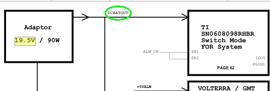

                                  • orientalsniper
                                    • Apr 2013
                                    • 461
                                    Re: Sony VPCSB (MBX-237) dead after bios flash
                                    Are those two DCBATOUT present in the picture?
                                    And I think I did something stupid, I couldn't measure anything in SN0608098RHBR, so I probed PIN7 with some pins in the opposite side and I think I saw a flash or a blink with wrong timing.
                                    I circled something in SN0608098RHBR, does that look burnt?
                                    • orientalsniper
                                      • Apr 2013
                                      • 461
                                      Here's another angle:
                                      • Francisco.s
                                        • Jan 2013
                                        • 686
                                        • Spain
                                        I don't know, I can't see which connectors they are.
                                        Yes, if you saw a flash or a blink, probably you made a short-circuit and burnt the SN0608098RHBR. you should change it.
                                        Pin 7 is located near PC205, the one in the green rectangle.
                                        Always check voltages in components connected to pins, not in the pin, it is safe.
