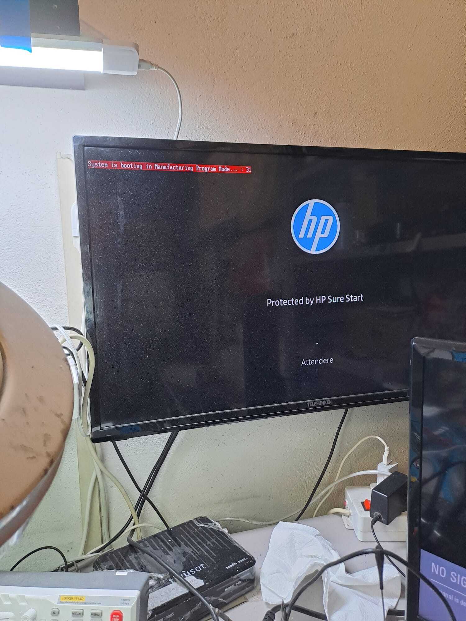

                                Hi guys, can anyone help me with this
                                problem with the HP Probook 635 Aero G7 endpoint security controller?
                                ProdID:2W8R5EA#ABZ
                                SN: 5CG1073BX4
                                • hoaca388
                                  Badcaps
                                  • Jan 2022
                                  • 12527
                                  #76
                                  ProdID:2W8R5EA#ABZ
                                  SN: 5CG1073BX4
                                  Endpoint security controller
                                  • lauri61
                                    • Jul 2015
                                    • 5
                                    • italia
                                    #77
                                    hoacaa thanks now I have this screen what to do
                                    • hoaca388
                                      Badcaps
                                      • Jan 2022
                                      • 12527
                                      #78
                                      Use BCU and enter serial number, product feature byte..., it will exit Manufacturing mode.
