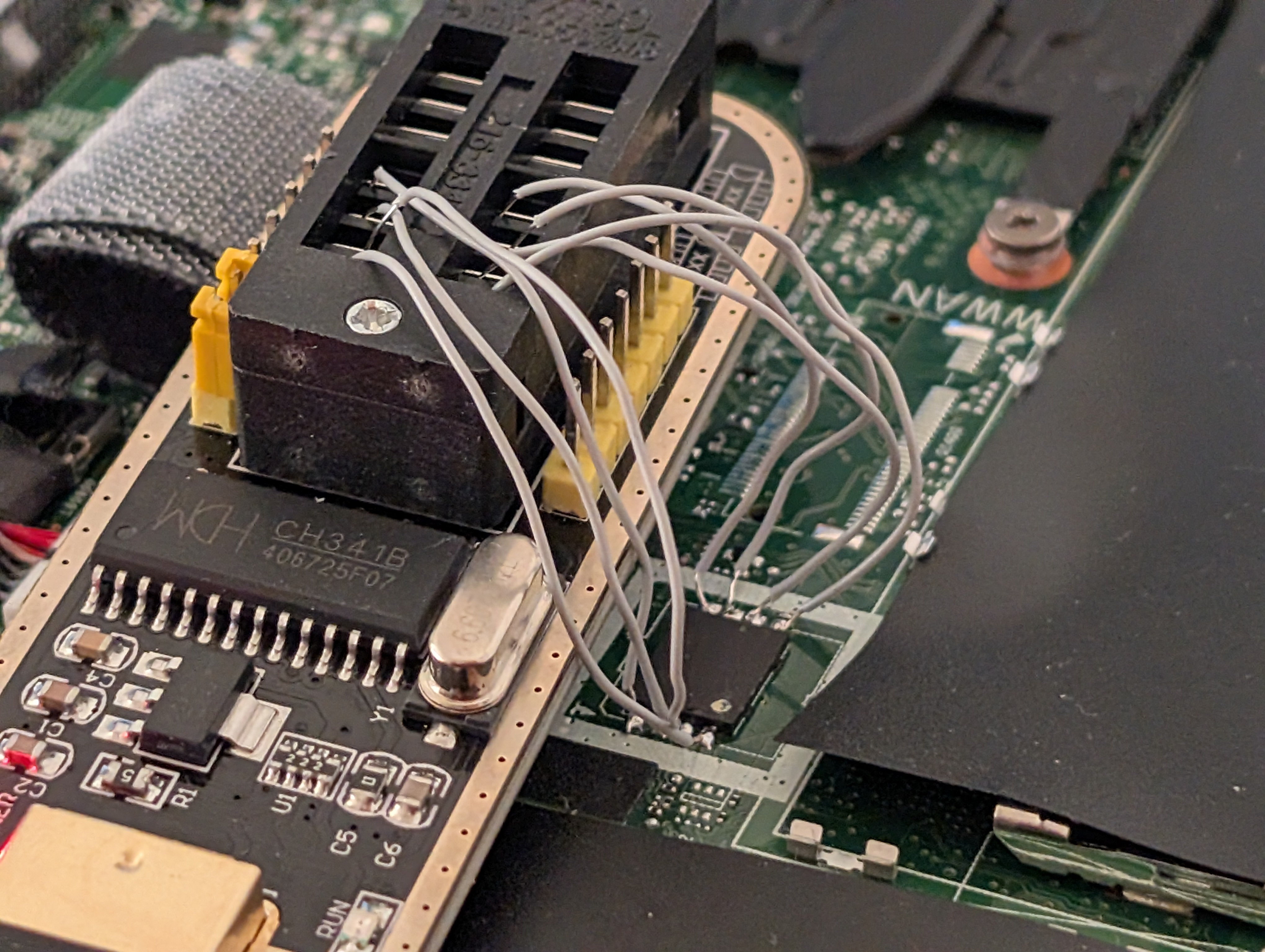

        Hi everyone, I had the same problem with the endpoint controller.
        It rarely turned on, and the last time I was able to update the BIOS correctly.
        After restoring the default settings, the screen stays off and the Caps Lock LED blinks 7 times.
        I can no longer get it to start in any way.
        Many thanks to anyone who can help me.

          post the contents of the bios chip even if it is corrupted..

            Thank you so much. I just realized my 1.8v conversion board is fried. Waiting for the replacement and I'll upload it.

              No luck: I wasn’t able to dump the BIOS in any way.
              I first tried using the 1.8V board, even though the chip is a 25Q256J V EN (not W).
              Then I tried powering it at 3.3V, but in that case the programmer doesn’t detect it at all.
              I’m using the CH341A with NeoProgrammer and selecting W25Q256JV, but still no success.
              Do you have any suggestions, if possible?
              Thank you very much in advance.
              Have a great day.

                Post a picture of the chip in/on the adapter board, not the 1.8V board

                  Since I didn't have the adapter for this chip, I soldered each pin with a thin wire.
                  I even tried dissoldering it from mobo.
                  Simply not recognized using autodetection and/or setting manually the W25Q256JV chip on neoprogrammer .
