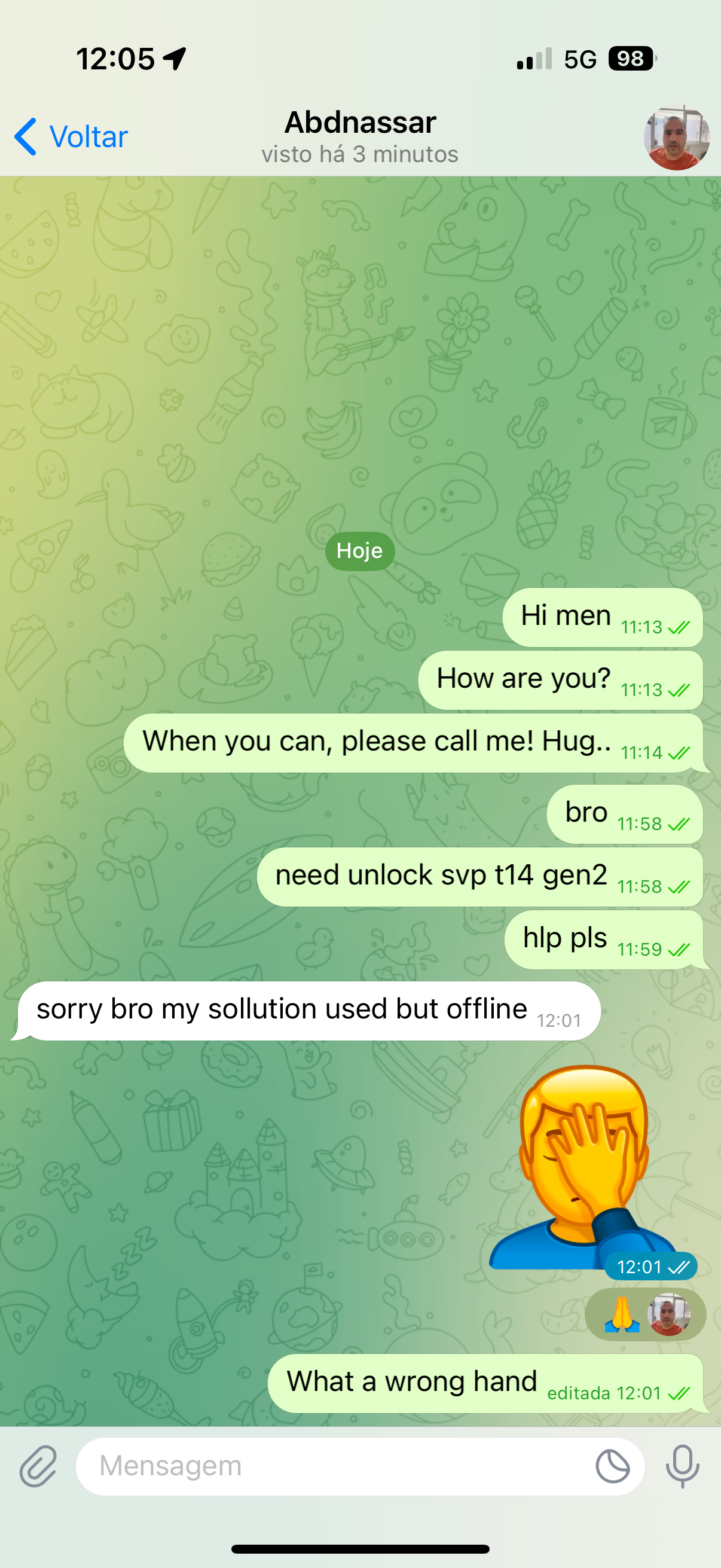

                #48
                I talked to him and look what he said.

                    #50
                    Originally posted by anhbanxoi
                    Try replacing the MEC, take a bit longer time but it works.
                    In the comments, he says it's done via patch and claims there's no way to read it on the MEC1503, so I contacted him, and he says it's only possible with the equipment in hand.
                    It's impossible that to this day this information remains a top secret; no one sells it, and no one performs the procedure remotely, only by hand.
                    He claims it's a patch, and we already have a clue about that, if that's indeed the case.

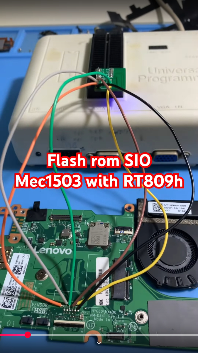

                            • img1
                              • Aug 2015
                              • 22
                              • Earth
                              #55
                              Originally posted by mmccomputer
                              Is there a solution for the MEC1503?
                              Hi!
                              I found a video about MEC1503 and RT809H. I'll test it and reply back in the next few days or weeks when I get my hands on a ThinkPad X1 Carbon G9 (NM-D341).
                              https://youtu.be/QOw7NWO_6RM
                              • santoslao
                                • Apr 2017
                                • 131
                                • BZ
                                #56
                                Originally posted by img1
                                Hi!
                                In the description it says it's this model, but me honestly? I don't think it's MEC1503 that he's programming! It doesn't show from the beginning of the video, I believe it's just a video to have views! They say that to read or write in this MEC, it is necessary to have a 10k resistor at some points on the board.
                                • img1
                                  • Aug 2015
                                  • 22
                                  • Earth
                                  #57
                                  Good point.
                                  The MoBo in the video is seemingly the NM-D341 with MEC1503, which is the exact board of the TP X1 Carbon G9.
                                  The TP Carbon is on it's own way to me (the customer lives in another city and he 'll jump over sometime, but IDK when exactly), time will tell. JTAG jig is not a problem because I already made my custom one for MEC ECs (pullup resistors on the board, so not all the resistors soldering needed, just the mode selector) which I successfully used with some MEC16xxs before. So the hardware is ready by the time the TP Carbon arrives. Anyway, I would have tried it by myself because I have an RT809H on hand and it's worth a try. :-)

                                        #60
                                        Hi!
                                        is not MEC1503 its Mec1663 . the MEC15xx or 17xx come with efuse . otp JTAG/SWD disable . if you want enable jtag you need patch EC FW flash in SPI ..... and the EC FW is protected hash signature verification ECDSA if you have KEY you can do what you whant ... LPC_eSPI_I03 shorted with gnd not kill board ...
