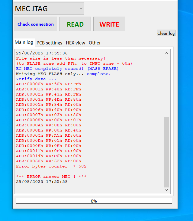

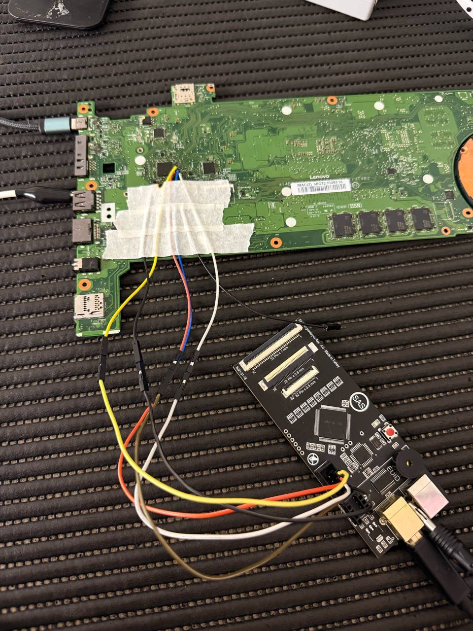

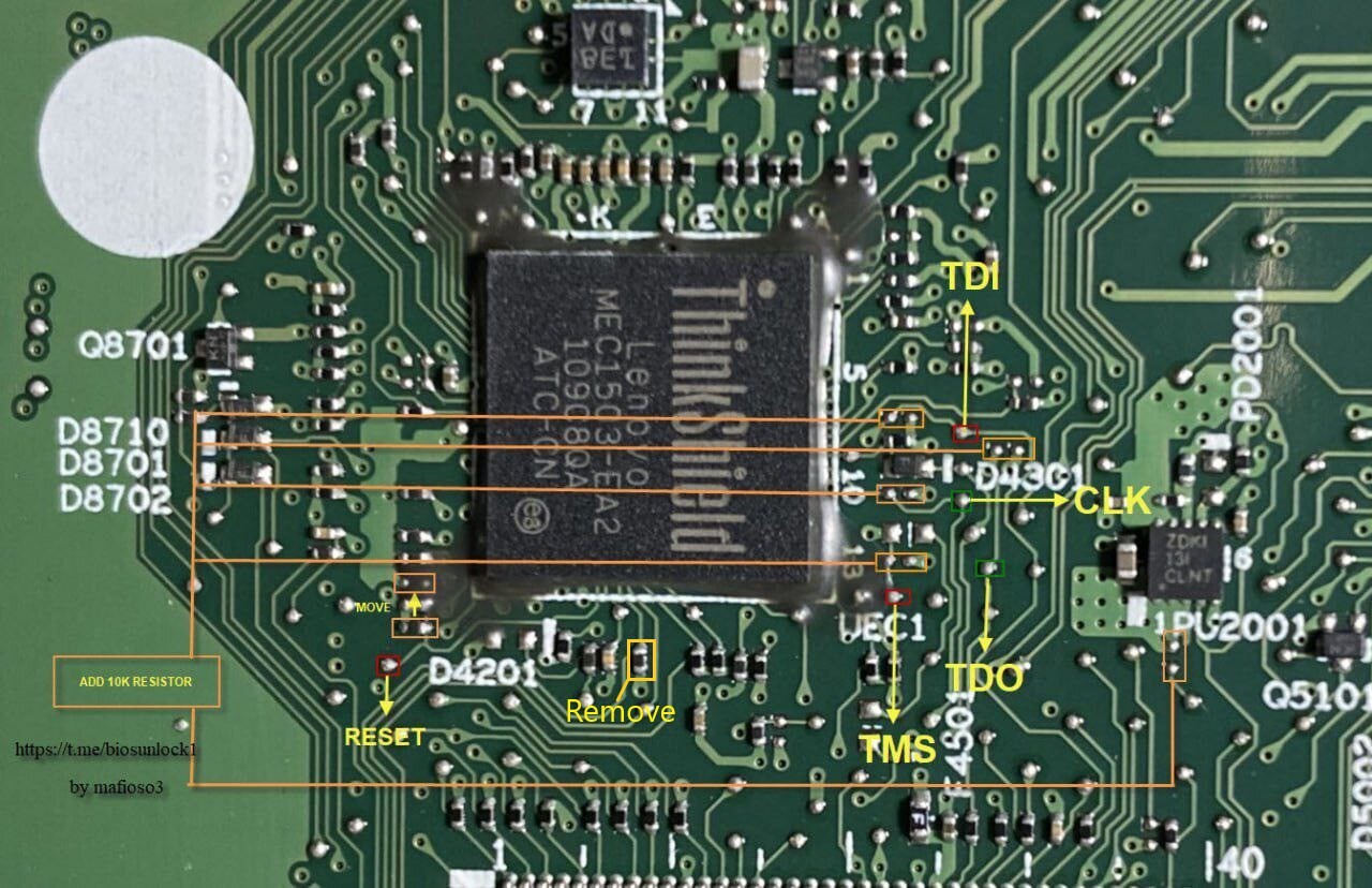

        Continuing the saga of trying to unlock the password of these bios of this damn, I leave here my attempts, following the steps that I followed in this topic.
        After buying 2 Chip MEC1503 on AliExpress, both came with defect, one was short and the other with password too!
        So I followed the steps mentioned here and tried to read and write on this chip using a SAS (Vertyanov) and a unsuccessful RT809! The chip does not go out or read, but can be identified.
        I leave here an updated image of how to enable the JTAG on this board, remembering that you have to insert all 5 resistors 10k that informs on the graph.
        A colleague here from Forum ► MMCCOMPUTER says you managed to remove the T14 password! But he did not respond to colleagues of how it was done, may be keeping absolute secret, or may be the MEC1663 and not MEC1503.
        I talked to a guy who does the service, he informs that it is impossible to read or write on MEC1503, and says it is done via patch, but just makes the machine in hand! It does not make the patch and deliver the file as it was done before.
        In his video, in the own questions and answers he says this, for those who want to see ► Unlock Lenovo T14 Gen 2 ''MEC1503''
        Any help is welcome ..

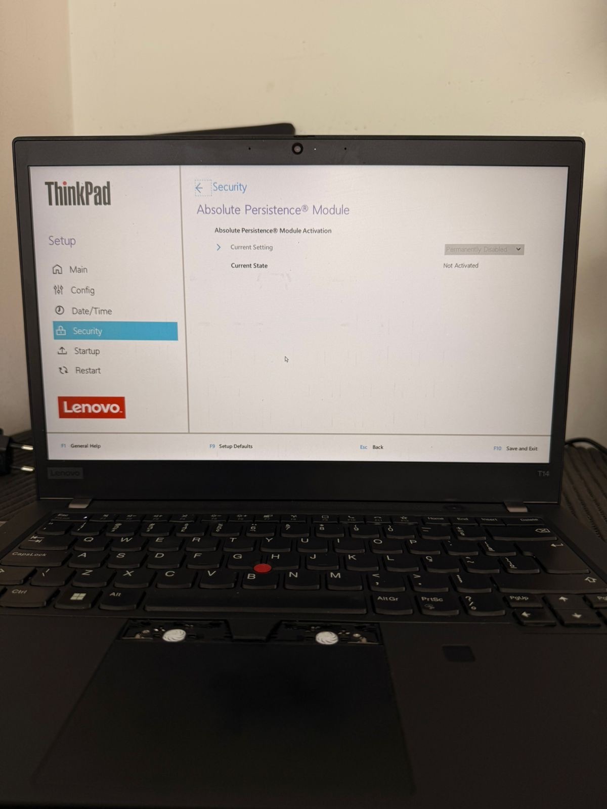

            Originally posted by santoslao
            After installing the second MEC chip, the machine turns on normally, but I had an unfortunate surprise! The chip sent by the vendor has a password to access the bios! I was deceived! I'm going to dispute on Aliexpress because these chips are not cheap. I'm very frustrated with this whole situation, I wasted hours and hours of my time to get to this point! I can't believe I waited for 14 days to receive 2 MEC chips with different defects. If the adm authorizes it, I'll post the link to this larápio's store here!
            This happened because the BIOS file was not replaced with a Clean DMI version. After using a Clean DMI BIOS file and replacing the MEC, the issue was resolved

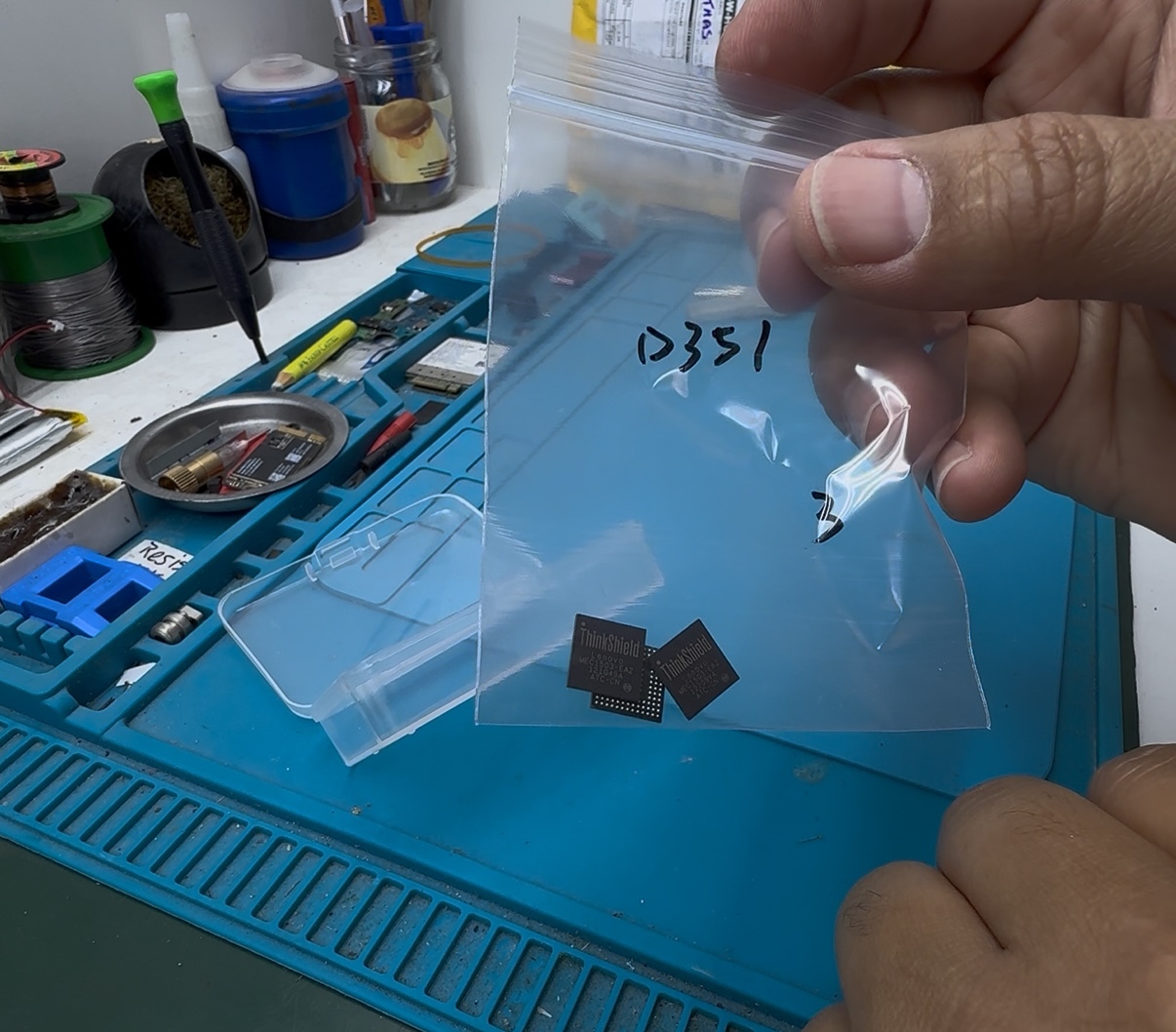

                I post here my experience in this saga of removing the password from this damn laptop!
                I bought again from another seller a pair of MEC1503 chips, after arriving I removed it from the same machine which I reported in this same post, and installed it, and the first chip when turning on the machine already gave me the option to enter the bios without asking for a password! Confirming so that you don't need to do anything that was said here, for example install dump with clean DMI! It worked perfectly!

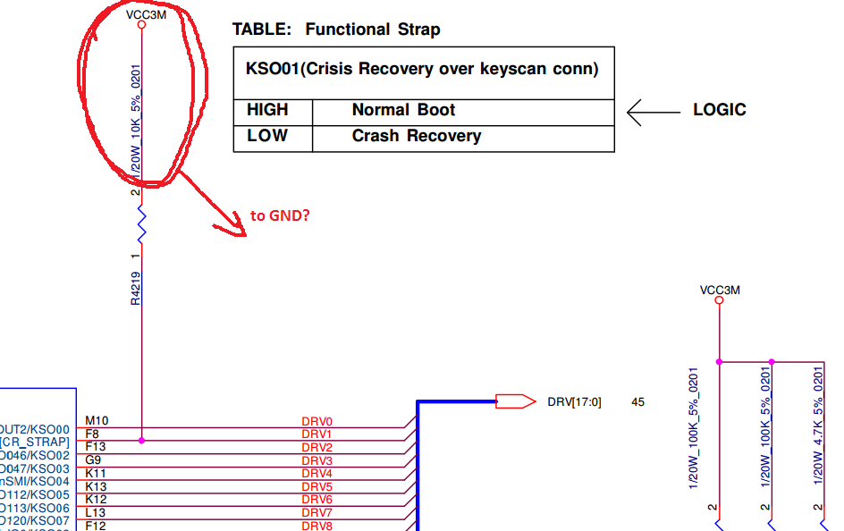

                        I checked your schematic, and here’s what I found regarding MEC1503 EEPROM/EC reset:
                        • The MEC1503 in your board boots from an external SPI flash (Winbond W25R256JVEIQ, 32 MB) . This is where the EC firmware/EEPROM contents are stored.
                        • There is a functional strap (GPIO045/KSO01 → CR_STRAP) that selects Normal Boot (HIGH) or Crash Recovery mode (LOW) .
                          • In Crash Recovery mode, the EC can reflash firmware via the keyscan connector or external programmer.
                        • There are also EC reset pins:
                          • -EC_RESET line
                          • GPIO061/ESPI_RESET#
                            These reset the MEC1503 logic but do not erase EEPROM; they just restart the EC.
                        • The EEPROM reset (clear NVRAM/firmware) is usually done by either:
                          1. Pulling the CR_STRAP pin LOW at power-up → forces crash recovery boot instead of normal firmware execution.
                          2. Reflashing the SPI flash (W25R256) with an external programmer.
                          3. Using EC crisis recovery over keyboard connector if supported by Lenovo’s firmware (KSO01 line is specifically marked as Crisis Recovery ).
                        🔑 So, to “reset” the MEC1503 EEPROM on this board, you don’t just toggle reset — you must either:
                        • Use the CR_STRAP pin (GPIO045/KSO01) in LOW state on startup to enter recovery mode, then reflash EC firmware.
                        • Or directly reprogram the external SPI flash (W25R256JVEIQ) with the correct image.
                        Would you like me to highlight the test point / resistor location of CR_STRAP and EC_RESET on the schematic so you can short it to ground for recovery?

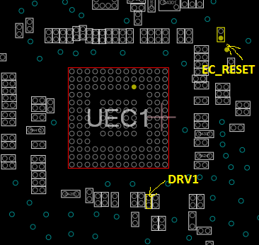

                            I found this points on NM-D352. So what I must do? Remove resistor 10k between signal DRV1 and VCC3M, and place it so, that DRV1 to GND?
                            EC_RESET also must be short to ground?
                            And after that how can I reflash EC? Via BIOS update in Windows? I have only Vertyanov JIG, but it have no compliance with MEC1503.
                            I also can reflash W25R256JVEIQ directly with programmator with the correct image. But I have no this correct image.

                                yeah, it doesn't work

                                  I can confirm that there is a solution to remove the password from this model! However, those who own it keep it under lock and key, and they won't sell it or exchange it for anything! They say it's a patch, just like on older models, but they only perform the service with the machine in person.
                                  Currently, the only solution is to replace the MEC1503 chip. I've already installed two T14 Gen 2s using this method. See my previous comments on this same post.​

                                          Now I noticed...
