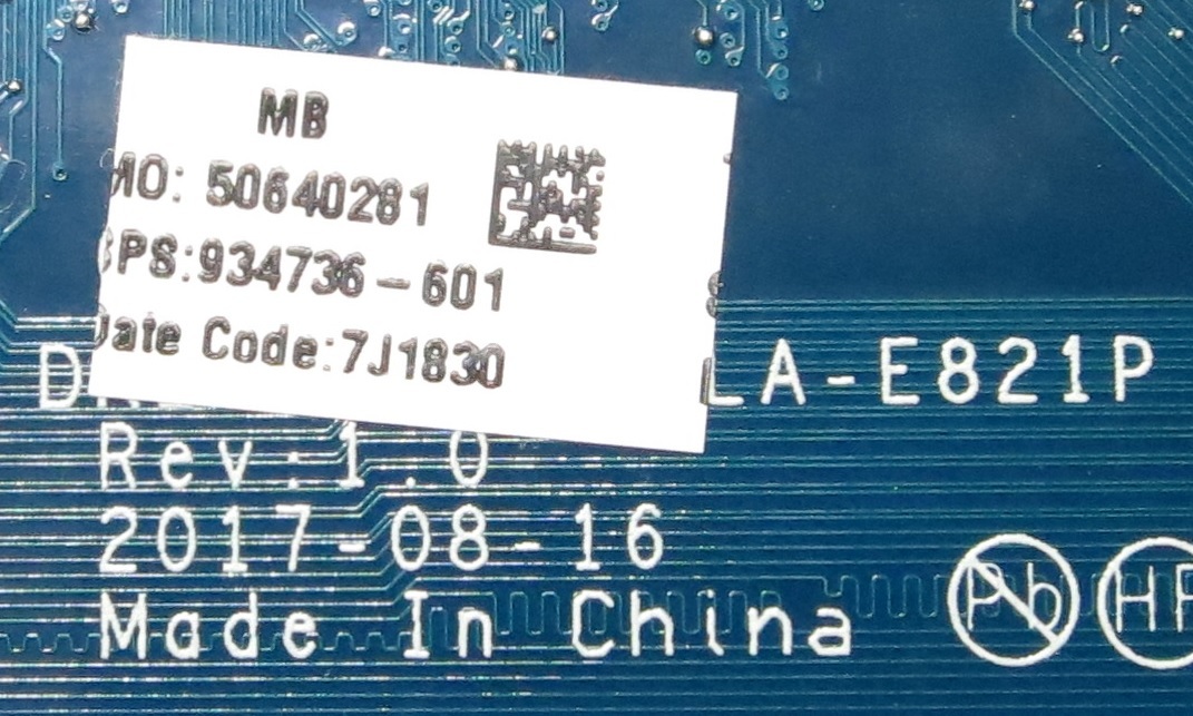

                                    Hello everyone!
                                    As some members have already reported, an official Windows 10 update also destroyed the BIOS of my HP250G6.
                                    I have read out the defective BIOS and now ask the forum members to correct the defective BIOS - if possible.
                                    HP 250 G6
                                    SN# CND8106CMR
                                    ProdID 3VJ6OES#ABD
                                    A photo of the motherboard label is attached.
                                    Thanks in advance.​
