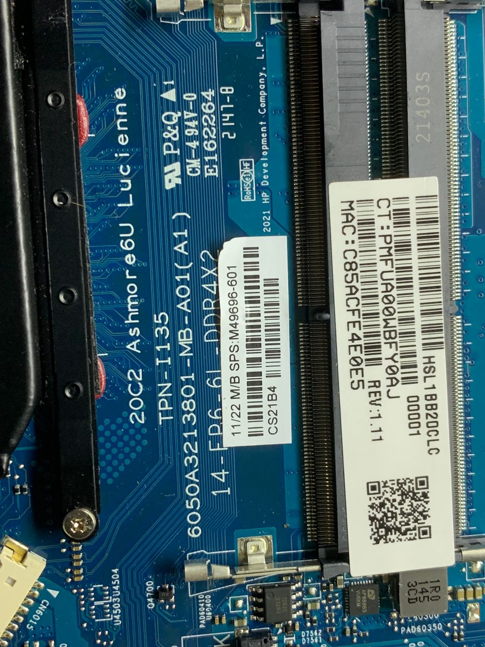

    need bios HP 245 G8 bios
    laptop no display issue....customer sent this laptop the other shop and i figure out they try to flash bios without remove bios ic from motherboard...
    board number :-
    6050A3213801-MB-A01

    Re: need bios HP 245 G8 (6050A3213801-MB-A01)
    board number :-
    6050A3213801-MB-A01
    The laptop serial number is 5CG1470YLG .Go to HP support,download and extract the bios update
    [Guide] How to find the right HP bios version to flash https://www.badcaps.net/forum/showthread.php?t=122195
    [Guide] How to extract ready for programming dump from HP update executable file https://www.badcaps.net/forum/showthread.php?t=121948
    Your BID number is BID08908
    Copy the DMI from the backup to the new bios with a hex editor, using these offsets
    414000 - 41503F and 436000 - 43603F

        HP 245 G8 Notebook PC (34Q11ES)
        There are 2 different bios updates at HP support, the first one is not yours as that is SSID 8908 ,and your bid is BID085B1. The second bios update "HP Notebook System BIOS Update (AMD Processors)" has your bios inside it.
        Click image for larger version  Name:	Two different bios versions.jpg Views:	0 Size:	24.7 KB ID:	3335349
        The bios can be extracted using the guides at post 2 ,run the exe first and if it gives you the option to save to a location do that, otherwise it will need extracting using AMIUCP. There are 3 different bios updates in the exe , @R00 ,@R01 and @R02 .Its @R02 that is BID085B1
        Your DMI. Copy it using a hex editor from your old bios to the new one
        DMI 283000 - 283FFF
        KEY 2A5000 - 2A503F
