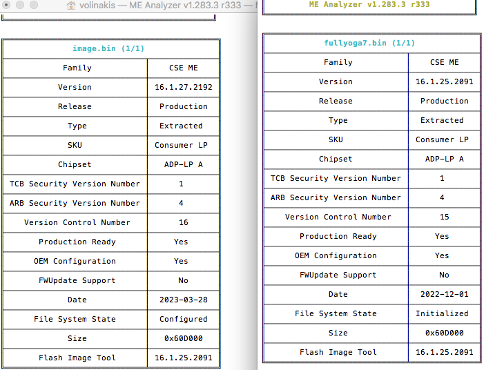

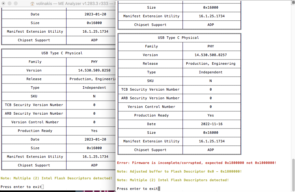

            Originally posted by EthanMai
            Unfortunately, it keeps rebooting with no picture.
            check soldering. Bios is a clean ME image. ME firmware is taken from bios update. Your bios backup had Error: Firmware is incomplete/corrupted, expected 0x1800000 not 0x1000000!

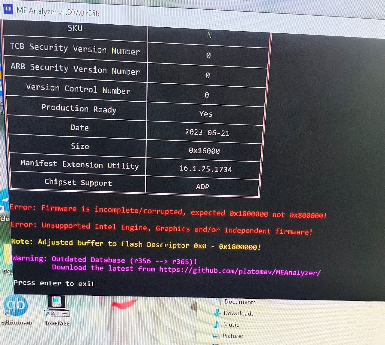

                                    also geting this problem in Me analyzer is it ok bios Me region??
