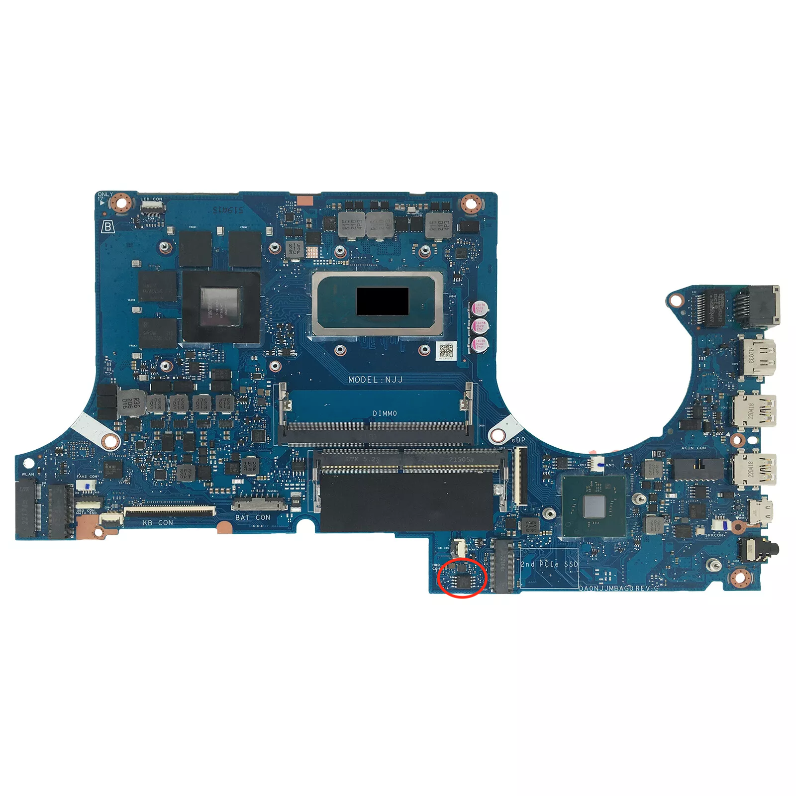

                      • volinakis
                        • Jan 2021
                        • 2701
                        • N/A
                        #31
                        Originally posted by bozdag
                        FX706HCB-HX152W SN:N1NRCX05P86703G
                        it died while updating the bios,the file seems corrupt
                        that's not bios chipset , see pic. Read it without ISP when you choose chipset in RT809
                        • bozdag
                          • 10
                          • nederland
                          #32
                          Thanks, it seems like the file is corrupt or I didn't quite understand it.
                          • shiyab
                            • Sep 2023
                            • 1307
                            • india
                            #33
                            hi try
                            • bozdag
                              • 10
                              • nederland
                              #34
                              Thank you, everything is fine and working normally
