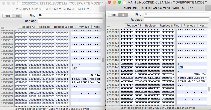

                                  i noticed there's a lot of unlock request for this model HP Probook 450 G9
                                  and patch won't work if the bios version is latest. use this bin flash both it won't work if you only flash the main you should flash both.
                                  first boot press f10 apply factory defaults and restart, 2nd boot reset security settings to defaults and exit.
                                  use BCU....
                                  can i use this to my HP Probook 450 G9? - yes.

                                      #100
                                      use BCU....
                                      your files maybe work for 450 G9 with U85 family bios, but there are also 450 G9 with U72 family bios, so I recommend users to check which bios family version they have. Also they have to write back MAC Adress and win key.
                                      Click image for larger version  Name:	Screen Shot 2025-03-12 at 16.03.15.png Views:	0 Size:	108.4 KB ID:	3591461
