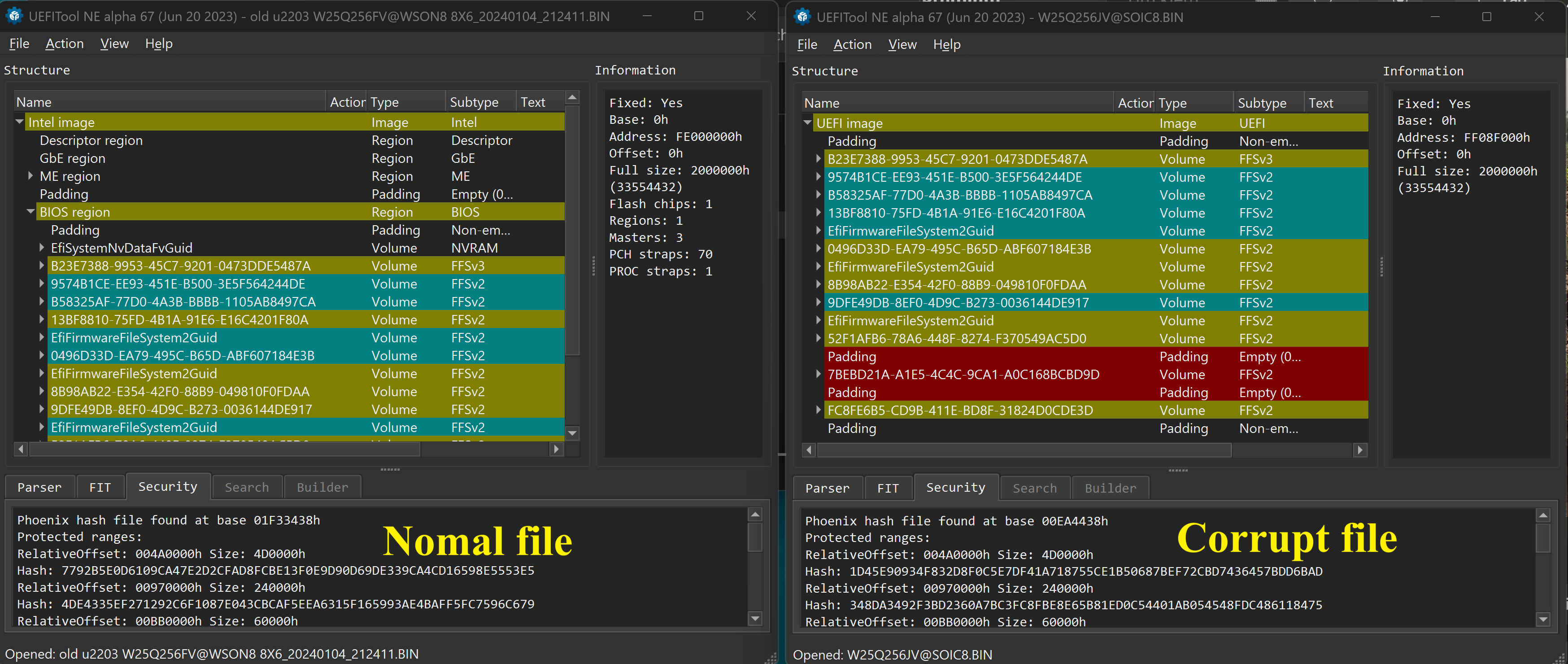

          Read chip again ,

            #45
            The BIOS is damaged, but the laptop turns on. If you install a new BIOS, the laptop will not turn on
            Apparently there's a serial number in the bios somewhere.
            Help me make a working bios out of the old and new file.

              I am completely sane when I ask you to re-read the bios chip, and I also understand that the bios file is corrupted. This error is caused by the programmer. So re-read the bios chip as requested.

                #47
                Sorry, there was a power surge and the laptop stopped working. It turns on, but there is no image, and there is no initialization. I counted the old bios and recorded a new one, it doesn't start at all and doesn't raise 20 volts. The old bios is flooded, it starts, but there is no image and initialization rises 20 volts. I understand that the old BIOS is damaged, but it has a section with a serial number.Without which the new bios does not work.What should I do with the new bios to make it work?
