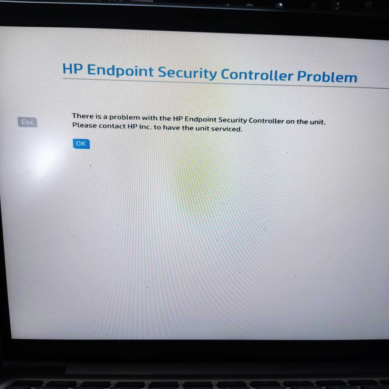

                      • ahmed100
                        • Mar 2023
                        • 41
                        • Maroc
                        #91
                        After i unlock password on my laptop HP Elitebook 840 G8 i find this problem : HP endpoint security controller problem tool
                        Description: HP EliteBook 840 G8 Notebook
                        Serial Number: 5CG1247GD4
                        Product Number: 358N6EA#UUW
                        please help​

                          CCC

                            Think you its working but with alert : system is booting in manifacturing Program Mode...
                            • trepachka
                              • Oct 2022
                              • 424
                              #94
                              Once in Windows, download BCU utility and run the executable file to generate a configuration file. Modify the file to make manufacturing mode to go away by changing asterisk from "*Unlocked" to "*Locked" and watch for any errors.
