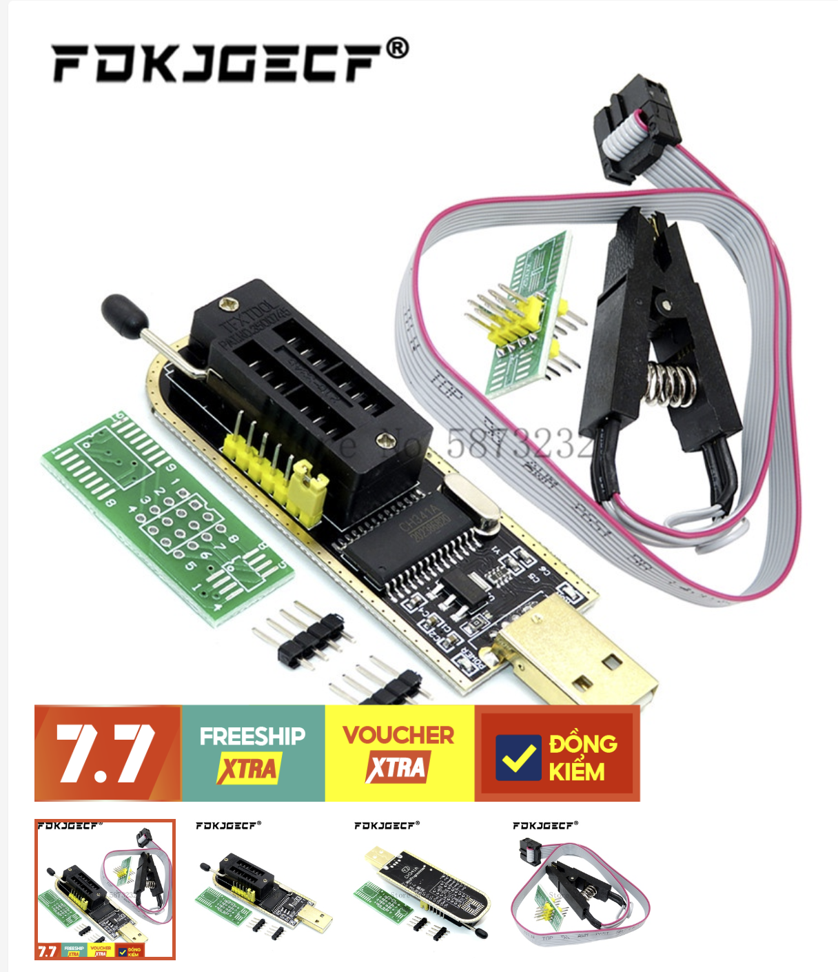

                How do I do this? I have the flash drive already ready already. I get to the press <Esc> or <Del> but and then it says "Entering Setup..." but nothing ever happens.
                • hoaca388
                  Badcaps
                  • Jan 2022
                  • 11727
                  You need a programmer.
Name:	2024-07-08 17_21_43-Bộ Mô Đun Lập Trình BIOS USB CH341A 24 25 Series EEPROM + Kẹp SOIC8 SOP8 EEPROM .png
                  https://www.youtube.com/results?search_query=ch341a
