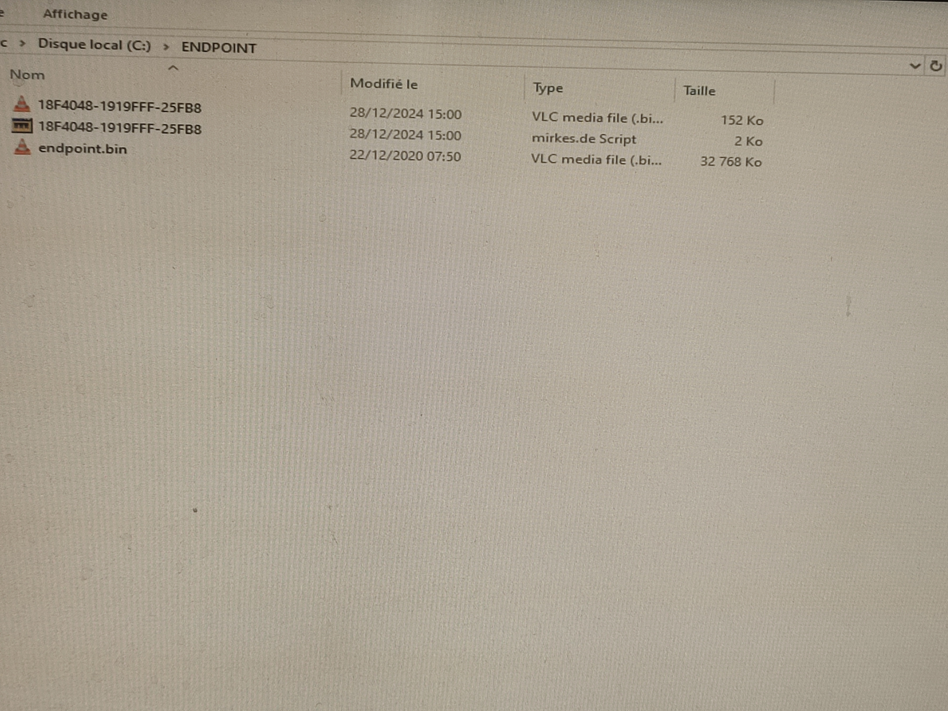

          Please help me with endpoint security controller problem
          HP Elitebook 840 G6
          SN : 5CG9442CPM
          Product ID :4WG30AV
          Thanks​

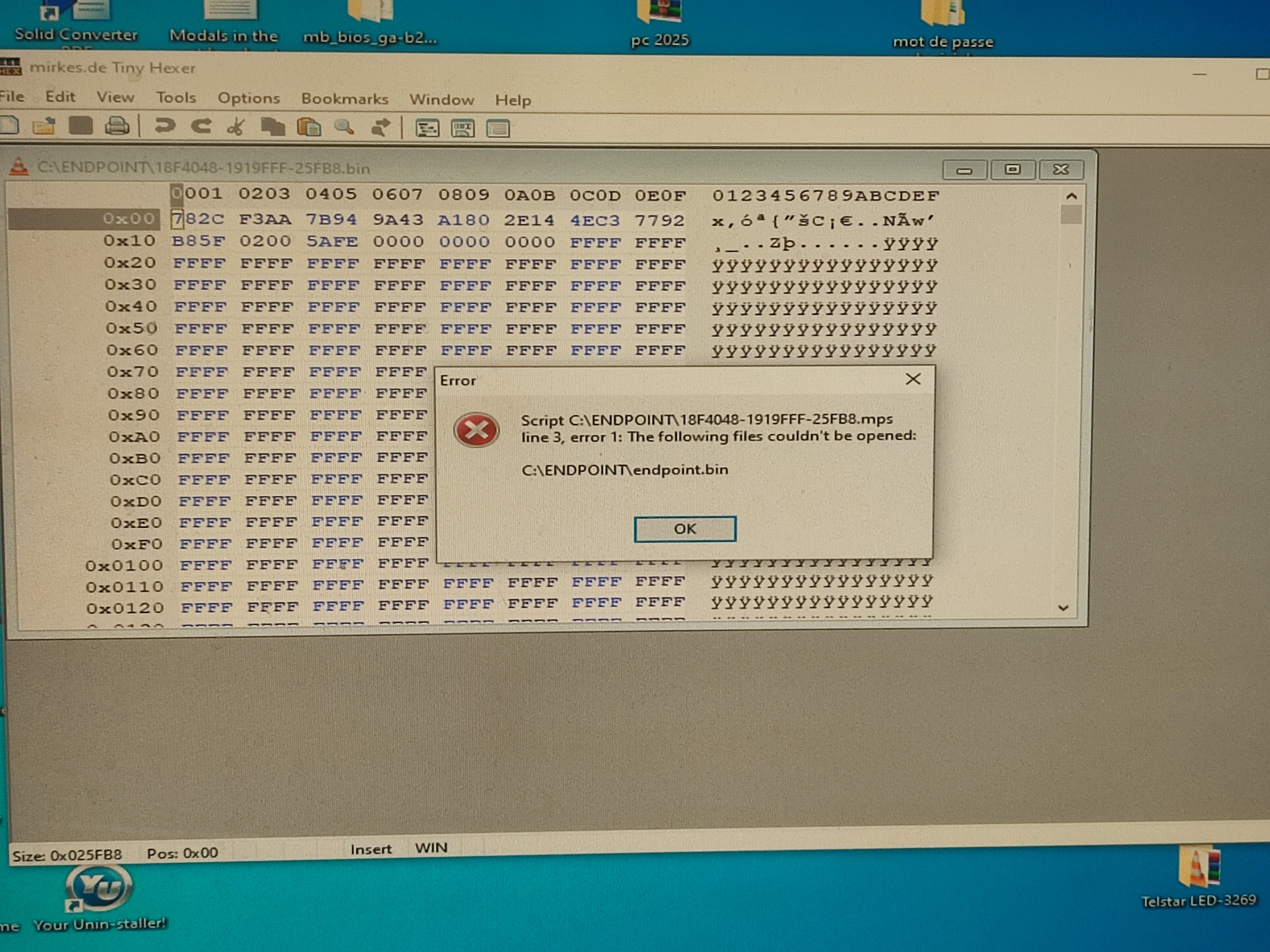

          thank you very much my brother SMDFlea
          for sharing information. I followed the instructions but it gives me the following message:​
            SMDFlea commented
            Editing a comment
            The error was probably because you had a double file extension endpoint.bin.bin .By default windows hides known file extensions, you can disabe that setting in folder options
