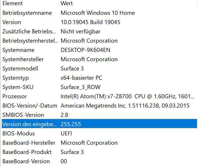

    Hey guys, i have a surface 3 with a bios password which i cannot remember.
    I tried to dump the current bios with fptw64.exe thats what it says
    C:\Users\Admin\Desktop\bios>fptw64.exe -bios -d surface.bin
    Code:
    Intel (R) Flash Programming Tool. Version: 9.5.40.1868
    Copyright (c) 2007 - 2014, Intel Corporation. All rights reserved.
    Error 201: [FPTw64.exe] cannot be run on the current platform.
    Please contact your vendor.
    I dont know how to continue.. am grateful for help!

                    Re: Surface 3 BIOS dump for BIOS PW
                    You used the wrong software. You would need to try ME95, ME11 and TXE2 windows versions. I don't know what "surface 3" exactly means in your case so... Just try all of them.
                    • SevenBIOS
                      • Mar 2023
                      • 11
                      I tried to Backup bios with Universal Bios Backup tool since i couldnt manage to do it with the other ones..
                      I hope it has the right stuff in it!
                        Thats the Surface I use
                          Look at your machine. There's model information written there. Some 4 digit code for example?
                          • SevenBIOS
                            • Mar 2023
                            • 11
                            Yes it says Model 1657
                            • RethoricalCheese
                              • Mar 2013
                              • 1519
                              • Estonia
                              So TXE2 I think.. Did you try that?
                              Are you trying it in windows or windows installation media?
                              If the first, are you running cmd as admin?
