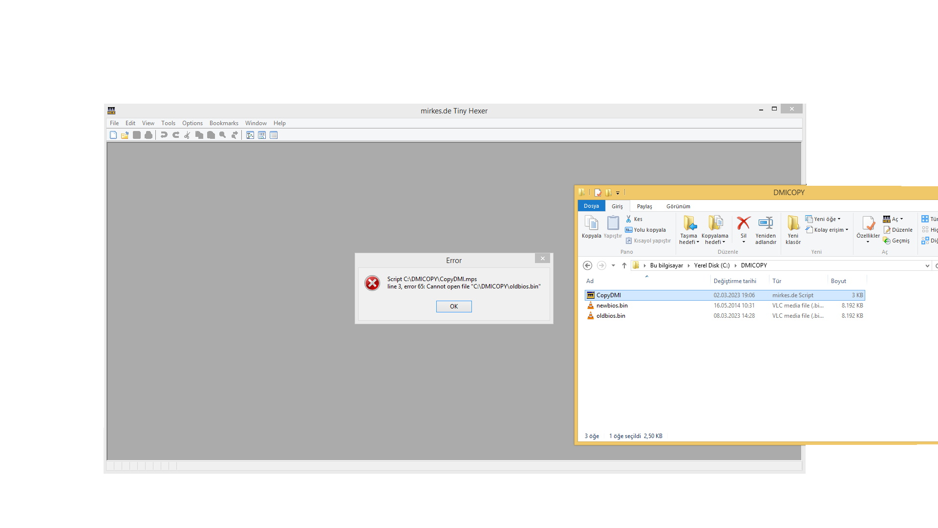

        Re: hp 15-cw0010na bios
        Originally posted by SMDFlea
        If you can`t use a hex editor you can still add the DMI yourself using this guide https://www.badcaps.net/forum/showthread.php?t=116311 .
        Follow the Easy guide and use the attached script.
        Hi, it's giving an error. Could you help

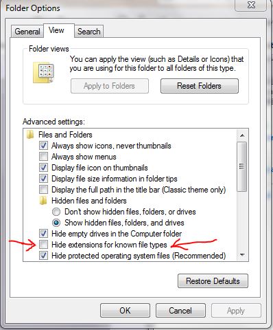

          Did you use the script from post #3 .Did you check your backup to make sure its good ? ,post it here
          Edit: I think you could have a double file extension,can you check your windows (explorer) Folder options, look for a setting called "Hide extensions for known file types" and untick it. oldbios.bin should only have .bin ,let me know if its something else after .bin
            Thanks, problem fixed.
              • 21145
              what was the problem
              • ay_bulut
                • Feb 2016
                • 114
                • turkey
