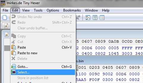

    Experienced .How to make a macro script
    1. Follow steps 1 to 2 in the Easy guide .
    2. Copy the two attached bios files into the DMICOPY folder
    3. Start Tiny Hexer and click on Tools -> Macro -> Record script
    4. Open both bios with Tiny Hexer
    5. Click on the oldbios.bin tab or window to bring it to the front,then it will be selected as the file we are working with first
    6. Click on Edit -> select
    The DMI and Key is at these offsets DMI 520000 - 5207FF , Key 62D000 - 62D03F but we need to add 0x0 to the addresses in the Set selection boxes .There are other ways to make the selection but for now use this method
    7. Copy 0x0520000 into Seletion start and 0x05207FF into selection end ,then click on OK
    8. Click on the newbios.bin tab and make the same start and end selections
    9. Click back to the oldbios.bin tab and select the Copy to clipboard button,click back on the newbios.bin tab,select the Paste clipboard contents button.
    10. Click back to the oldbios.bin tab and make a new selection (step 6) with 0x062D000 and 0x062D03F and follow steps 8 and 9 again
    11. Click on the save button,then Tools -> Macro -> Stop recording
    12. A window should pop up to save the script,name the file CopyDMI.mps and save it to the DMICOPY folder
    You can check that the DMI has been added to newbios.bin using Tiny Hexer or other hex editor software,if there are any problems delete the file,rename the backup file with the bak extension to newbios.bin and try it all again.
    If you want to run the macro script to make sure it works then delete newbios.bin and rename the backup file with the bak extension to newbios.bin first

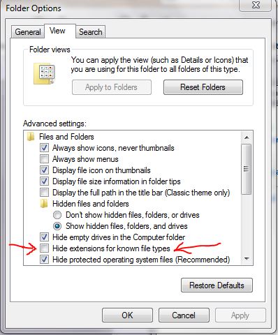

    Edit: One problem has been reported so far,caused by a windows default setting for file extensions -> https://www.badcaps.net/forum/showthread.php?t=116372 .Change the setting for Hide Extensions for Known File Types in explorer folder options, untick it.
