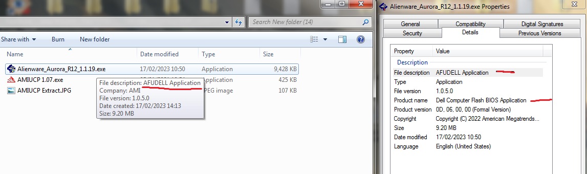

    Click image for larger version  Name:	1. AFUDELL Application.jpg Views:	1480 Size:	102.3 KB ID:	3156269
    To extract,first we need to use AMIUCP.Select the @R00 file ,select the extract button under the functions and select where to save the file.You can save it as Rom.bin or any other name .When you click on Apply it will be saved to the location you chose.

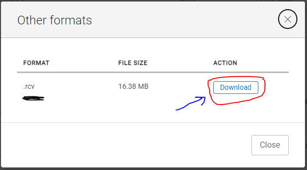

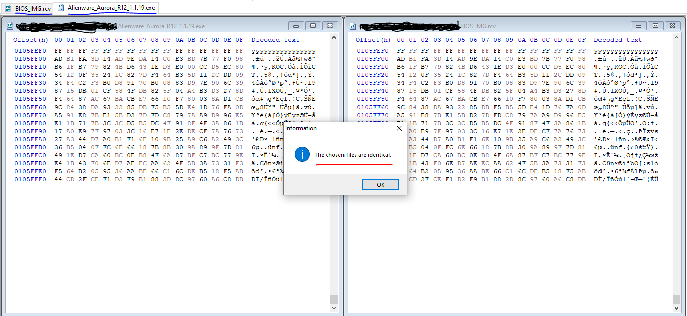

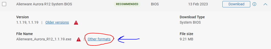

      I deal with that type of files in a bit different way, perhaps it could be useful for someone else.
      When I can't extract the .exe file using PFS, I go and see if there are other formats such as (.rcv), I download it and that let me skip the steps for (AMIUCP), just work on (AMIPFAT).
      I don't know if the .rcv format is provided always or not.

        When i can't extract the .exe file using pfs, i go and see if there are other formats such as (.rcv), i download it and that let me skip the steps for (amiucp), just work on (amipfat).
        i don't know if the .rcv format is provided always or not.
        not alwasy but maximum time they provoide that .crv file under exe
        i am using that too but few models crv file is not extractable
