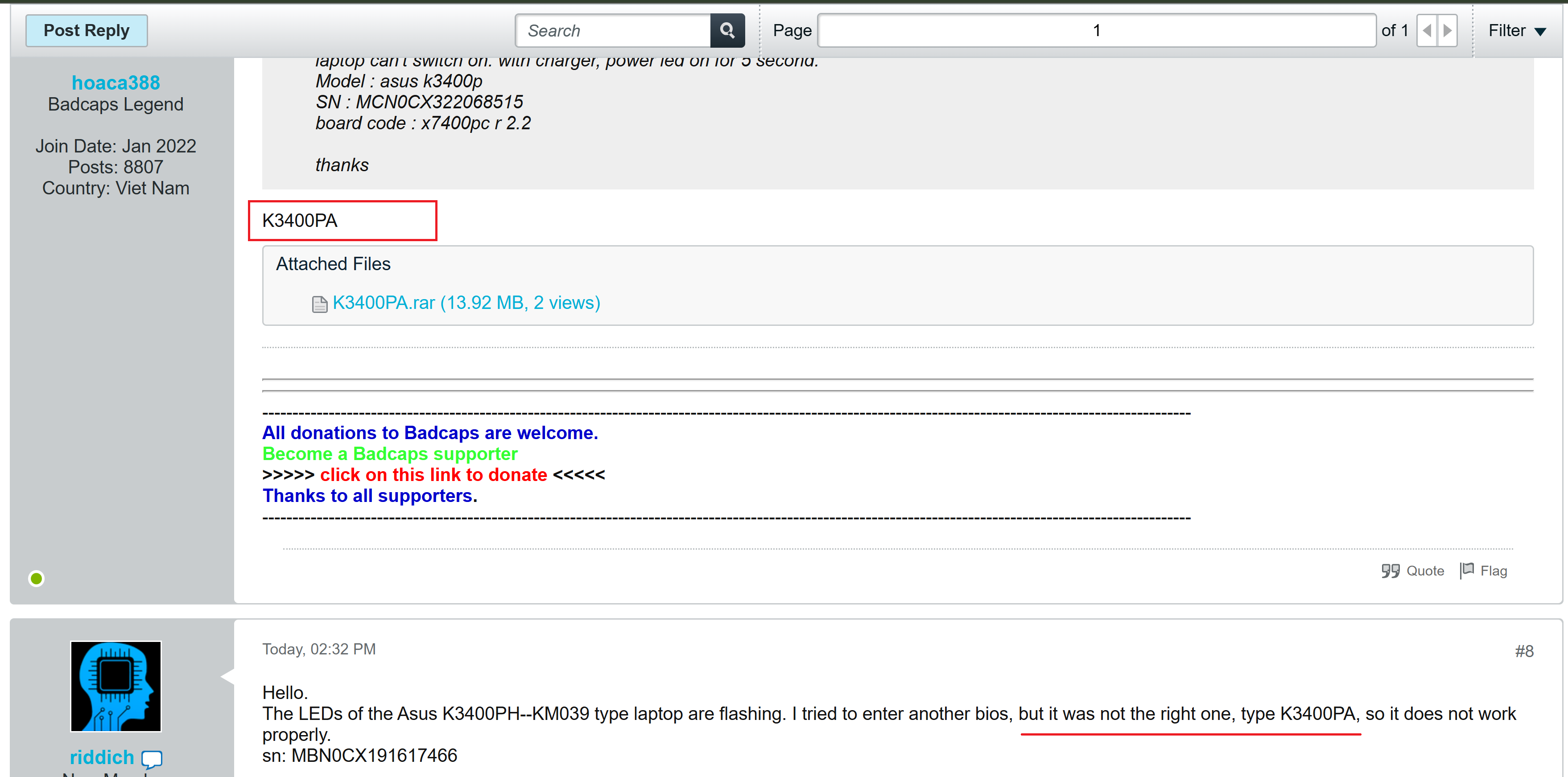

              Hello.
              The LEDs of the Asus K3400PH--KM039 type laptop are flashing. I tried to enter another bios, but it was not the right one, type K3400PA, so it does not work properly.
              sn: MBN0CX191617466​
              Original bios:
              Please help. Thx

                Originally posted by riddich
                Hello.
                Original bios:
                Please help. Thx
                See Click image for larger version
Name:	2024-12-09 15_59_18-Settings.png
                • riddich
                  • May 2023
                  • 3
                  • Hungary
                  My laptop is PH not PA
                    • 21946
                    post the motherboard model number and a picture of the square white QR code
                      But the serial number says it is PA, do you have a sticker on the ram slot or QR CODE to confirm it is PH ?

                        Here is your new BIOS file depending on your Serial Number and your original backup.
                        Try it and let me know.
                        all donations are welcome,
                        • riddich
                          • May 2023
                          • 3
                          • Hungary
                          You are the best !!!!!! It's working

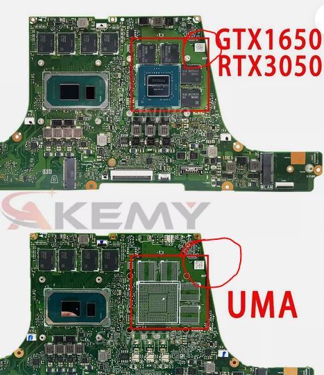

                              Asus k3400p
                              x7400pc r2.2
                              s.n m9n0cx03u911361
                              The device is working but there is no reading of the Nvidia graphics card and the fans are spinning quickly and it shuts down. Please help.

                              • 21946
                              Originally posted by fredo
                              Asus k3400p
                              x7400pc r2.2
                              s.n m9n0cx03u911361
                              Post a picture of the QR code https://www.badcaps.net/forum/troubl...30#post3524430
